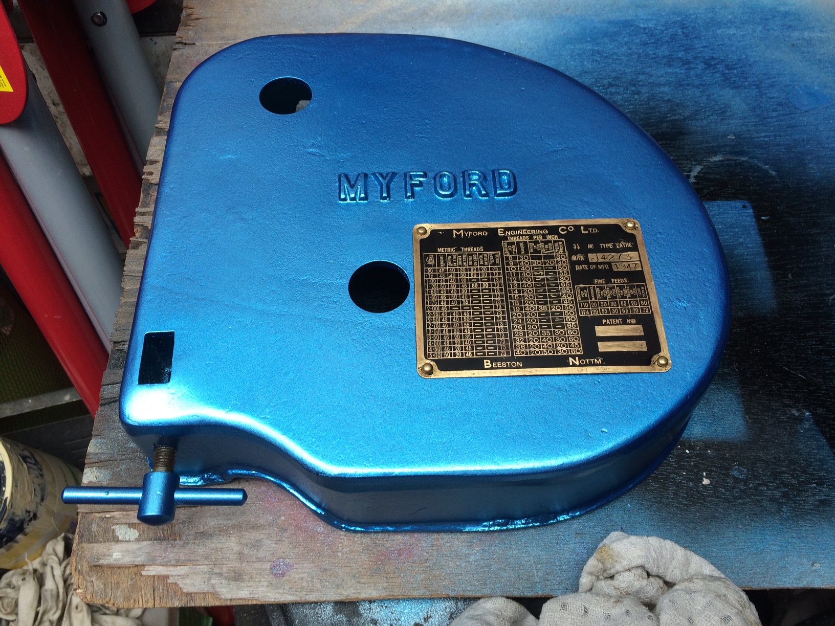

I've had varying degrees of success with FeCl3 and transfers. I work on copper PCBs, chunks of copper and cast aluminium enclosures (geetar pedals).

I've used 1oz and 2oz PCBs, 5mm thick copper, 2mm thick aluminium and loads of other random stuff. I'd say a sheet of copper or brass would be my first material to try Pete but as long as it's "soft" so the acid eats it quickly enough then you should get success.
I believe @cardiffrob used a similar method to do the etching on his Alta head.
I can shallow engrave a plate leaving the letters high, takes a while though.
