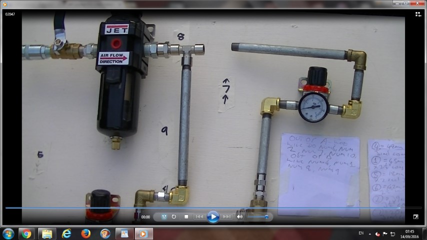

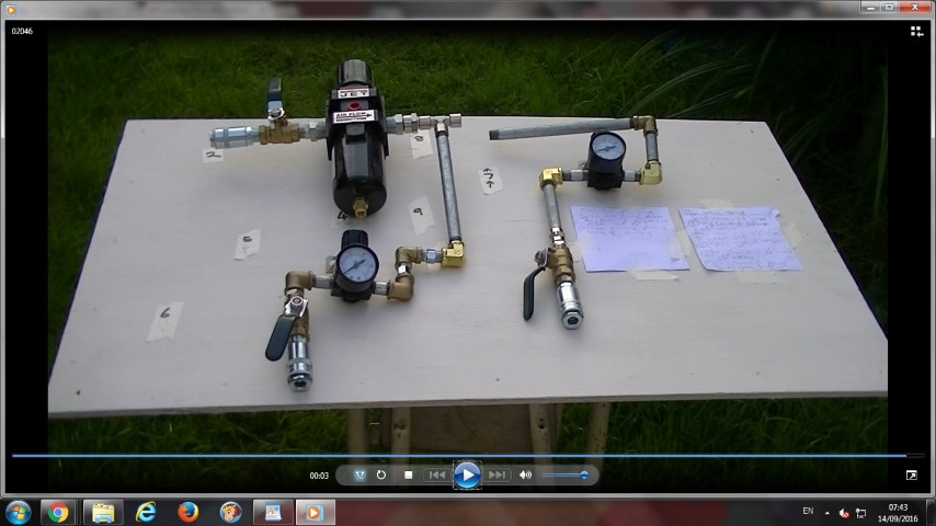

The fittings etc are going to be raised up on wooden blocks so all the pipes and fittings line up, equal distance from the backing wall board.
The problem I'm thinking I might encounter is. To tighten up all the fittings airtight, the pipes and joints will be all askew not lining up equal distance from wall board, all clean and tidy. I think I read that Loctite 572 didn't have to be done up really tight to get an airtight seal. So using the Loctite allows me a certain amount of maneuvering to line the pipes and fittings well. I'm only using low air pressures around 5 psi, yes 5 psi.
I had thought of using yellow gas grade ptfe tape but I think I would encounter the same problem tightening and lining up.
Any advice welcome.
