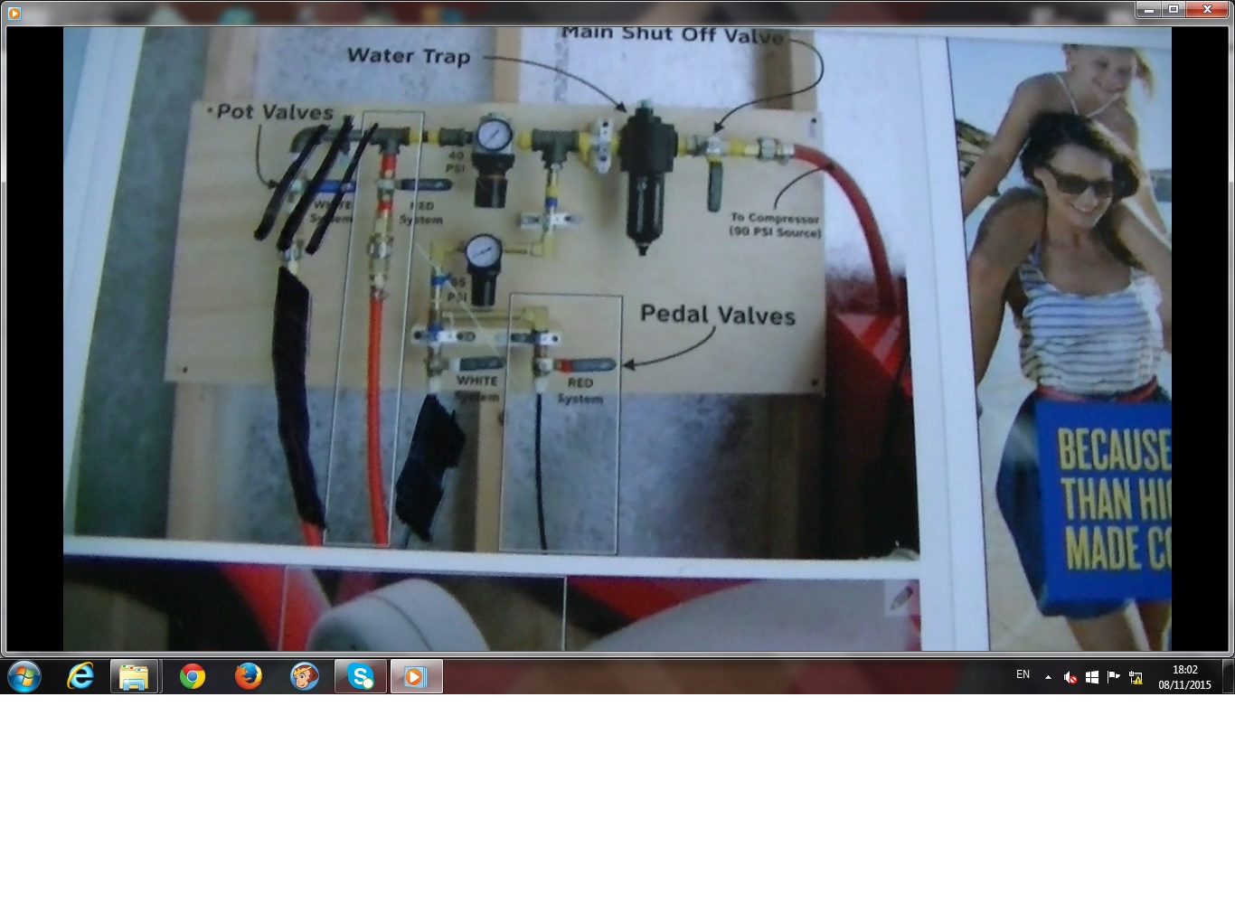

why so meany compact 90 fittings ? and they are running downhill from what i guess in the main air line.
last air plumbing i did, i T'ed out of the air main with the T pointing uphill, and bent a copper U bend to bring my outlet down the wall. then the inline pressure regulators like you have tweek the gadgue so you can mount them with the air inlet and outlet vertical. withe the gadue still the right way up and the adjustmet knob stick out hrizontal, it should work out that turning the knob up = more pressure, down = less. so should be fully ocd compliant, less joints = less chance of leack, less restiction and less cost.
