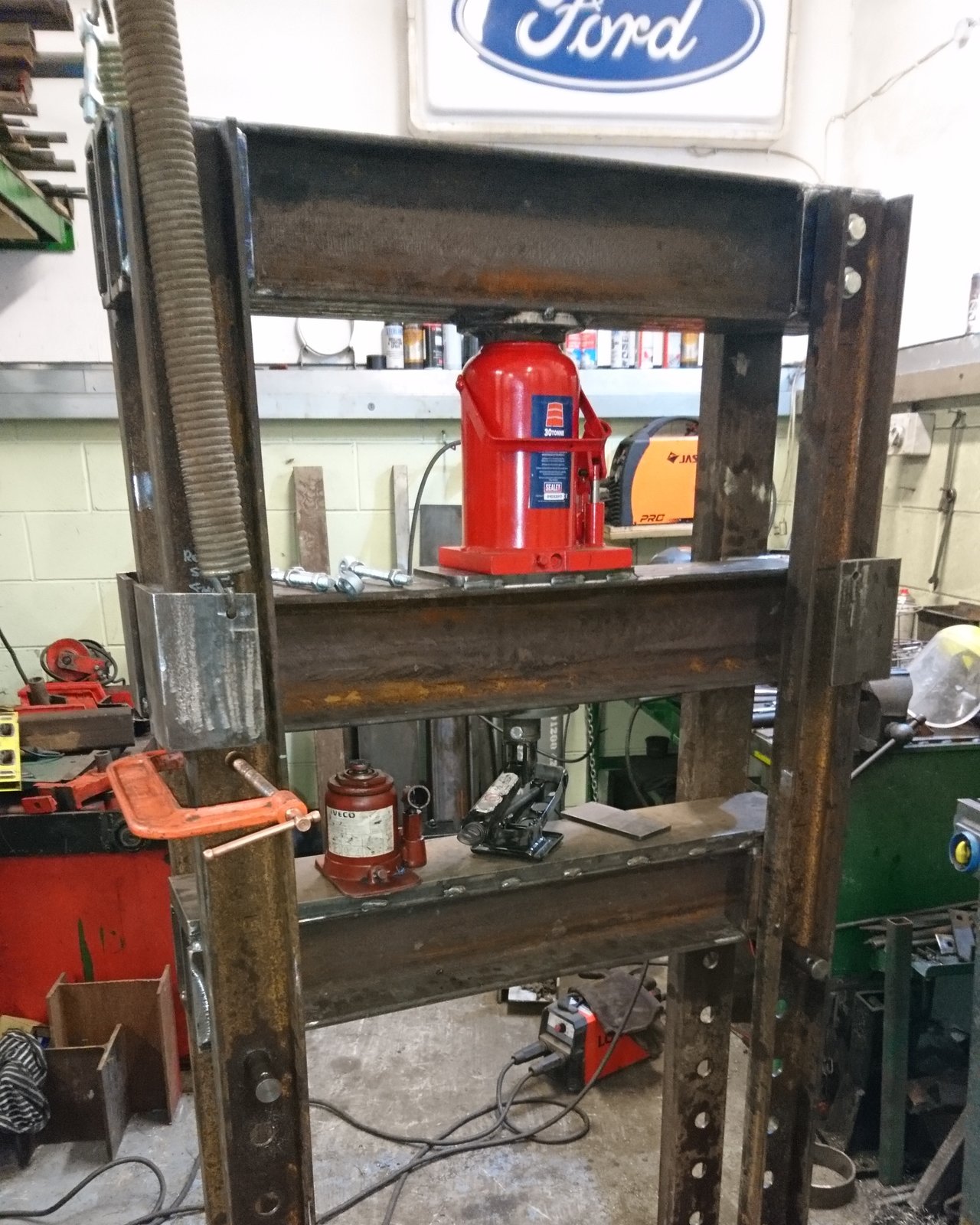

pressbrake1 Forum Supporter Messages 5,483 Location Essex Jan 31, 2019 #21 ub's don't like load situations where twist moments can be induced hence the haunching you see on beam ends and load nodes
