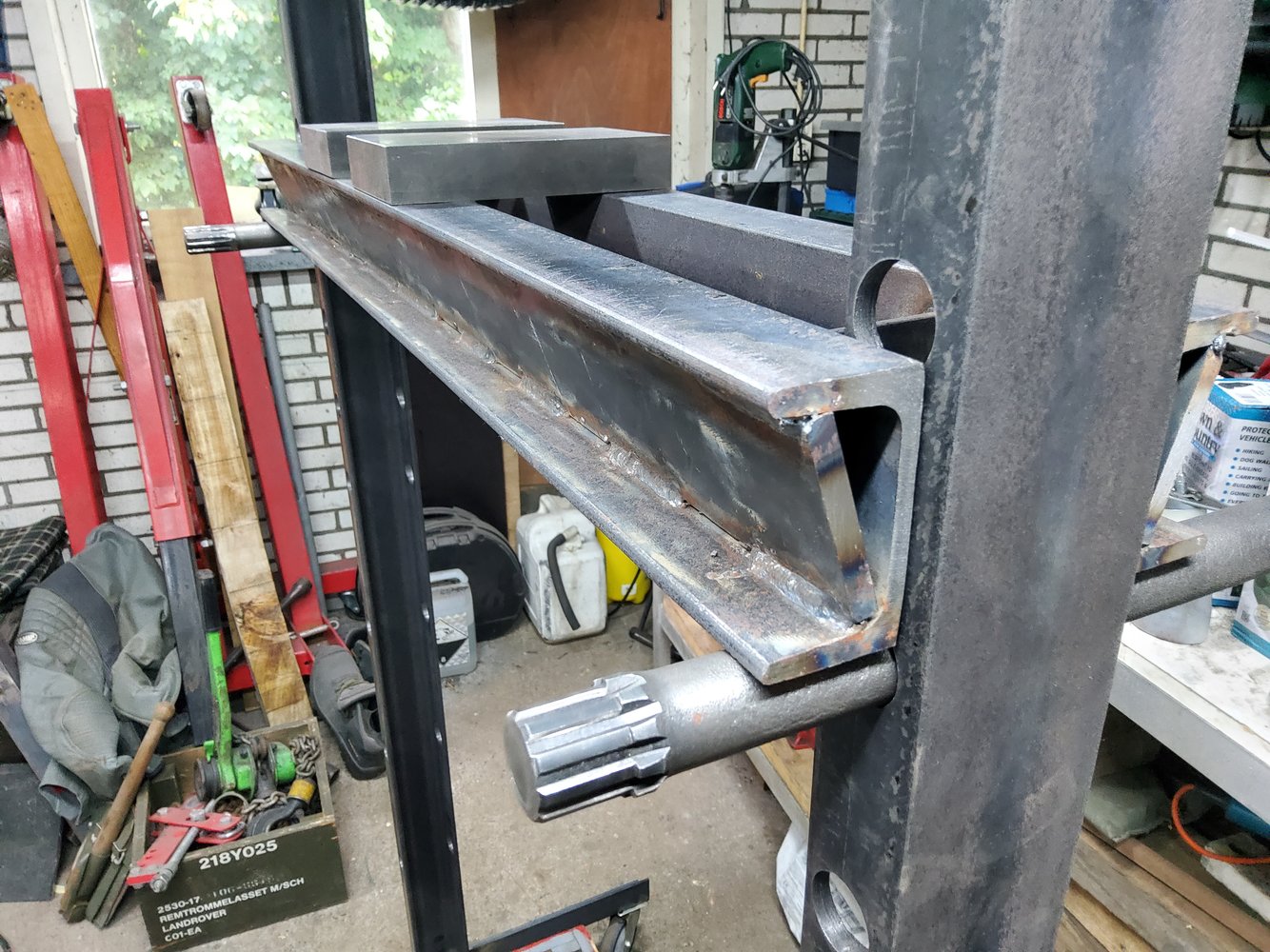

The box section I have is rounded on the corners, and thinner wall. Virtually every press I've seen has channel supports or very deep, very heavy plate.

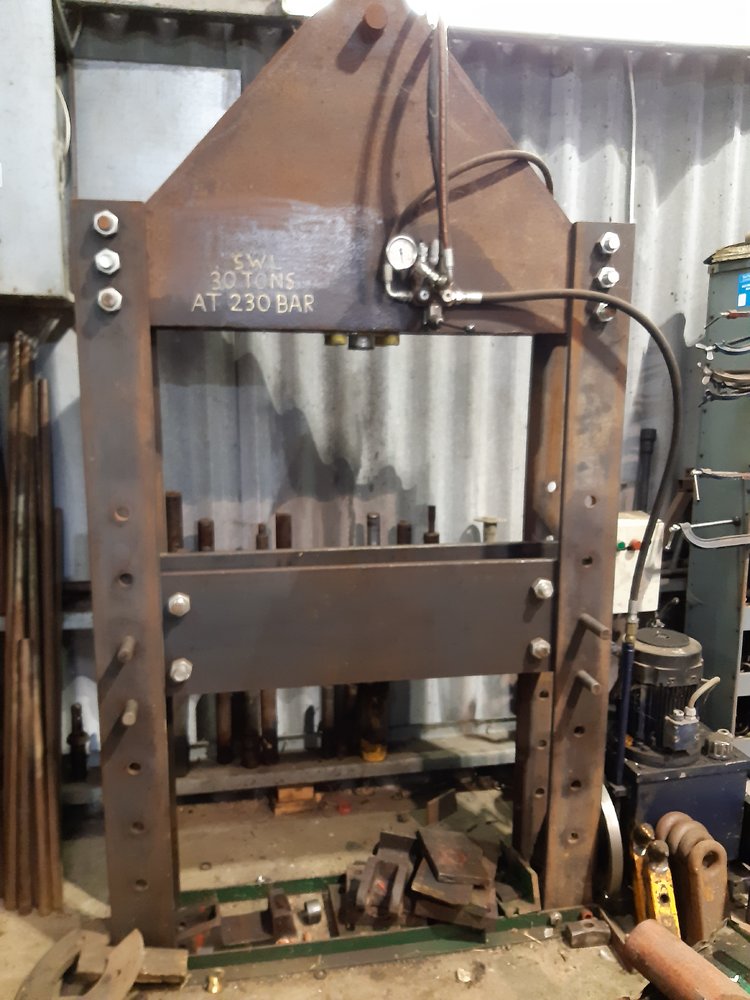

What mess??here's a photo of my effort...
it's 25 ton Tangye and has just 25mm black round bar...plenty of times the jack has gone overload relief.....

All the 20 ton presses I've looked at use 4" channel, not as heavy as I'm using and un braced. I'm using heavier channel and bracing it with plate as I have some, and, as I've said, I tend to over engineer things.Understood but if you are going to MODIFY a channel section, that looks like the worst case scenario. Look at where the forces you’re trying to resist are going to end up. Pivoting along a weld join….
I have had the steel for 3 years to build a large press but no longer get the time.All the 20 ton presses I've looked at use 4" channel, not as heavy as I'm using and un braced. I'm using heavier channel and bracing it with plate as I have some, and, as I've said, I tend to over engineer things.

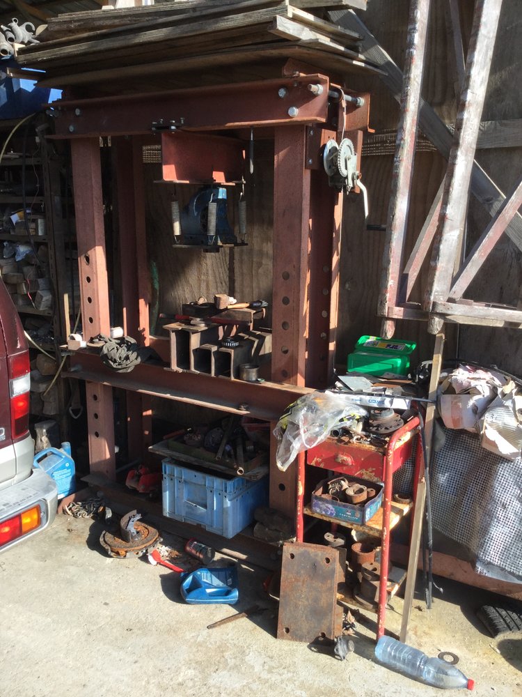

Bob that video still makes me feel all fuzzy I must get round to making one!I used channel and 2" plate to spread the load. Works well.
Home made press
I made this hydraulic press about twenty years ago out of channel and a few second hand hydraulic bits lying about, its been in a storage container for a few years getting rusty and gathering dust so I am cleaning it up and painting it. It will fold 15mm thick plate @ 90 degrees, I dont know the...www.mig-welding.co.uk

Is that an RSJ?I've noticed, on the verticals, some have the web inside and some outside...
I can see your point. Maybe the brace could introduce a twisting force if at an angle. I will consider placing it vertically to effectively make it a box section, something to think about!Appreciate that and I assume a suitably specced channel would be sufficient on its own. Depending on the design and fixing, I merely suggest that sort of bracing could conceivably make things worse.
I am not making any criticism of anyone’s work here, just looking at a pic of a bracket with a brace that doesn’t look right to me.
But are they mild steel? Do you use your press at maximum all the time? Is the press in continuous use? Can one guarantee that the load will be spread across all four pins evenly? If it is home-made, perhaps more metal is a better choice over a computerised design with minimum overload capacity.Just been out to check my Sealy 15T press and it has 19mm pins and they are still dead straight after many years...hope this helps
If I were building it, inside every time. Not everything you press will be a regular shape and it's nice to have a face to block the part off to stop it flying.I've noticed, on the verticals, some have the web inside and some outside...
