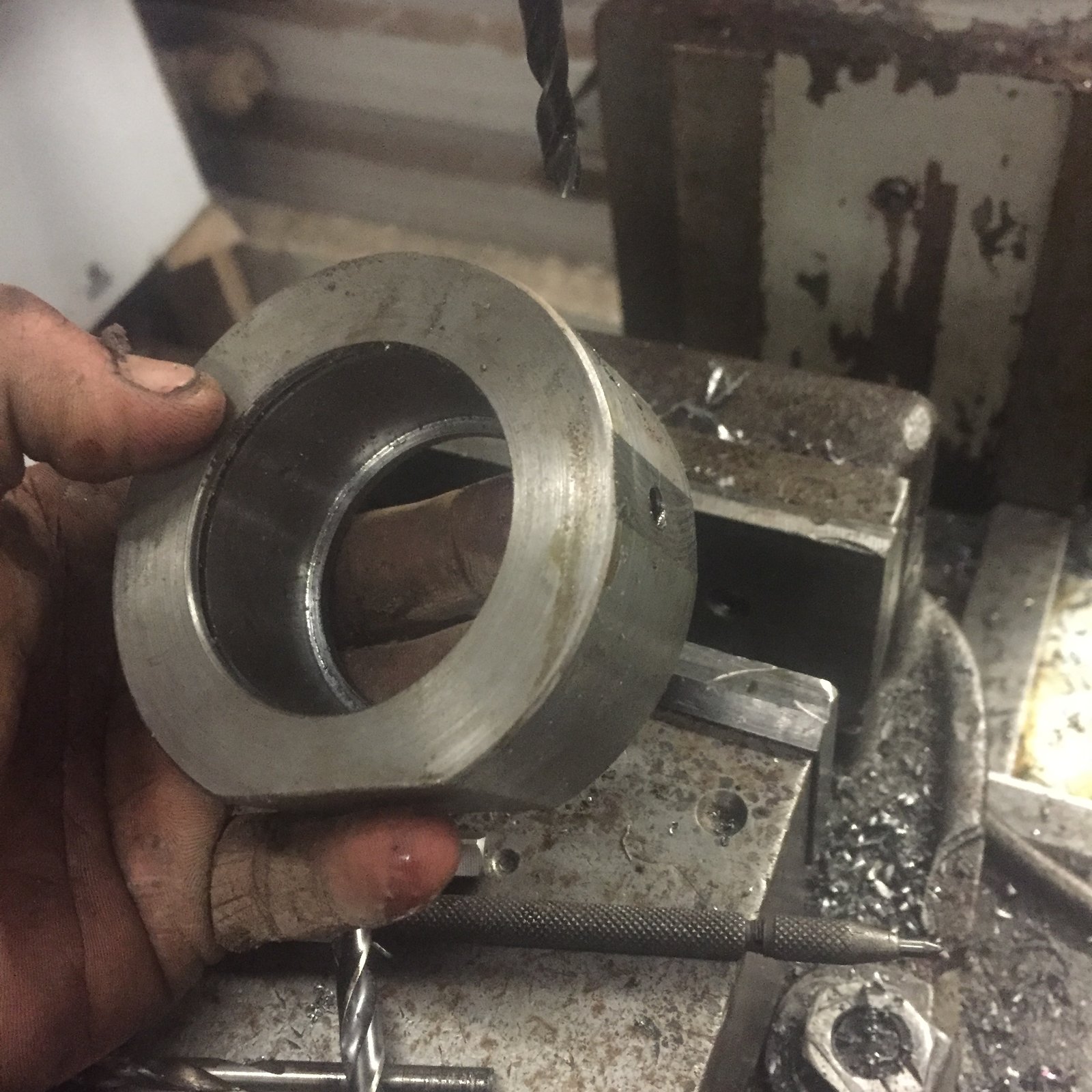

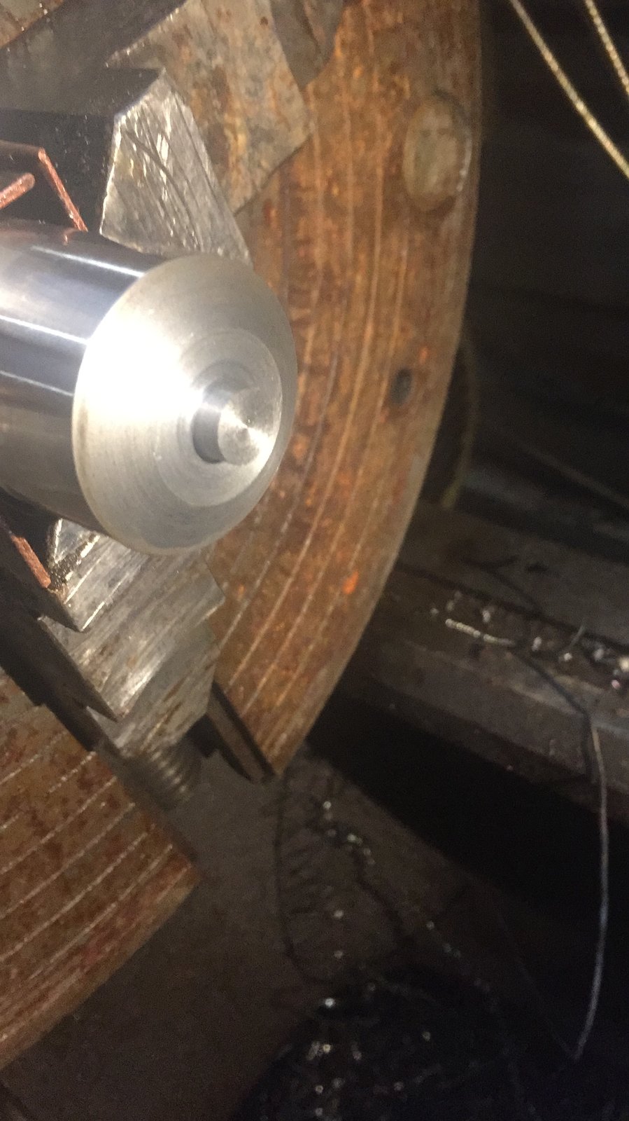

you dont have to replace, just re-chroming them works perfectly well , I have repaired loads of rams and some with imperial seals that were obsolete by chroming up and going to the next size up, but in metric style seals, that might mean re machining the gland bush etc but that is no problem there is usually enough meat in them to successfully repair most rams back to like new at a fraction of the cost.
