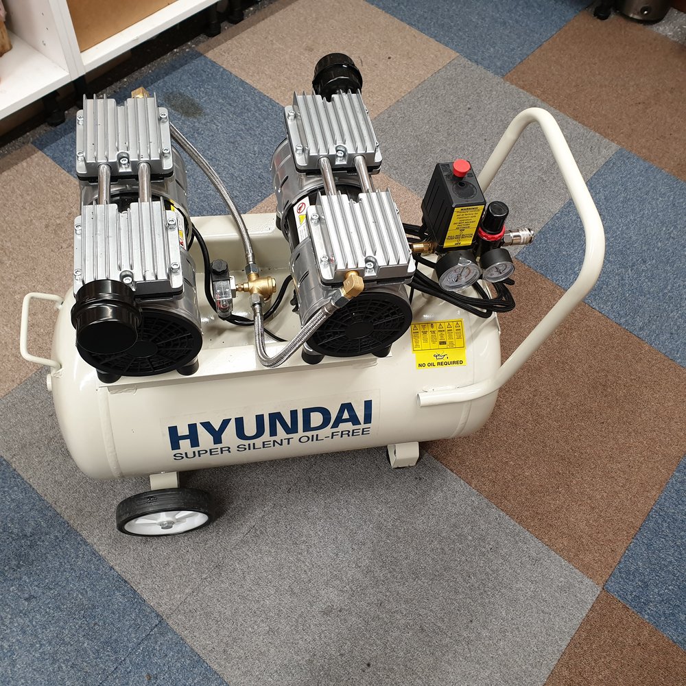

I work in my garage out the back after work I stop all grinding at 9 and stop welding at 10 I know they're expensive but if it's not as loud as a 4 inch grinder enough that'll do, the larger capacity one means it shouldn't be running as oftenI sold my piston compressors and bought one as I moved from a semi rural location to a built up area. The noise from the old compressors was just too much.
The Hyundai means I can use it at any time without worrying about getting an ASBO.
They are very expensive given their air delivery though.
Don’t understand the no oil bit, surely it needs some sort of lube?I got one several months ago. Two pumps working in parallel, each with two pistons in parallel. Single stage. Quiet enough to easily have a conversation next to it.
Found the cable was too short, so first job was a rewire.

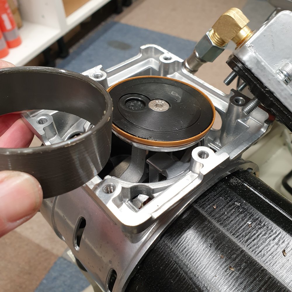

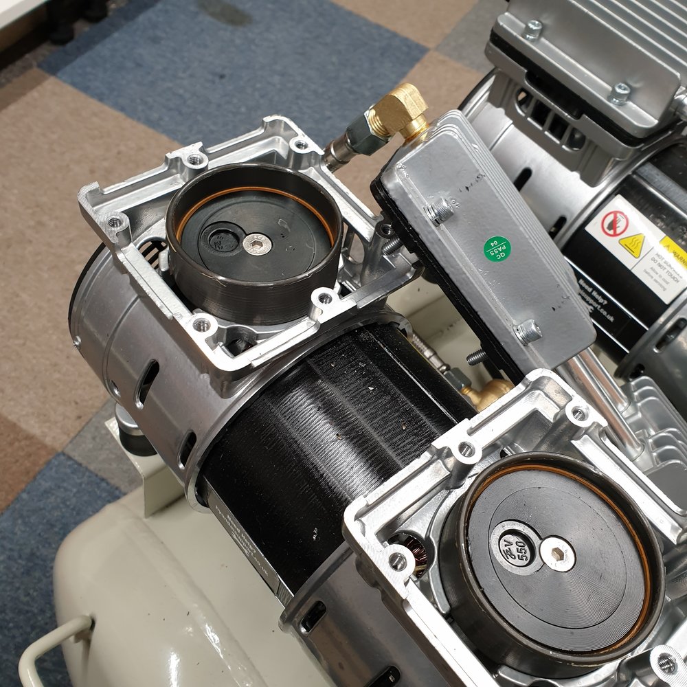

Pistons are not maintainable, so once seal is gone, will need a new piston.
Would recommend.

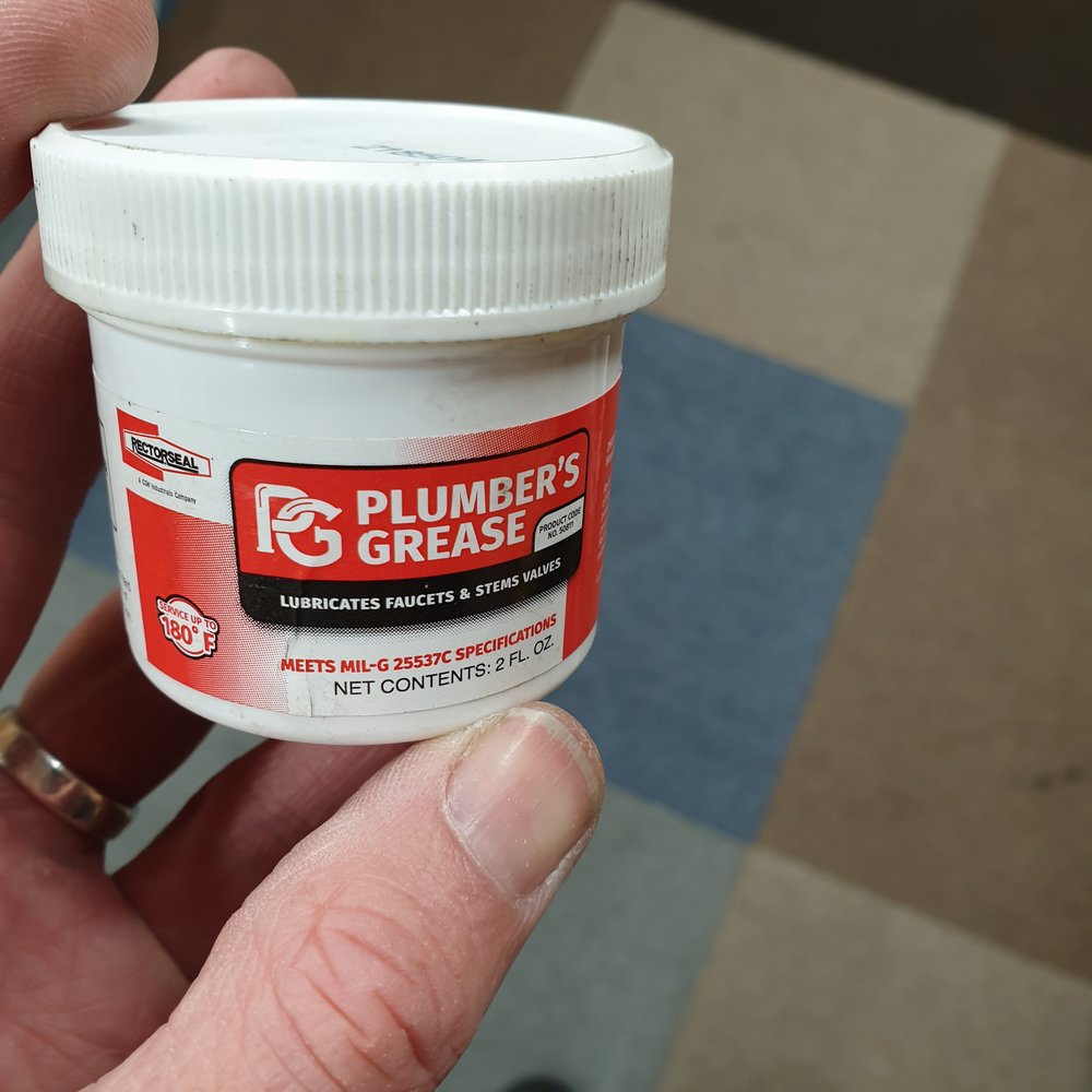

What did you lube them with? Not worried about the impact to the seal or barrel?
