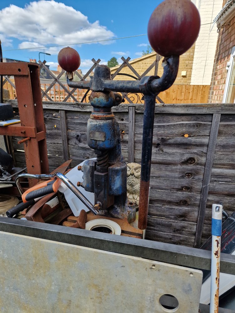

I'd love one if I had the space.I know I keep banging on about it but a flypress with a half inch(non centred) punch is the perfect solution. Better than hitting things with hammers though you could use a flypress/arbor press to operate such a tool.
Why would you do that? Because a flypress is a fantastically versatile tool for all sorts of metalworking.

Agreed- and dare I say a big old fly press could probably live outside under a cover if space is an issue- suitably covered in oil or something and a tarpaulinThey look plasma cut to me. That ragged edge will drive you nuts if you try to smooth it.
Flypress will punch a perfect round in less than a second. Couple of dozen might take a couple of minutes with most of the time spent placing the material under the punch.
…ok I was trying to ease him in gently…Under cover, you say?
