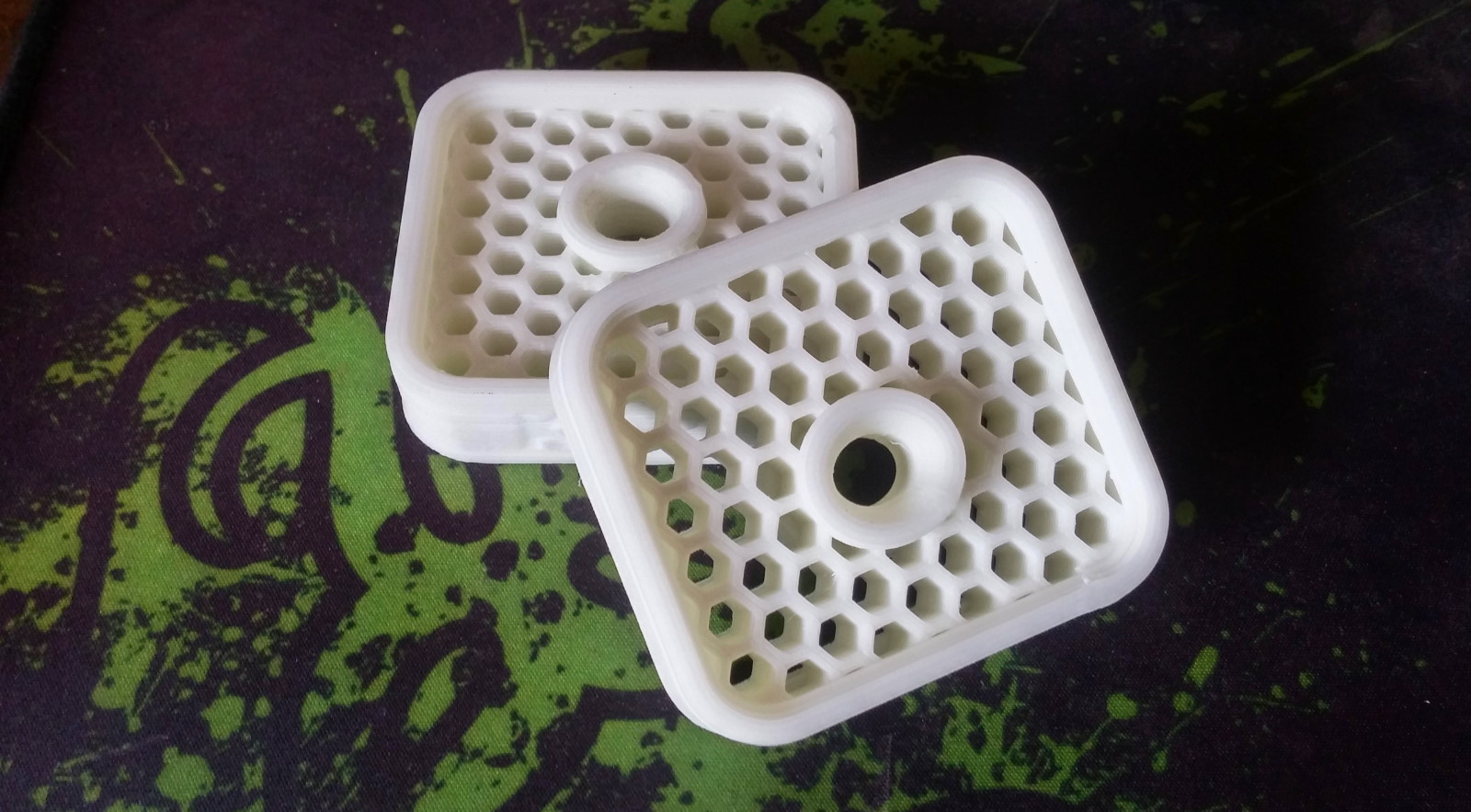

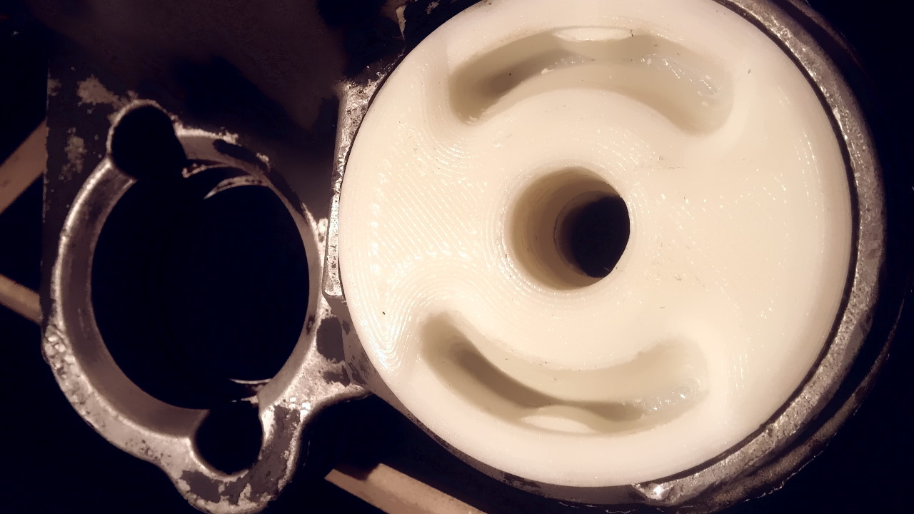

These were both done with 1mm wide extrusions, more than high enough quality for their intended use:
(edit - as some were talking about it, larger extrusions are generally stronger as you have less stress risers and the interbond temperature is kept higher from the higher thermal mass)
