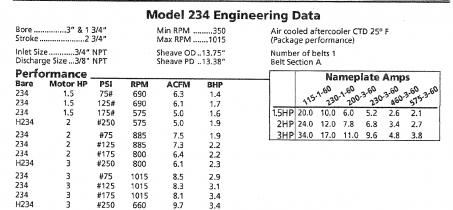

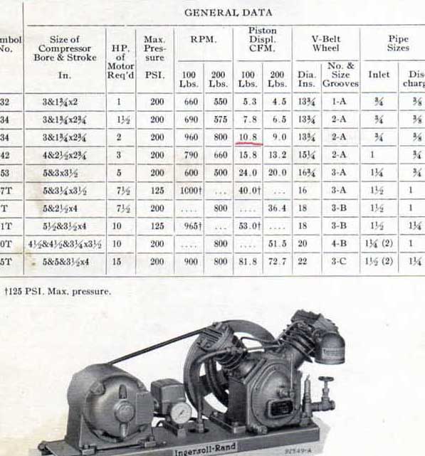

Useful info (not that I fully understand it all). I think it suggests that a 234 with 1ph motor should be about 10cfm?Couple of charts on the Ingersoll compressors that I downloaded from the internet, may have been this forum . Hope whoever uploaded doesn't mind.
View attachment 327675 View attachment 327676
Yes, 145psi is 10bar (well close enough).Useful info (not that I fully understand it all). I think it suggests that a 234 with 1ph motor should be about 10cfm?
