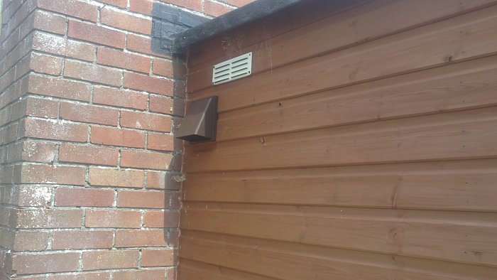

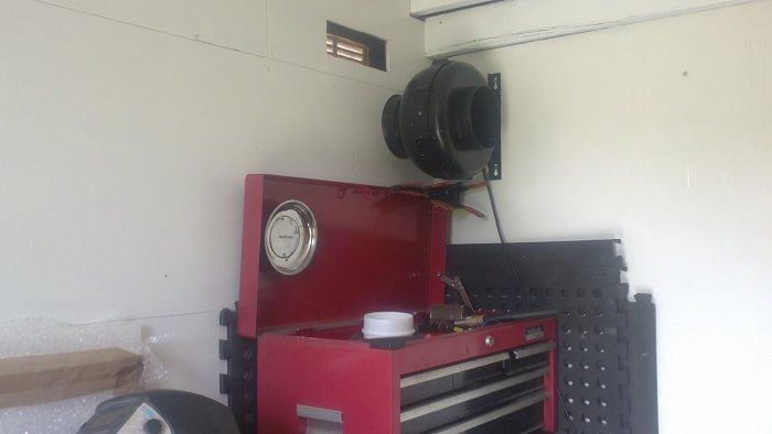

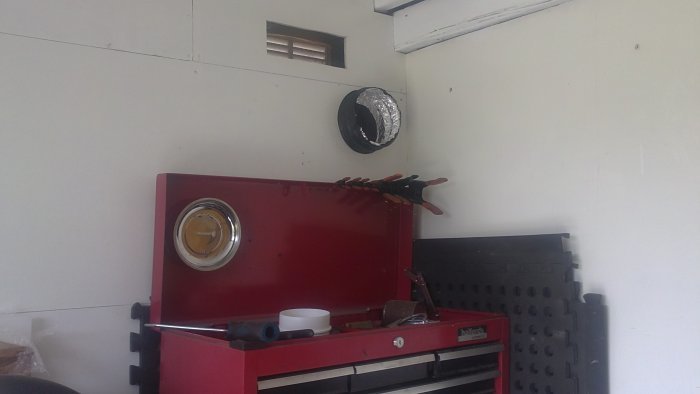

Just thought I would share mmy step-by-step progress of installing my extraction in my little 'man cave'.
The 6inch outlet

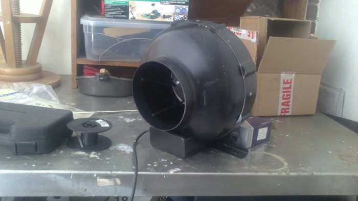

My 6inch fan bought from evilbay for £30
Fan mounted

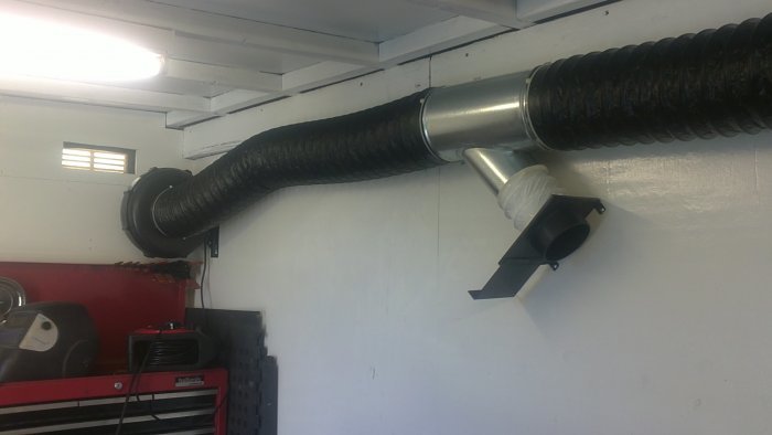

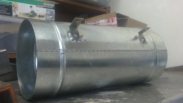

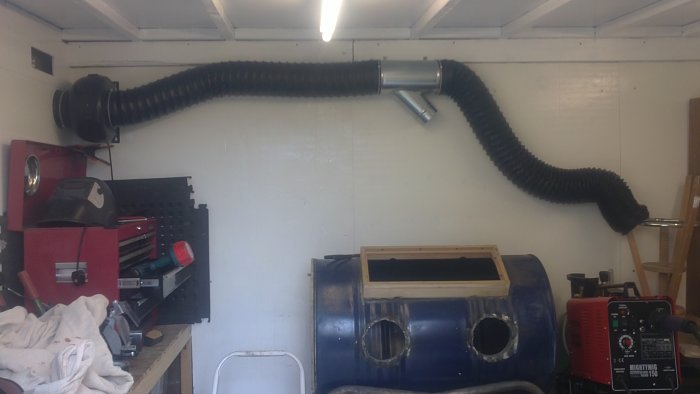

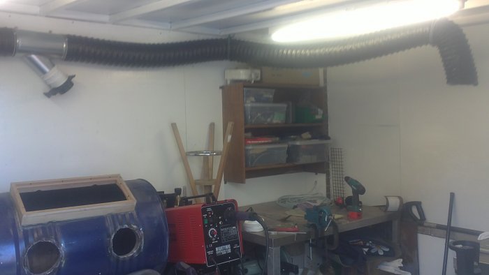

I bought a 6inch to 4inch 'Y' junction splitter for connecting my blast cabinet to the system. I plug/spot welded a couple brackets to mount it to the wall.
'Y' junction mounted.

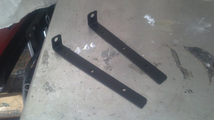

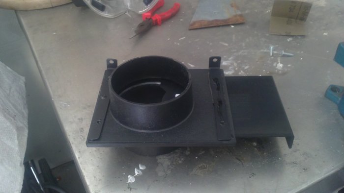

I made up some brackets and sprayed them black for mounting the 4inch gate to the wall. The gate is closed off when the blaster is not in use.

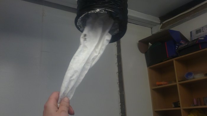

Simply glued the brackets onto the gate.
It sucks better than ............
