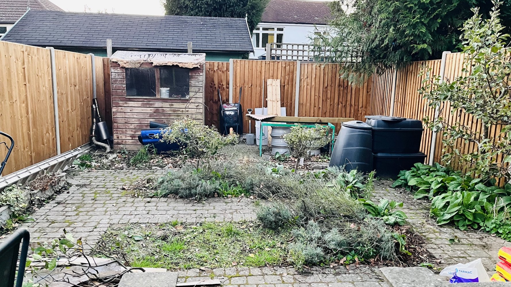

Anyway, I have a space of about 6.4 (width) and 6'ish length where I want to build a reasonable workshop. The walls will probably be double skinned breeze blocks (maybe with render or fake wood cement cladding), with sound absorbing insulation in between the skins.
I will build it slightly smaller than the available size, because I want to be able to fix issues around the building, so probably leaving 0.4-0.5m per side (left, right, back), so internal floor area will definitely be < 30m2.

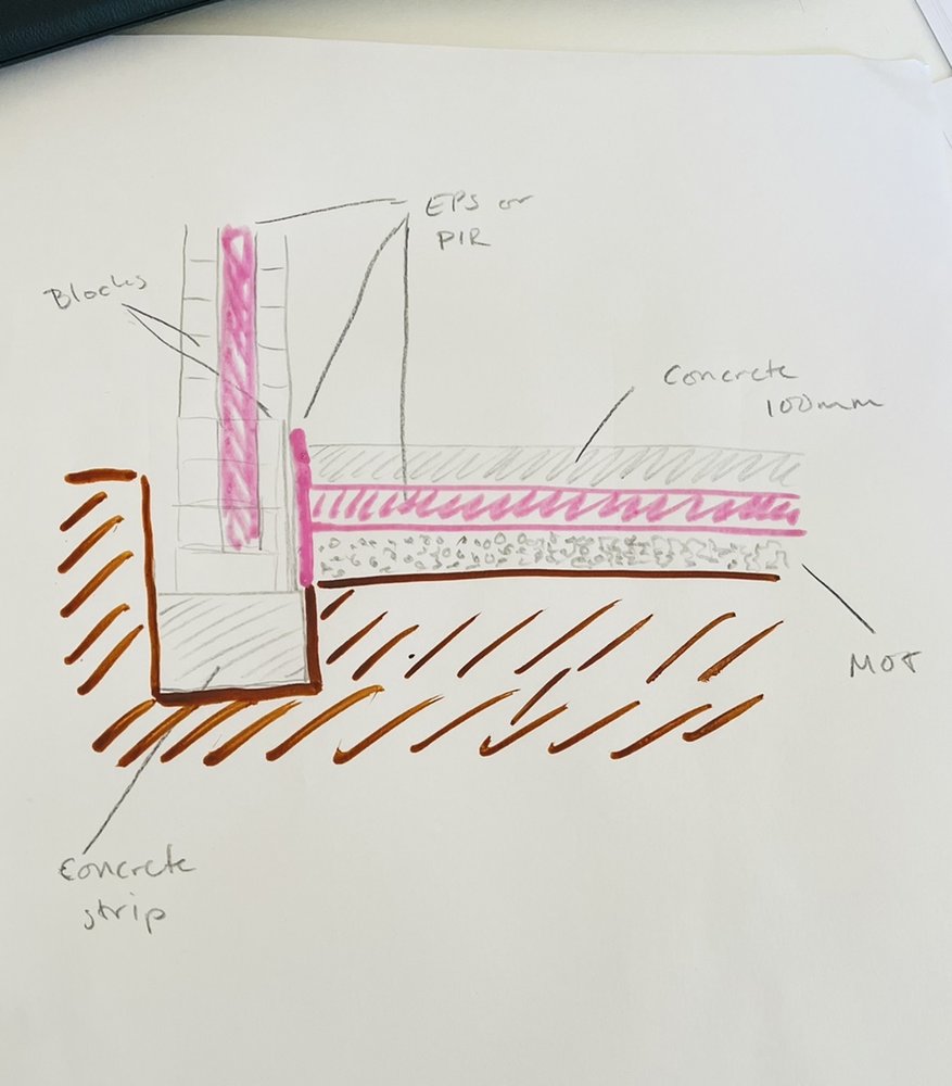

However, when it comes to the slab, I want to insulate it as much as possible, but it seems difficult to find online how to actually do it, hence posting here.
My plan is to build something a bit like a raft:
- dig down footings about 30cm deep (reasonable ground), and use rebar cages here.
- in the middle of the slab, remove enough material to be able to add some hardcore + sand, and also 100mm celotex or similar, and then 100mm concrete with rebar mesh
- DPM on top of the celotex and also into the trench and up to the sides.
- poured in one go
The question really is - what do you do with the side of the footings? I don't particularly want a cold bridge between the wall and the slab, so to speak, and I'm assuming I can't just add celotex to the side of the trench and under it? where and how do I terminate the insulation?
Other alternative would be normal strip foundations, but then I'd have to get the concrete lorry in twice, and the single pour of the raft would get me "out of the ground" quicker, so to speak.
Access is difficult, but I have just about (3cm spare) space to get a micro digger in, and will get a concrete pumping firm to deliver the concrete.
Picture of site as it stands:
