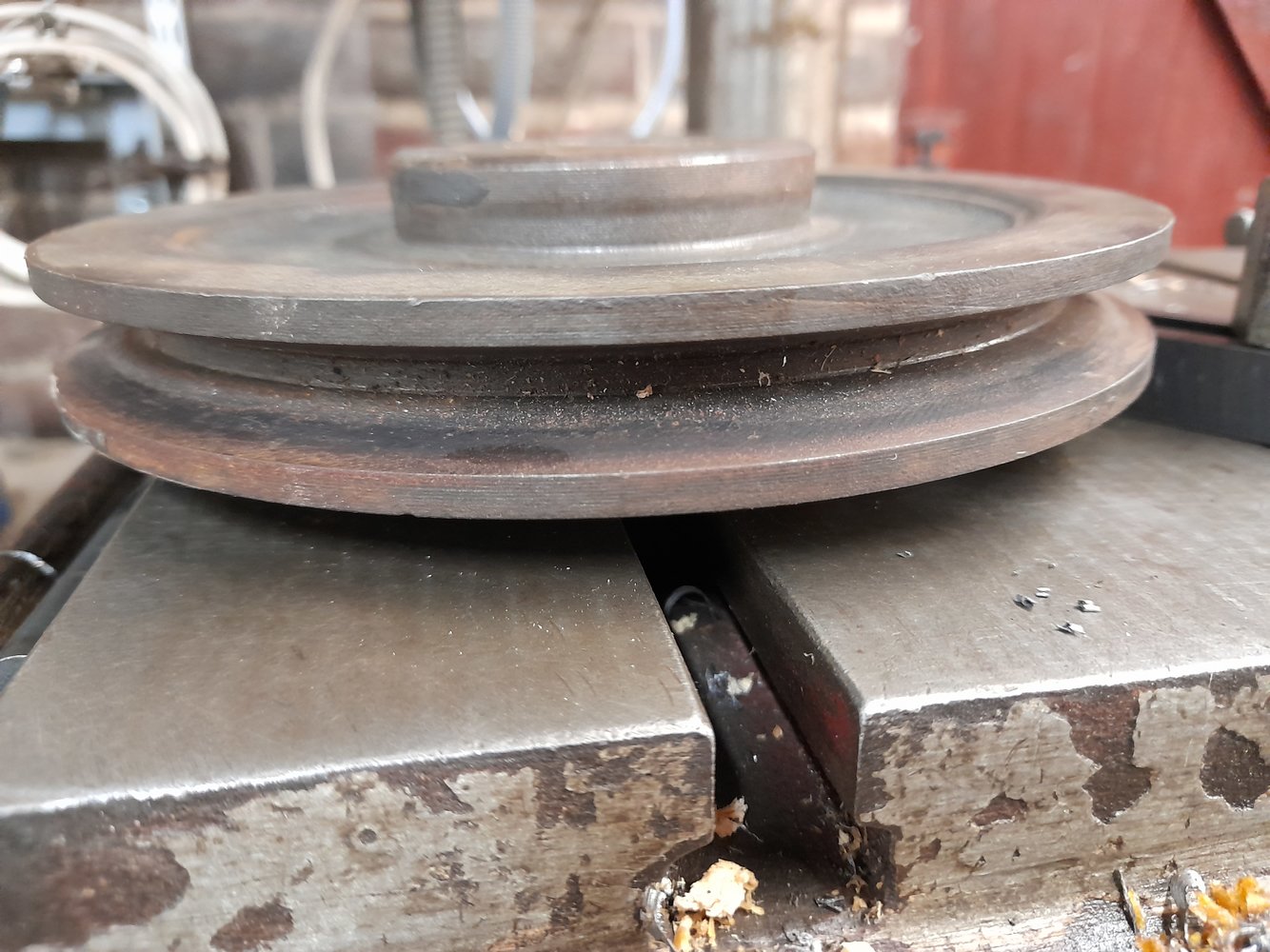

Two single groove pulleys, bored and keyed, slide on shaft to align, bolt together, with spacers between webs if needed?
The 185 OD pulley works out 180 PCD for an A-type belt (1/2" across top of the pulley vee?) and is standard.
The 212 OD isn't standard in my old Fenner book - a PCD of 212 is, but that is an OD of 218. Nearest size under is 200 PCD, 206 OD.

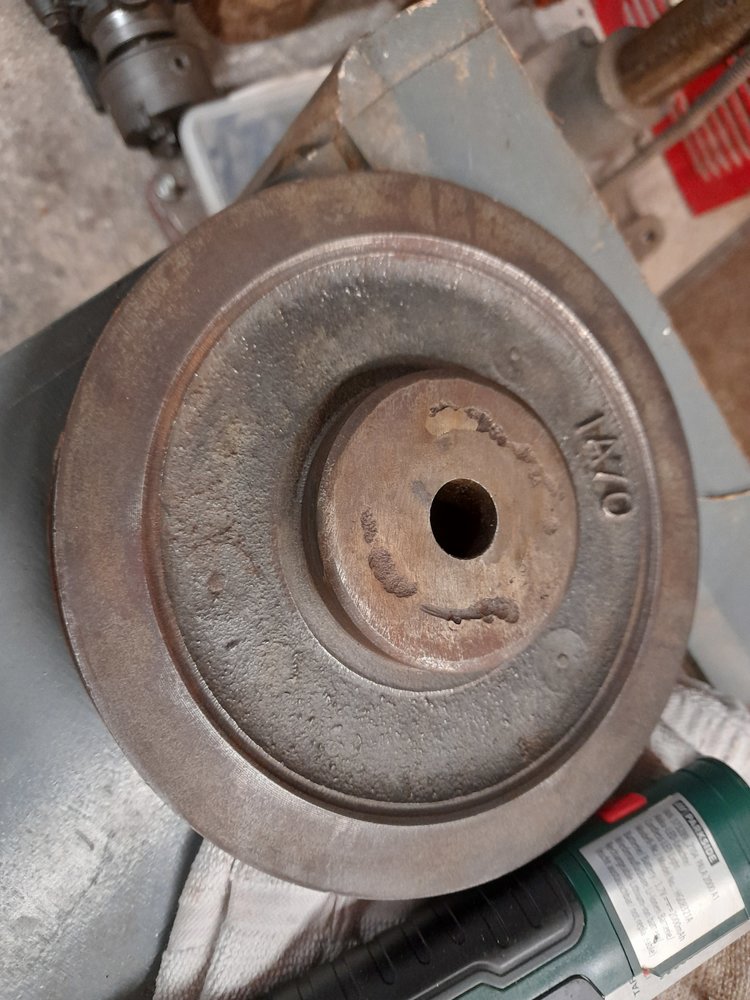

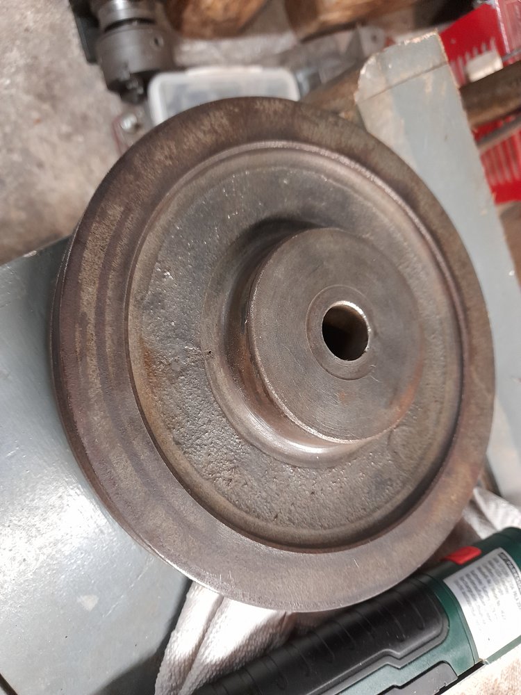

For my own use, and having taken the Yorkshire mode of deep pockets, short arms to heart (ie tight), I might be tempted to try a machined disc that sits tight over the hub, hub cleaned up as needed, one on each side, bolted together through the web, either the existing holes, or new ones. Relying on the new discs to keep the hub intact, and aligned to the web, working on the theory the drive will still be transmitted as the cracked bits are still physically engaged with each other.
