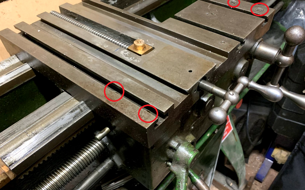

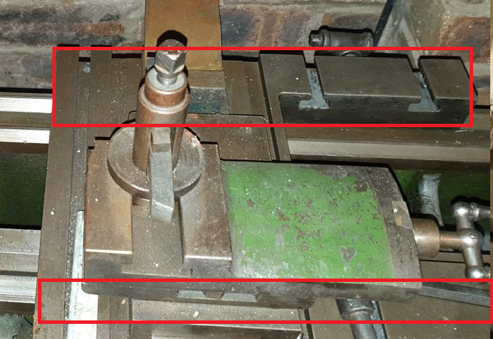

You sure? Looks like 4 screws to me, two in the T slot on the left (facing the lathe as if you're using it), two on the right.Sorry - I may be getting terminology wrong, but the whole lump (apron and saddle?) appears to be a single cast unit
The carriage is the whole lump. Comprising the saddle and the apron.the whole lump (apron and saddle?
There are caphead screws in the teeways which suggests that it isn't one piece? Sorry someone beat me to it. I'm sure a leadscrew and nut plus gear can be organised for you on the forum? What size and pitch is the leadscrew? Remember to remove both power shafts before you drop the apron.So.... mixed news...

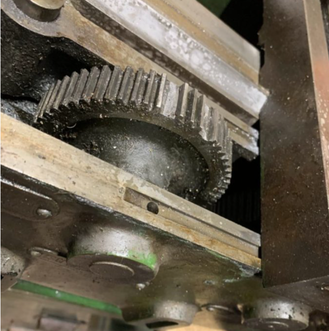

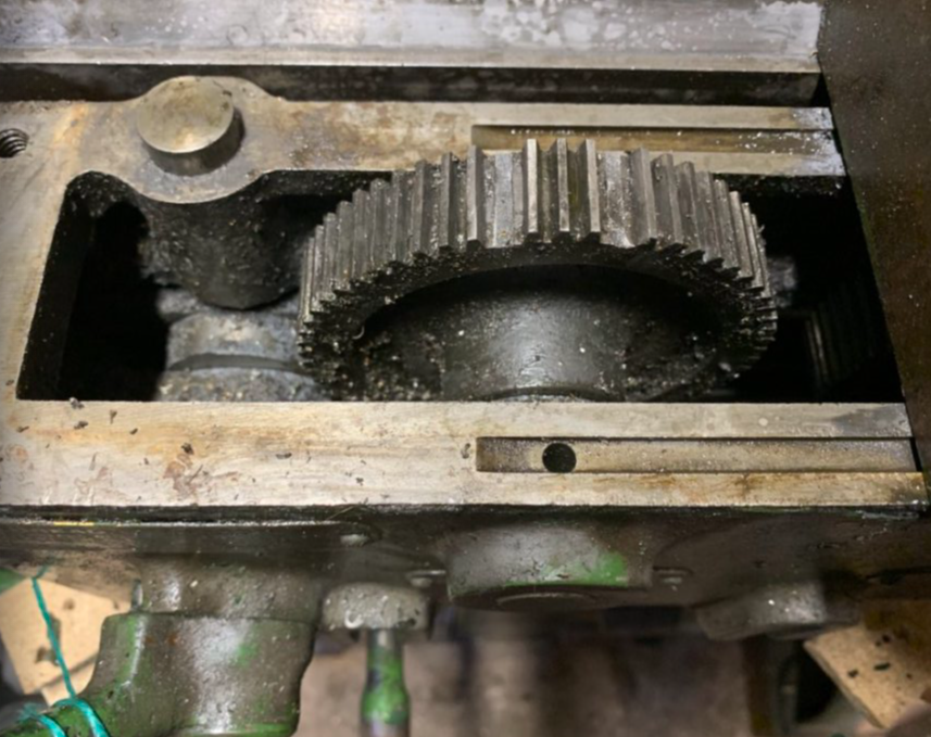

On the upside I reckon we have a diagnosis, which is that the transfer gear from the feedscrew to the cross slide screw has stripped (at least) a couple of teeth.
Continuing the (relatively) good news, the screw is straight and the brass nut seems undamaged.
Have a look at this (short! 50 seconds...) video to see the problem. The transfer gear is in permanent contact with the cross slide screw so it jars when winding in and out.
I reckon the only sensible short term fix is to remove the transfer gear entirely so that the cross slide rotates freely, at least until I can find a replacement (if possible for a 1930s lathe)
The not so good news is that the apron appears to be a single cast unit, not like the diagram that @500e helpfully posted above - https://www.mig-welding.co.uk/forum/threads/ive-broken-my-lathe.119144/post-2004747
You can hopefully see that in the video, too.
So I'm not sure how I'm going to dismantle it to get that gear off, at least not without picking the whole lathe up and rotating it, then trying to slide the apron off the end (as I'm short of space the right hand side of the lathe is up against shelves / a wall).

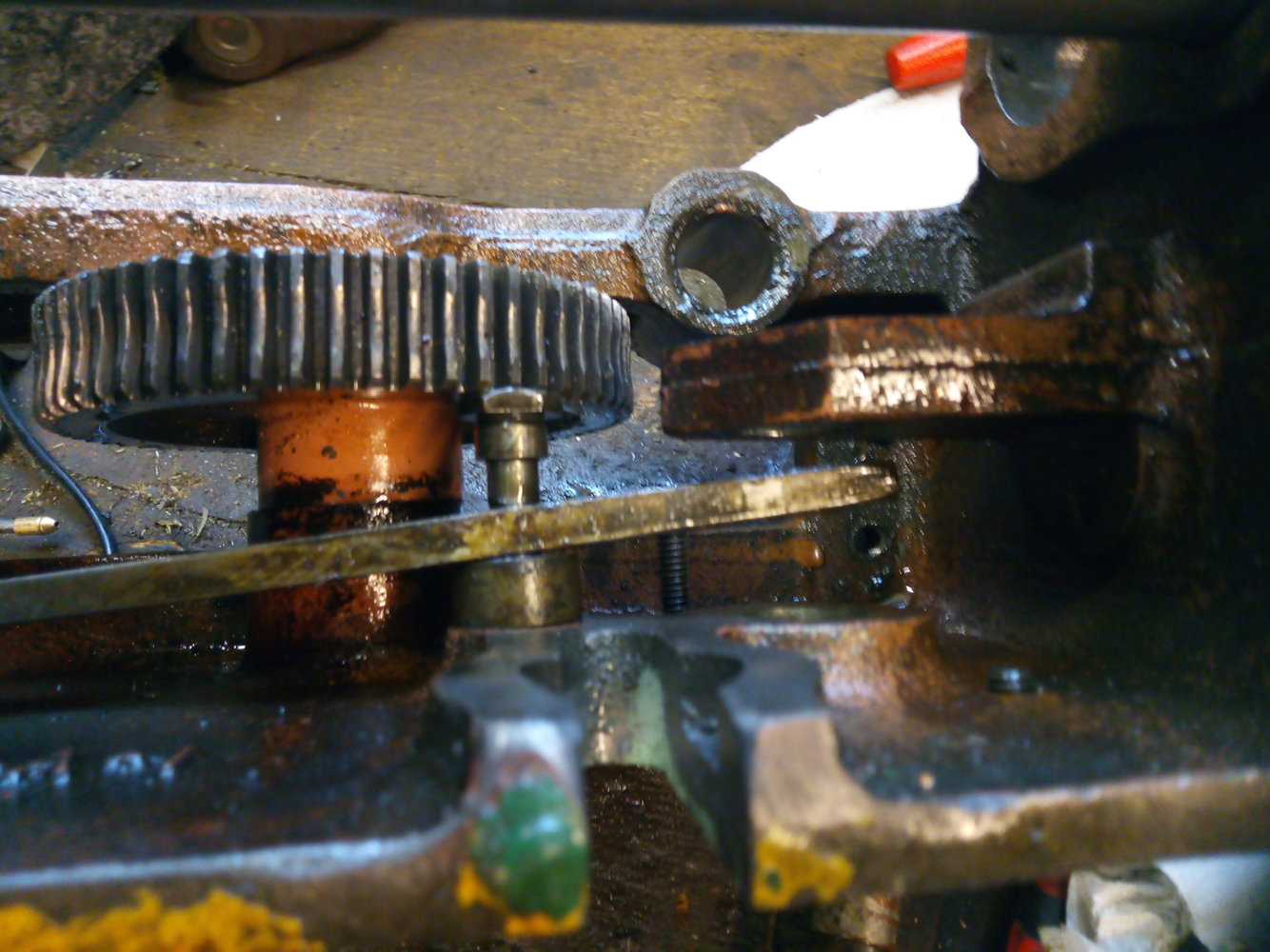

Shaft rotates with the gear - I've a suspicion that's what the hole is for in front of the gear, to get to a grub screw. But it was 11pm by the time I'd got to that point so chucked it in for the nightDoes the shaft rotate with the gear or the gear rotate on the shaft?
That should tell you if there is something holding the shaft in place or something holding the gear in place.
Quite a few of the Harrison gears have a grub screw them in place or where the shaft is fixed a grub screw holding it in place.
The other question, of course, is how to get the shaft out...
Could just be held in place by being attached to the gear.
