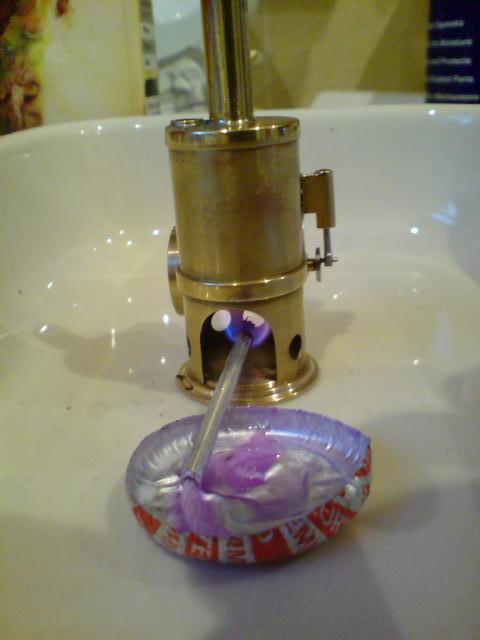

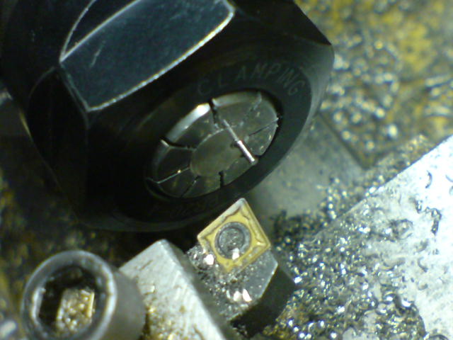

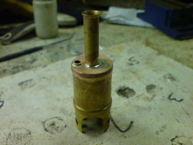

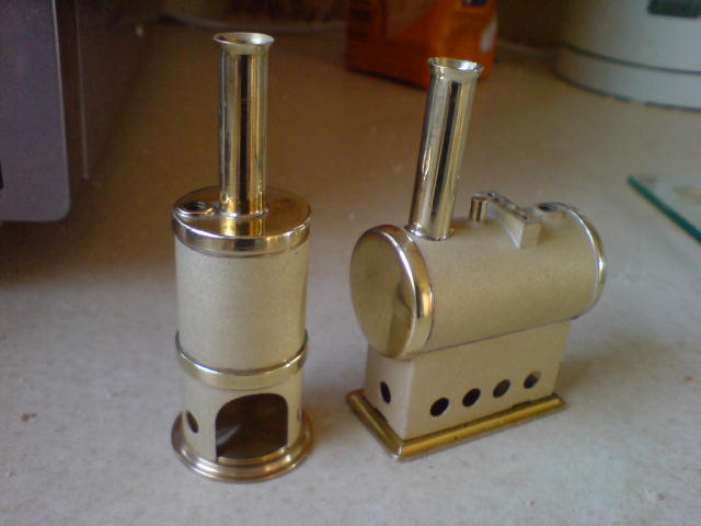

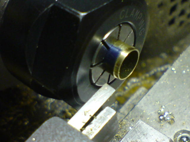

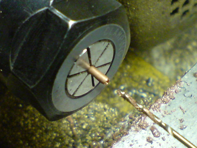

the second vertical boiler was made slightly differently to the first, this time I decided to do it with 2 lots of silver soldering, so the first thing was to turn a step on the end of the bottom of the chimney , the tube is 8mm o/d

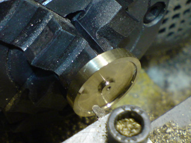

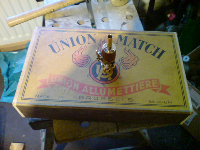

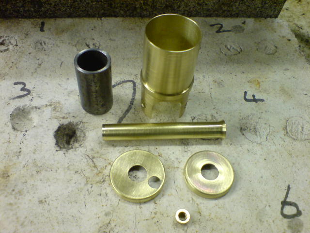

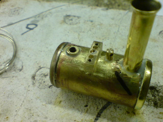

and the completed parts for the vertical boiler, the steel tube on the left isnt part of the boiler, its just a spacer

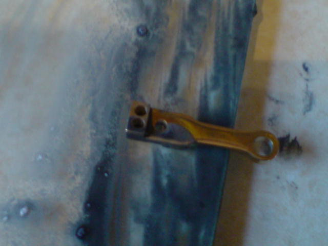

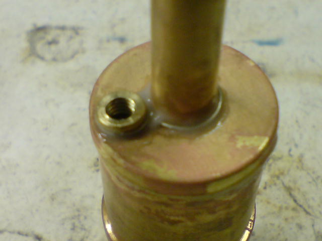

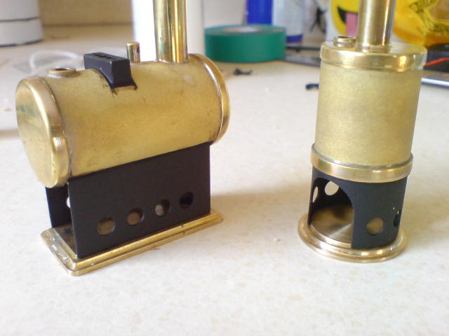

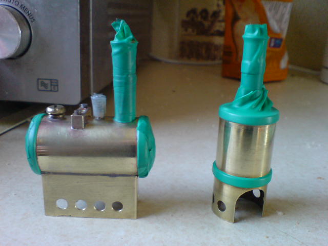

so the bottom of the boiler was silver soldered first, and upside down, with the steel spacer going around the chimney. the step on the bottom of the chimney was to stop the bottom of the boiler sliding down the boiler tube as it would expand during heating so would be a loser fit on boiler base. once again I used solder rings, here seen coated in flux and ready to go (the top was also soldered on now with the solder ring inside the tube)

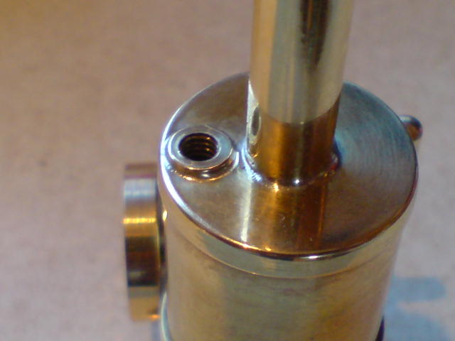

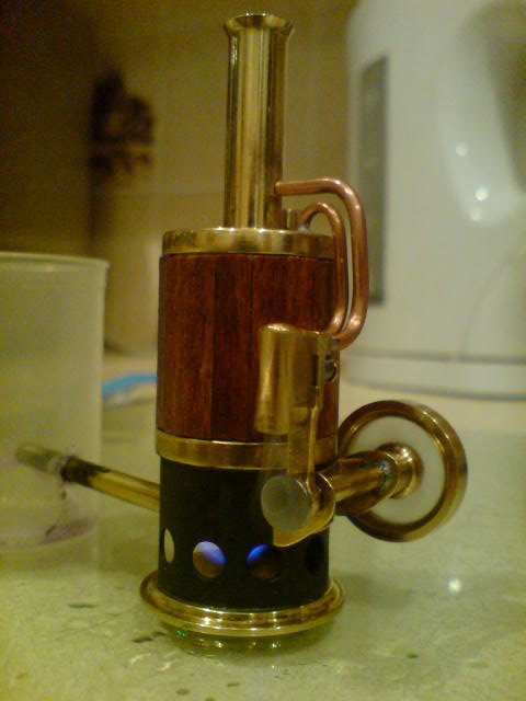

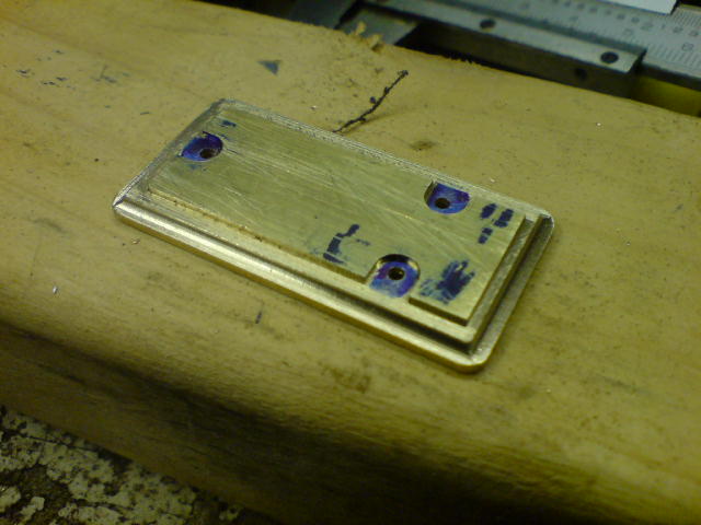

and turned over and the filler / safety valve bush was soldered in place with the top of the chimney, all fluxed up and ready to be heated

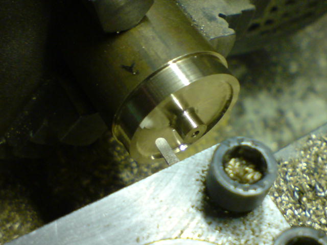

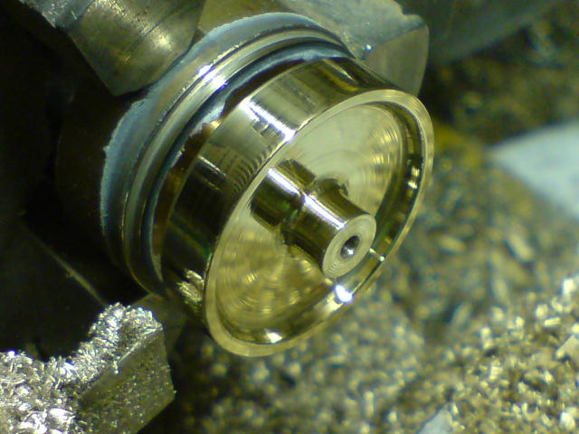

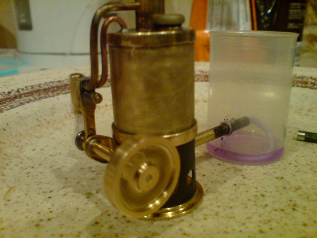

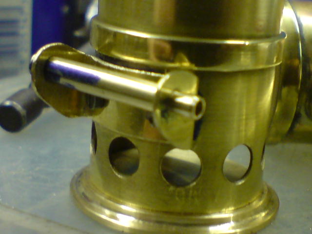

and the completed boiler after soldering and pickling
this was then pressure tested to 60psi, so is all ready to go.

I also used some autosol metal polish for final polishing on a cloth and it ended up looking like this, so Im happy with that (jsut for scale the thread is M4)
Very nice work there, one quick question is how do you clean the solder from the outside of the boiler?
