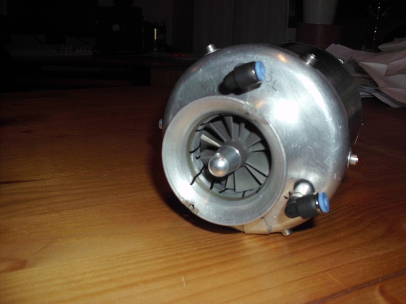

Nice spun intake I've just weighed all the bits of mine and it is over 1.2kg without fasteners. (I know I have built some parts heavy, as I haven't been concerned with flying it), but <1kg is a tall order.Hi, yes,the new one, but it is 99% a Kamps. unfotunately 1.102 Gramm. I targeted less than 1 kg

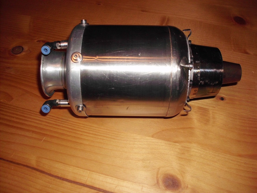

I took advantage of the break in the weather yesterday to take it outside and set fire to it.
(If you don't want to watch the video, keep reading below)
It runs!
I was absolutely made-up. It started up pretty much straight away (no doubt helped by me leaving the gas canister on its side, so there was an 'ample sufficiency' of gas for starting. I'm just using propane at the moment to see if it will actually work - for it to develop any real power, it'll need to go on to liquid fuel (kerosene, etc.).

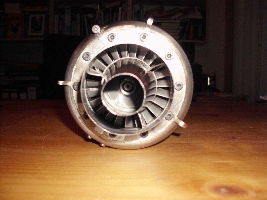

I was stunned by how smoothly it runs - I balanced the turbine & shaft assembly using the 'rocking' method to start with (the shaft and turbine on its bearings are placed in a loose fitting tube which is then rocked gently from side to side and see where the heavy spot settles, then grind a bit off). I'd got as far as I could with that, and thought I was done, but then I tried the method mentioned by @kappi above where you hold the rear bearing in your fingers and spin the shaft/turbine up with compressed air to feel for vibrations -you then add a small piece of tape to the turbine and see if it makes things better or worse. I found the second method more sensitive - I was surprised! What I noticed was the *absence* of vibration when things were right, rather than the vibration itself (if that makes any sense!).
There are issues with the oil supply in the video (in the first test, I think the connection on the casing for the oil jar was leaking, even before it fell off!) but this oil supply is only a temporary arrangement for running on gas - it will be fed by a bleed off the main fuel line when on liquid fuel.
I'm waiting on a few bits for the kerosene supply, but I can't wait to get it set up!
