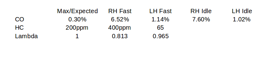

LH bank appears to be running nicely on fast idle, with RH bank significantly richer. Could it be a dodgy lambda sensor on the RH bank, sending a valid (but incorrect) signal, or it's gone open circuit completely? Therefore putting RH bank in a "default" rich setting to avoid serious damage.
