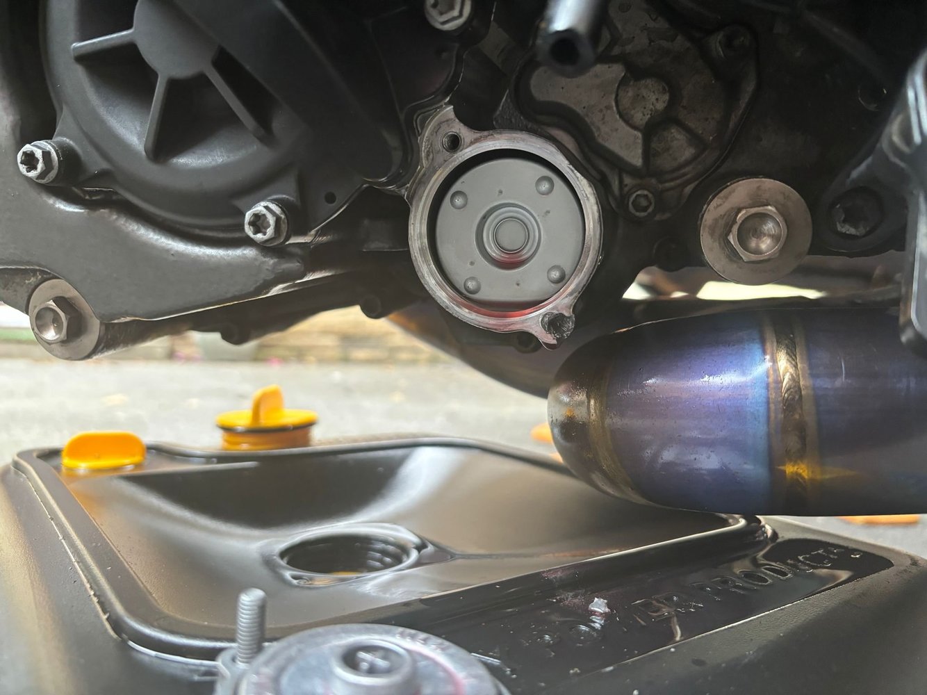

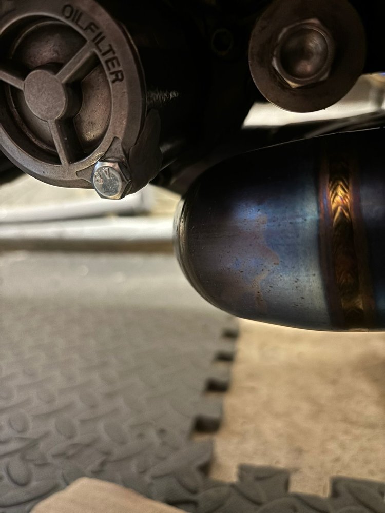

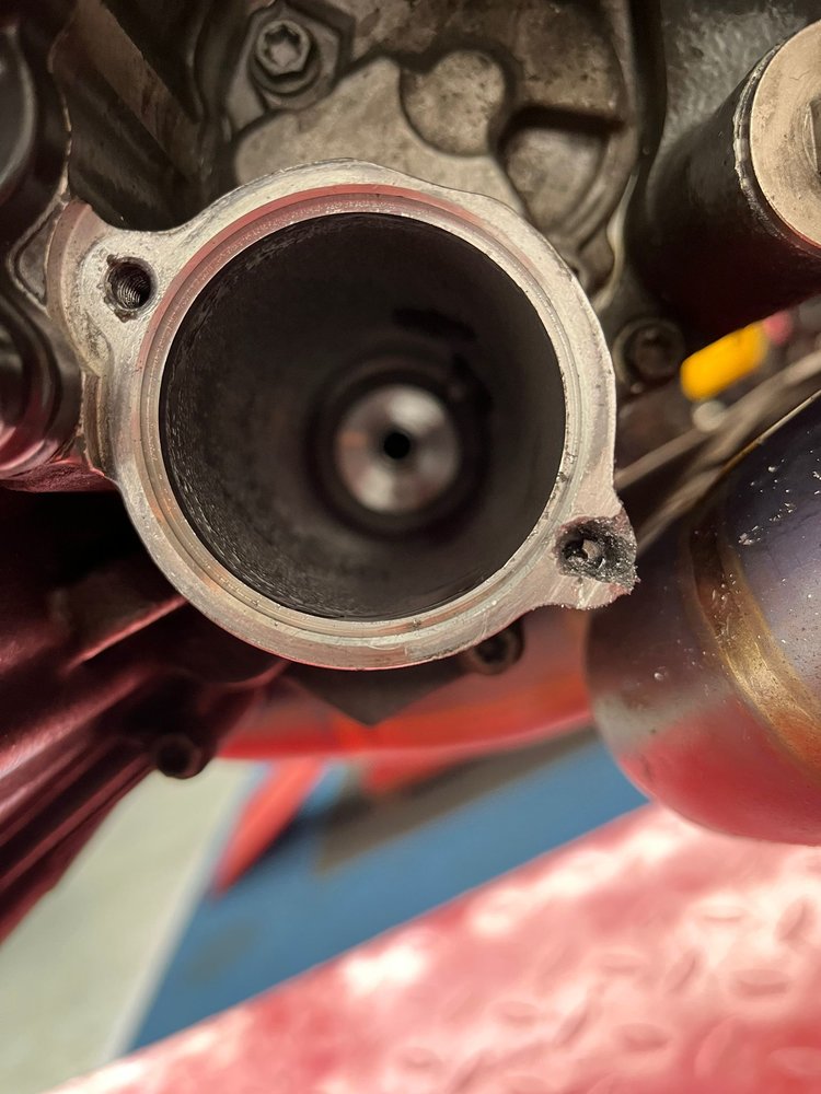

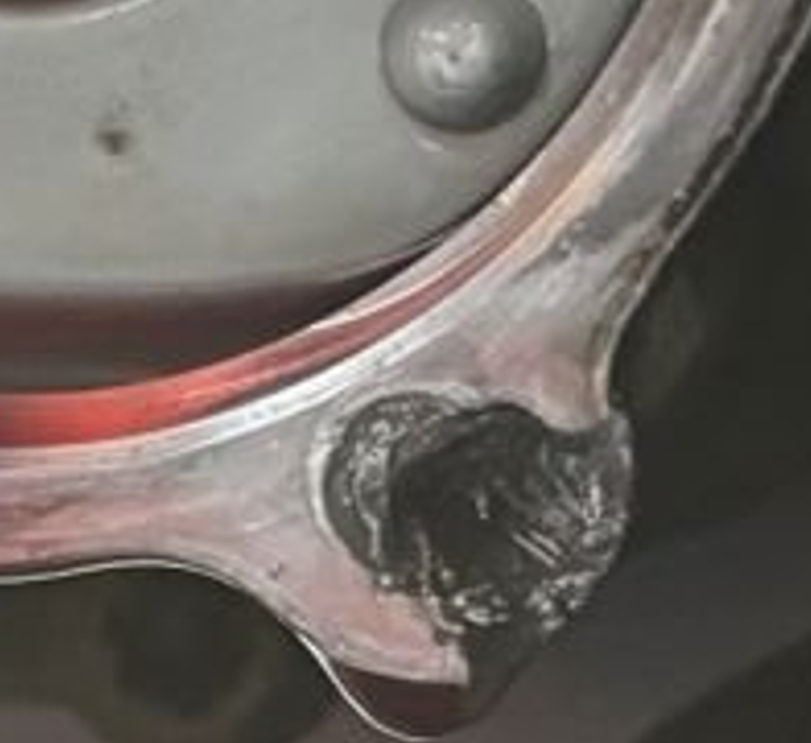

Hi, I was wondering if someone could help with potentially doing a weld repair on my KTM Superduke 1290R, the oil filter cover bolt snapped within the engine and I tried to retrieve the bolt and as a result some of the engine casing became damaged where the bolt is normally held.

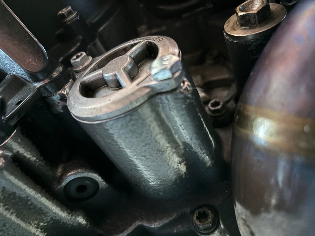

The oil filter bolts are T5 M8 x 16 and the manufacturers recommended torque setting is 6NM, one only of the threads is damaged, since then the hole has been drilled and the remaining snapped bolt has been removed. I have since tapped the hole (that was made bigger) with an M8 tap, installed a M8 helicoil and gone up to an M6 bolt which so far appears to hold the oil filter cover solidly in place.

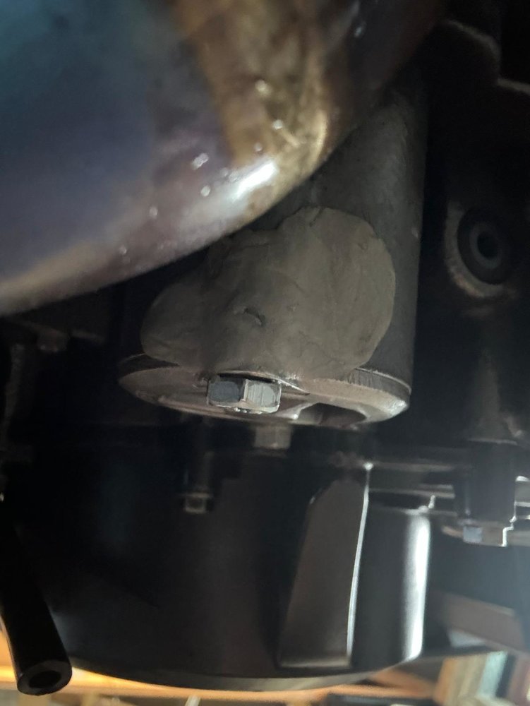

I have also built up the surrounding area with JB weld high heat putty, filling in all the broken engine casing:
Link to epoxy here
I am hoping the JB weld is going to hold up for at least the foreseeable, if it does not I believe it will need TIG welding which brings me here, would anyone here be prepared to perform a repair on this so it can be drilled, tapped and Heli coiled (may even throw a timesert at it).
The JB weld was applied about 2 hours ago (07/09/24) will be waiting until tomorrow before starting the Bike up and running the bike for a while, has anyone here used JB weld for small low torque repairs like this? if so has it held up for you.
I am prepared to pay well for someone to have a go at welding this (ideally with the engine in the Bike if possible) I have included pictures below.

Before the bolt was removed:
Before the bolt was removed close up:
After the bolt was removed:
My repair with larger bolt, helicoil before JB weld applied, see large gap behind filter cover:
JB weld epoxy applied:
