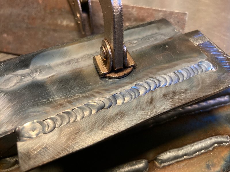

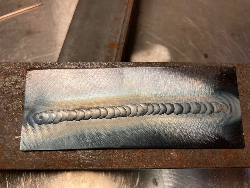

Hi,
I'm currently trying to improve my TIG techniques by practicing on 2mm mild steel. I am pretty happy setting up the correct amps on my MIG for various thickness of mild steel, but do not have that confidence with my TIG machine yet.
I have been trying various settings and consumables out and have found a reasonabley solid and consistent setup, but I'm still not sure I'm getting the amps dialled in right for the different joints. My main technique is to get a similiar thickness piece, start with the 30A per 1mm rule, so for 2mm I'll start with 60A. I hold the torch and get an arc and hope a nice puddles forms in 2-3secs max. If it's slower or quicker I adjust the amps accordingly, and then try again. Once happy I run a test bead.
Here's a pic of a quick lap joint I did today in order to post up, on the back of an old practice piece. I have a R-Tech 160 PDC which I think is a good little machine for what I do. I was using a #7 cup with a 1.6mm tungsten, ground to a long point about x2 the tungsten thickness. Gas flow was just up to 7lpm. I tried to keep a tight arc and was using 1mm filler. It's two passes, hence the slight deifference.
I think the amps are too high causing undercut. The bead is also concave. Maybe going too fast and not enough filler. Does this sound correct.
I have some time tomorrow to practice some more, so any advise as to what to do to improve would be really appreciated, thanks!
