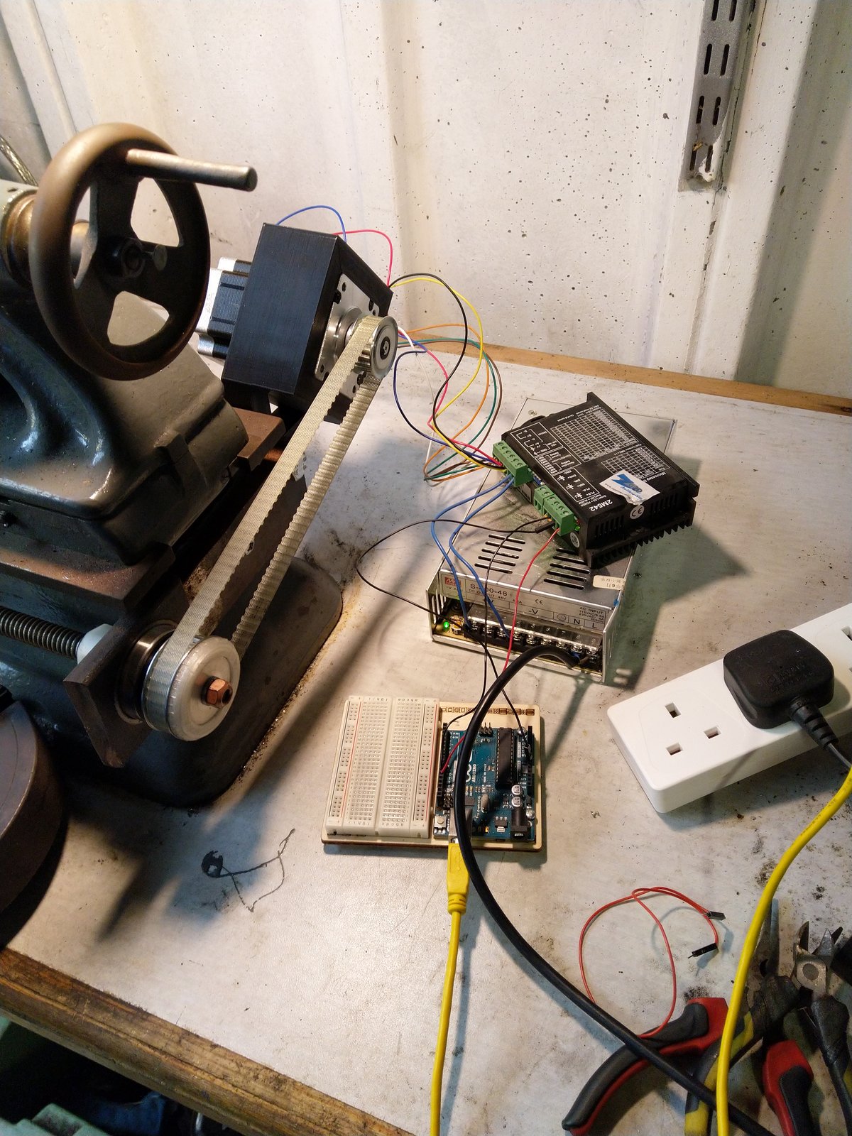

Motor mount 3d printed, and fitted
It moves the carriage:
Moving the saddle around (both travel and feeding work). Apologies for the rubbish video,I was too excited to make a proper one

Return to zero test:
https://photos.app.goo.gl/w47iJSLce6p9jXLRA
This test lies a bit, I get some flex in the lead screw mount (I think), so sometimes it's up to 0.10mm short on the return.
I've ordered a raspberry pi touch screen, and will write some software to control the Arduino from the raspberry pi instead of having actual buttons controlled by the Arduino.
