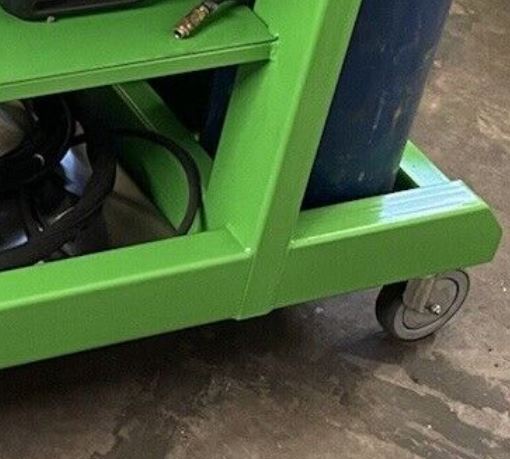

I like the color.....But apart from all that, do you like it?
Yup, the details are bad.View attachment 397096
Looks like 2 seperate horizontal sections welded to the vertical, with weight on the table it will be trying to crush the vertical box sexction or open out the bottom.
It's actually dangerous with the bottle there.It’s a bad design, why would you want the gas bottle next to the edge of the table, stops anything overhanging that side and stops you from working round all of the table. Ok if you are tigging small parts I guess.

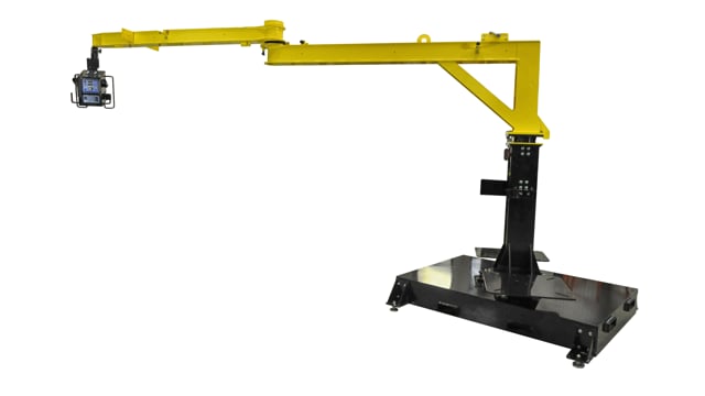

Those are weld arm booms.The best welder cart contraption I have seen was on here somewhere. Welder was on a high level wall mounted swing out gantry, wasnt anywhere in the workshop it couldn't reach. Gas bottle can stay outside.
Bit like this but wall mounted
Suppose the ground clamp fell off the part, and your up against the bottle.
Strike an arc, and it finds the ground thru the bottle.

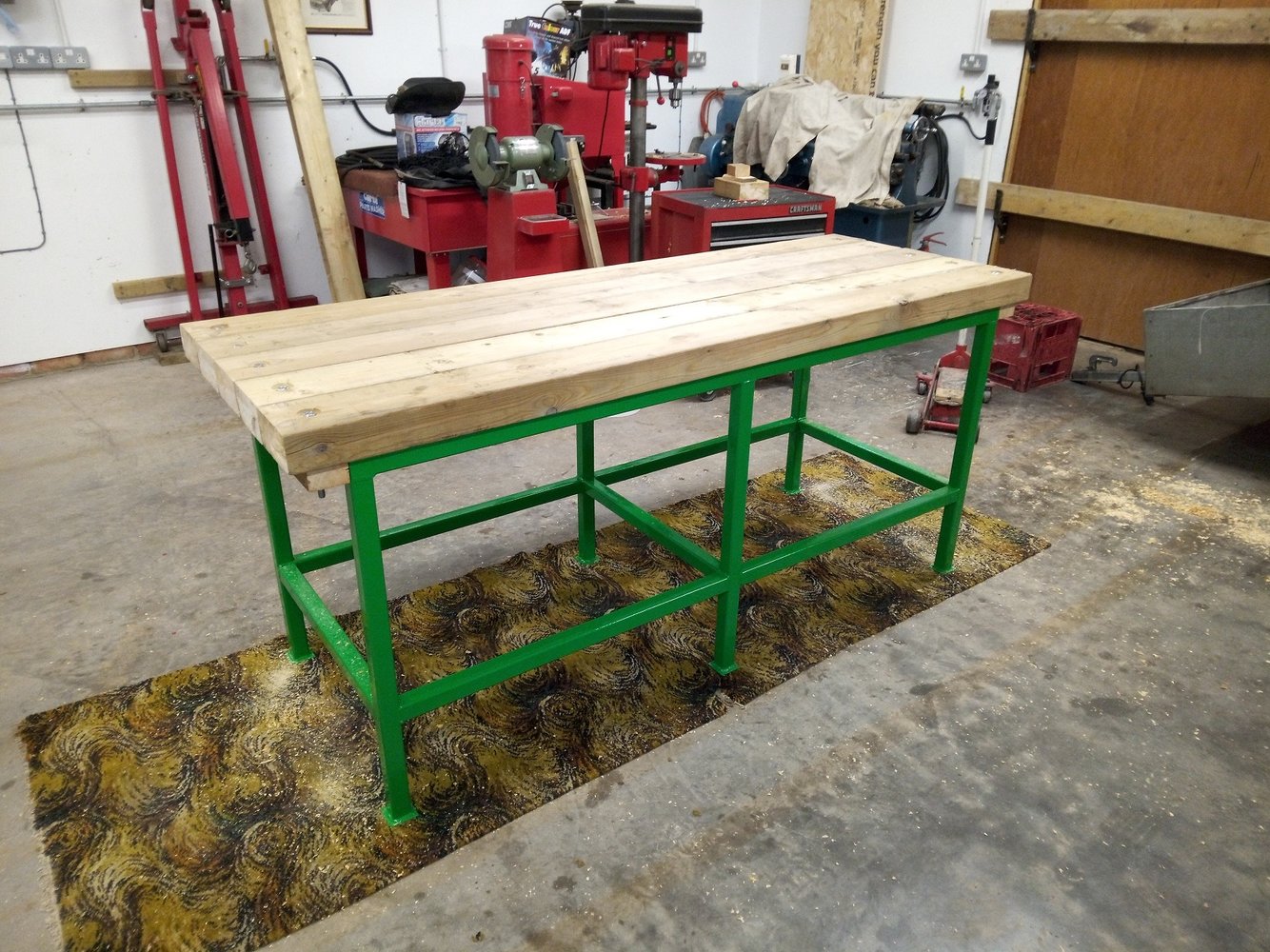

Clashes with the V,v,G. carpet.
If my welder was that close to the ground I would never be able to stand up post adjustments. Not joking ,this time.
could be wrong, but I think it was @Welderpaul the feeder unit was suspended from a gantry type arrangement, maybe Paul could confirm...The best welder cart contraption I have seen was on here somewhere. Welder was on a high level wall mounted swing out gantry, wasnt anywhere in the workshop it couldn't reach. Gas bottle can stay outside.
640 × 360
Yes, just the wire feeder on the boom end, power supply is at the post.could be wrong, but I think it was @Welderpaul the feeder unit was suspended from a gantry type arrangement, maybe Paul could confirm...
liked the idea too, gets it out of the way, especially if your struggling for space...
Oi! That's Axminster I'll have you know!Clashes with the V,v,G. carpet.
My neighbour has mad lovely ones with spring counter balance for the welders and plasma. The springs are balanced for the wire feed unitsThe best welder cart contraption I have seen was on here somewhere. Welder was on a high level wall mounted swing out gantry, wasnt anywhere in the workshop it couldn't reach. Gas bottle can stay outside.
640 × 360
And what's wrong with green?!!!![]()
Oi! That's Axminster I'll have you know!![]()
