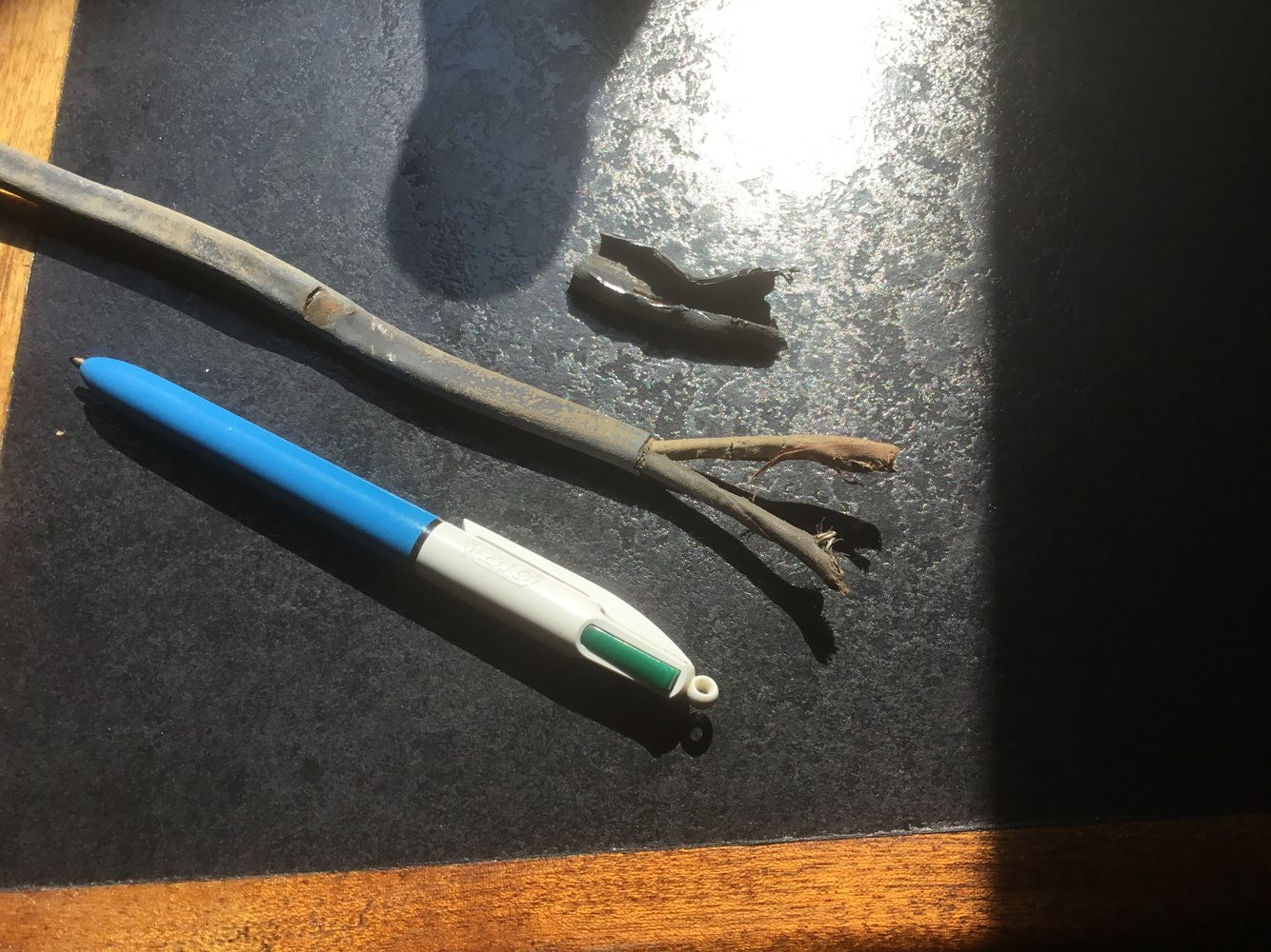

I've seen it in buildings that went up in the 1930s.
I shall try and find out how old the shed is it came out of.
rubber coated cores and wrapped with cotton material then the lead sheath that type was never waxed or oiled . mainly used to see it 50 years ago in large victorian houses and churches people with loads of £££££££ who could afford electric instead of gas lamps . we burnt the lead off and weighed it in with the copper on rewiresI came across some of this lead cased copper 240v cable today.
I don’t think I’ve ever come across it before.
The actual copper wires are wrapped in what looks like a wax paper.
What era would it be from Victorian times? Found in a old wooden barn connected to a old cast iron light switch.
yep still a lot of houses near me still wired in it and slowly burning out once tightened up the aluminium creeps and loosens off . was never a good idea using it in houses .its only any good on large cables and buz bars using crimped jointsLead cased was used from the turn of the century up until the 1950s.
Rubber insulated (VIR and TRS) was used into the 60's
Then you had that horrible aluminium stuff in the 70' and early 80's
I don't know but suspect it was at the same time as they did central heating in steel pipes, going by the stuff in my Dad's old house that would have been very early 70's. Was there a copper shortage at the time?yep still a lot of houses near me still wired in it and slowly burning out once tightened up the aluminium creeps and loosens off . was never a good idea using it in houses .its only any good on large cables and buz bars using crimped joints
Yes there was, I can’t remember where but there was a political problem in the mining country. The copper tube that was available was thin walled to save copper & couldn’t be bent, it just wrinkled & collapsed. Stainless tube was tried as well & you needed special flux to solder it, it’s a long time ago & I can’t recall how successful it was. I worked in a builders merchants at the time & all the plumbers complained about the copper tube, reckoned it was rubbish.I don't know but suspect it was at the same time as they did central heating in steel pipes, going by the stuff in my Dad's old house that would have been very early 70's. Was there a copper shortage at the time?
yep thats why it was used apart from ther steel pipes they made thin copper pipes that wouldnt bend to save on the copper it was called red stripe as they had a red line painted on it to identify itI don't know but suspect it was at the same time as they did central heating in steel pipes, going by the stuff in my Dad's old house that would have been very early 70's. Was there a copper shortage at the time?
The house I grew up in had lead covered cable, it was there until both my parents had gone & the new owners gutted it 20 years ago. There was also a 10amp 2 pin plug, the like of which Ive never seen another. Also fuses both on the live & neutral, how dangerous is that, blow a neutral fuse & the circuit stays live!
