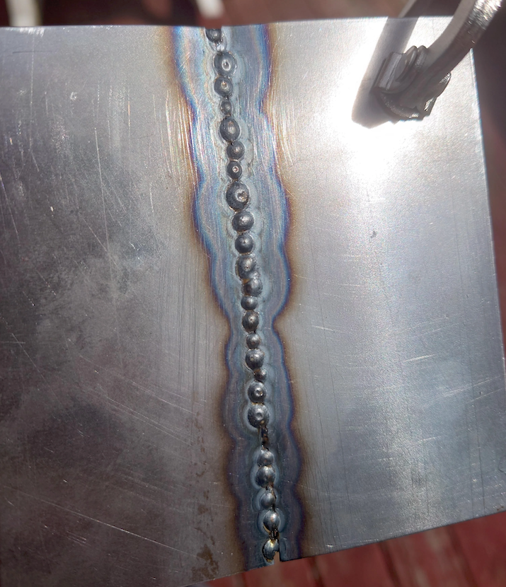

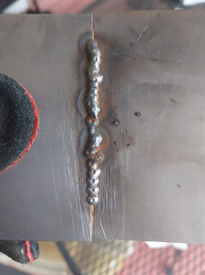

Need tacks to not warp metalTry holding the trigger on for a bead.
Oh c'mon MM - the OP is just starting out & learning - cut him some slack eh!Well at least get them all in a line..
Really ?Need tacks to not warp metal
You have any actual advice instead of joking around?Really ?
W-O-W !
Any advice would be helpful.Oh c'mon MM - the OP is just starting out & learning - cut him some slack eh!
Anything elseWell at least get them all in a line..
Anything else
Honestly I'm not experienced enough to feel qualified to advise about welding, when there are so many on here that really can "walk the walk" with a welder.Any advice would be helpful.
You asked for advice, and I gave you some.You have any actual advice instead of joking around?

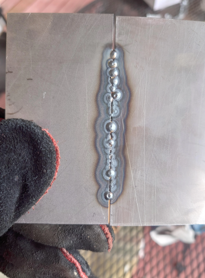

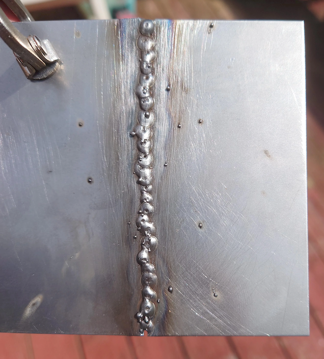

If you look at the picture @8ob posted with the 1mm gap and the weld bead it has a lot less distortion than your series of tack welds. Just practice welding beads on a flat plate before attempting to join two pieces together. When you are comfortable welding beads on the plate then progress to joining two plates together.Need tacks to not warp metal
I said what I'm planing on doing. You keep giving advice to do the complete oppitsite. of what I'm trying to do.You asked for advice, and I gave you some.
then you come back and TELL me like I am wrong.
Why bother taking time from my busy schedule when
you don't want to learn ?
Bye !
What distortion are you seeing? I'm asking so I can try to see it. It's bowed in from the center but its all even no waving. I think its because the metal wasnt clamped down flat. I had it resting a 1/4 inch on wood on both sides after tacking the top and bottom nothing suporting the center. I checked each side with a straight edge and saw no other warping.If you look at the picture @8ob posted with the 1mm gap and the weld bead it has a lot less distortion than your series of tack welds. Just practice welding beads on a flat plate before attempting to join two pieces together. When you are comfortable welding beads on the plate then progress to joining two plates together.
I did a couple of beads acidently and it looked the same on back as the top.Really not that much to worry about. Try different lengths of tack/stitch and see how your penetration and distortion go. That will also help with telling if your settings are OK.
You know what you are looking for so just experiment and collate, that turns into experience.
Yes, keep your tacks in line...Any advice would be helpful.
I'll give it a try lowering it next round. I was having a hard time see with the shorter wire length I had my head almost laying side ways on the table. I belive I had 1/2" length of stick out with the flux core I was using 3/4"@wolfy1091 you are doing ok, I would say the volts are where you need to be but the wire feed needs backing off a tiny bit. A few tricks worth mentioning are getting yourself into a comfy position where you can prop/steady your arm while you weld, I dont know many that can stoop over their work and hold a straight line, other little trick is to scribe/mark a line either side of the weld as a guide. Other than that keep practising, you will get more goes out of the test pieces if you run a 1mm thick cutting disc up them.
