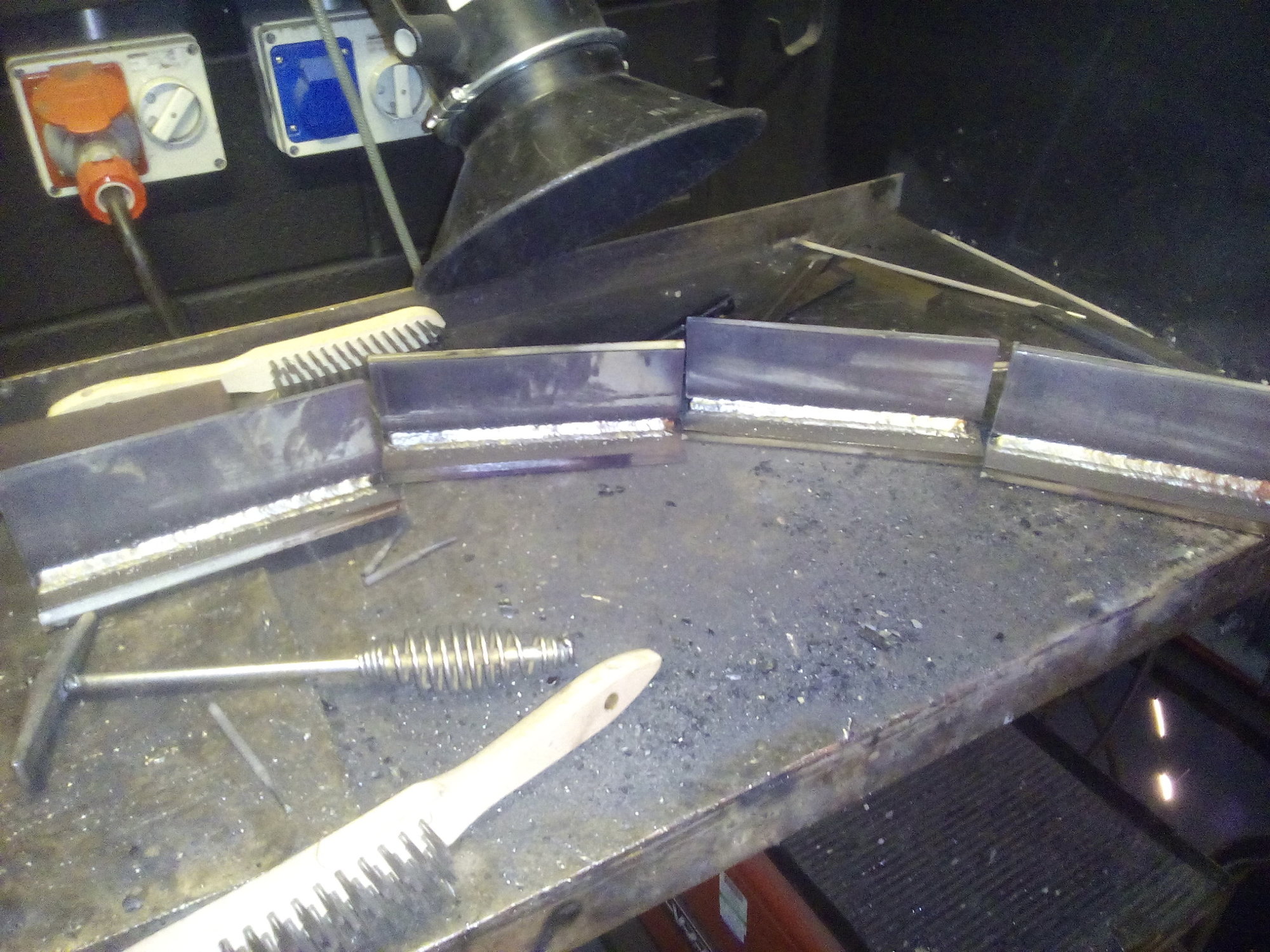

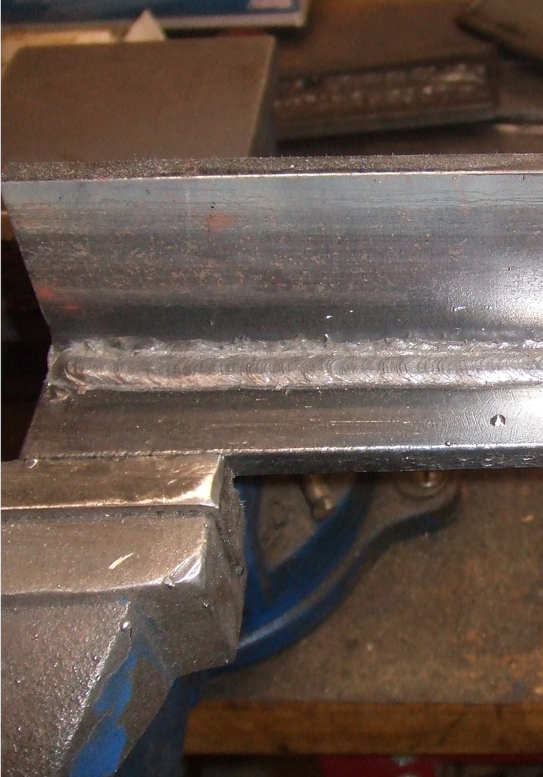

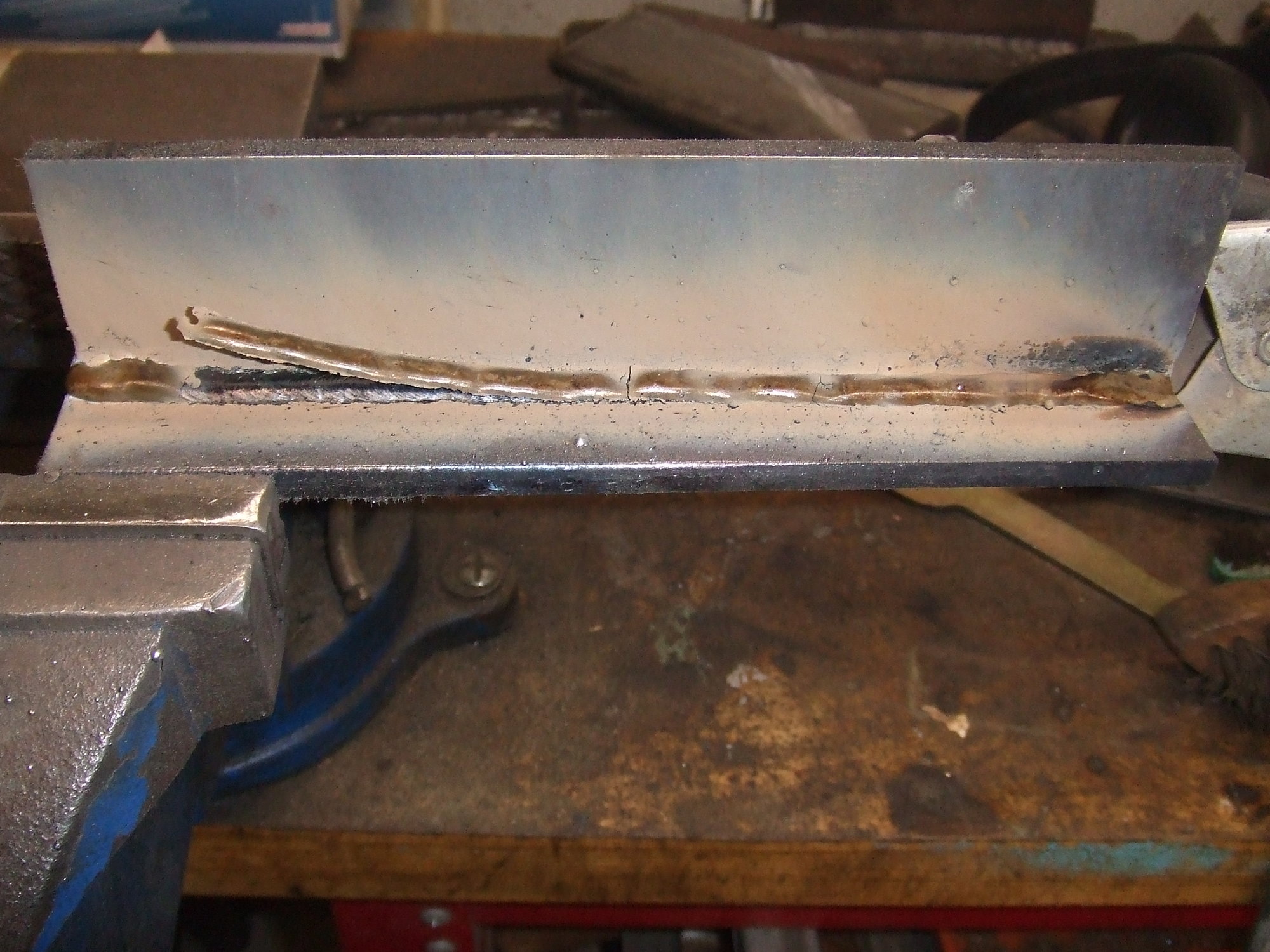

That was a good lesson in the differences between rods and it's always good practice to run a few test welds with new rods to get used to their different welding characteristics. You were very sharp in realising what the problem was & correcting it, I certainly wouldn't have worked it out quite as quickly.
I've never used oerlikon overcord but with their fincord rods you have to virtually drag them along the weld root with a very short arc length. Maybe that's why you were getting so much heat & spatter, try a shorter arc length. Around here fincord are known as the farmers rod as they are virtually idiot proof but some say they lack the penetration of other rods.
I remember when I first tried the murex vodex rods I very nearly chucked them in the bin. By reputation they are a top quality rod but I couldn't get them to run nicely.
It wasn't helped by the fact that I was at the top of a ladder trying to weld brackets onto a girder! But I had been spoiled by running fincords all the time and once I adapted my technique using a more normal arc length it all clicked into place & I produced some lovely welds.
Another rod you should look for is an INE blue. Nobody around here stocks the top branded stuff due to the price but I can still get the INE at decent money. They are a lovely rod to use, though they take a good tap to restrike the arc on a used rod and produce a nice weld.
