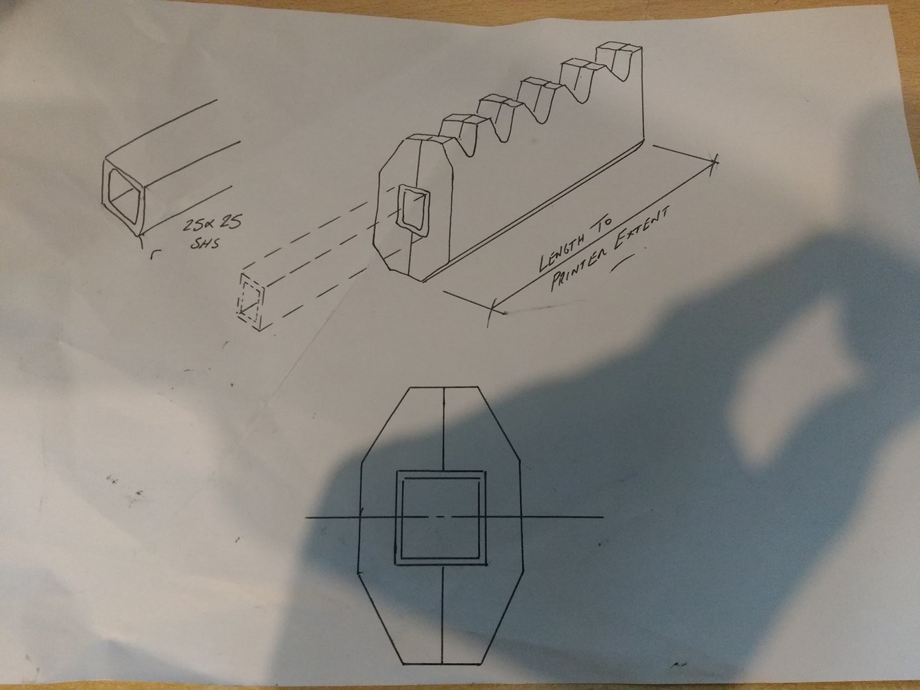

Say I want to build a router rather than plasma table that would do 8'x4' (maybe even 10'x5') sheets

So.....what I have is masses of 25x25 steel box. 3m lengths. I got to thinking I could build the XY rails out of this. Then came the rack and pinion vs belt issue. What if I was to print the rack in two halves, in lengths, as big as the printer would let me, then screw it to the box section? The print could be done as a sort of diamond profile to suit a custom carriage.

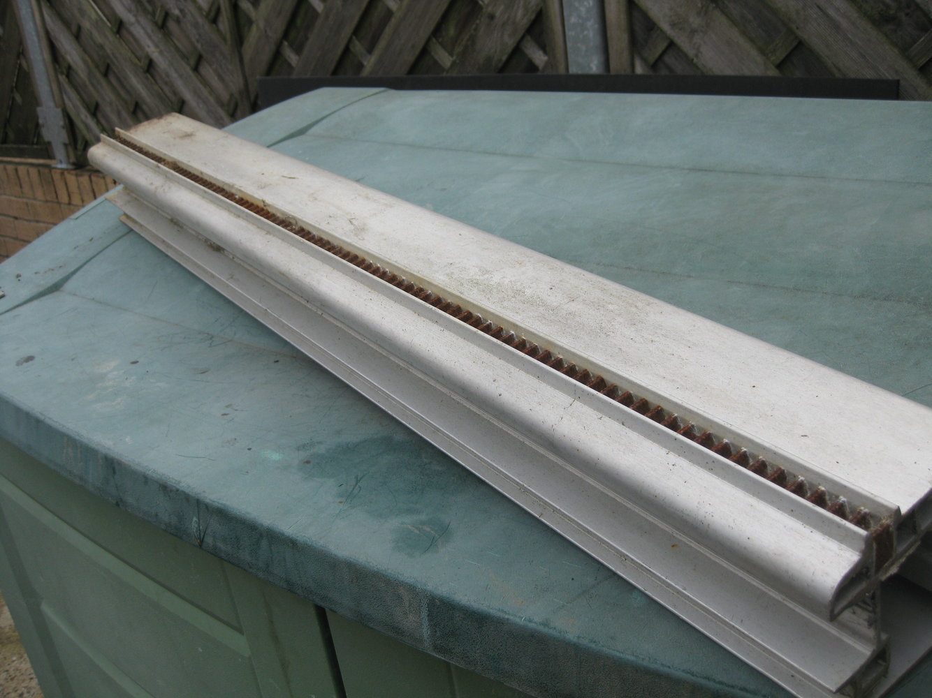

How about a rack & rail for not a lot of money about 9 feet long
Two of the same model stair chair lift , they have a precision ish counter sunk screwed toothed rack in the rail and the rails are very very sturdy , . print the wheels so they are bearing on both sides and don't fully sit down in the teeth . Same principle of a change gear lathe compensating for wear .
Can get a photo of some of the rail I begged for free . They came from a disabled stair lift installing company removed because it is an insurance liability to sell second hand ones with no guarantee .
Possibly, show me what you've got as they say! Cheers.
