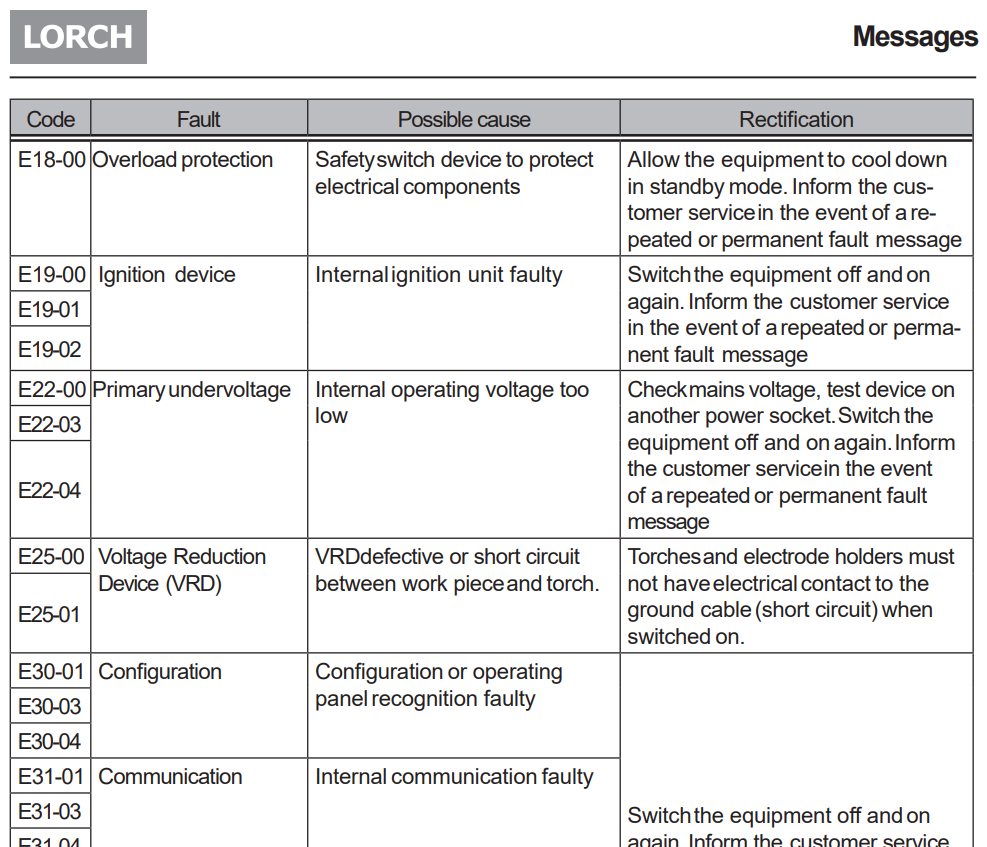

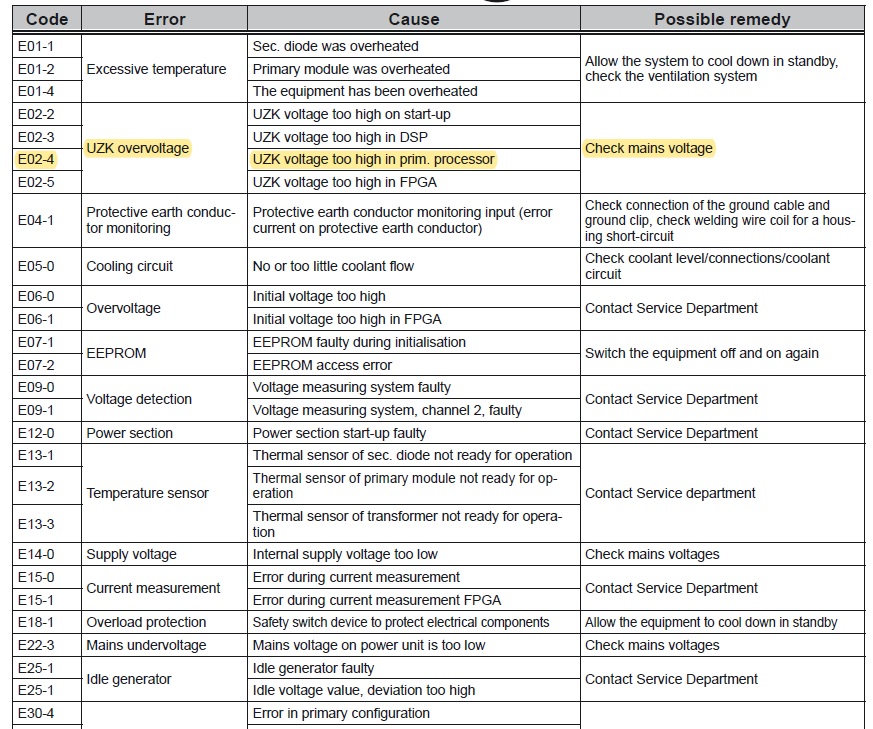

quick question about a lorch we had borrowed from a friend
when working on a rsj, welder at one end and another at the other end, everytime the murex welds the lorch cuts out and E24 comes up on screen.
What causes this ?
Hes looking to sell it but it looks like it doesnt like our other welders welding on the same item of steel
Have tried it with the esab and the Kemppi's
Any thoughts
