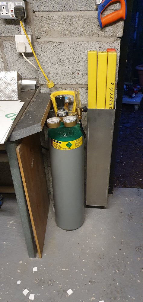

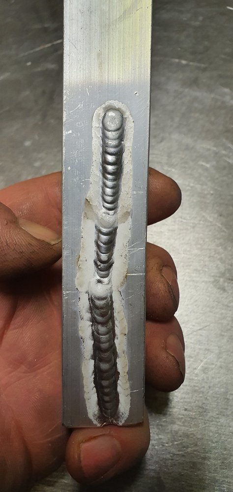

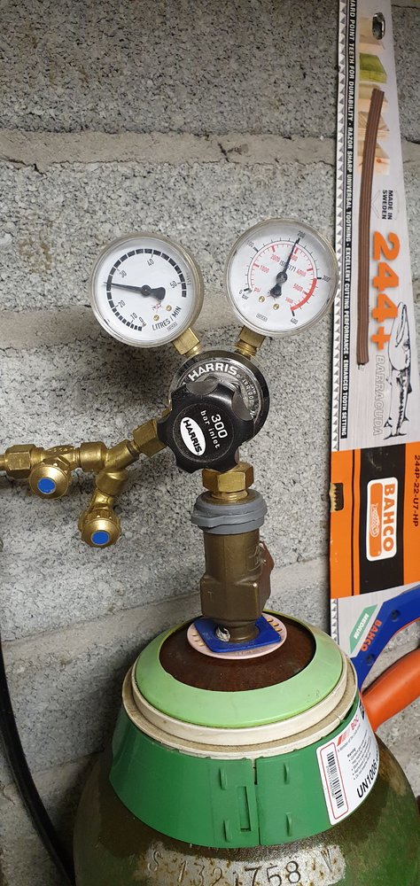

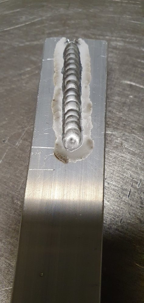

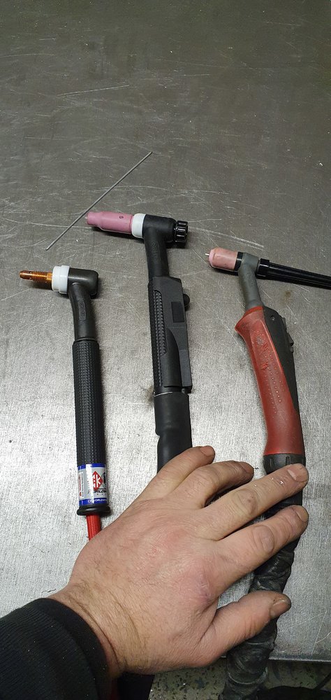

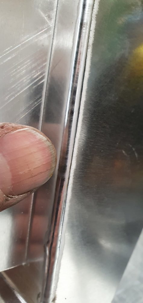

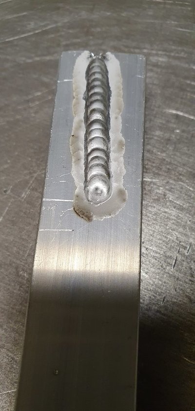

I've been having what looks like gas problems for a while I've too many jobs on to be messing about much more the problems are intermittent they look like bad gas I've changed torches torch set up, settings to no end gas company's tungsten looks fine which is one of the things that tell me everything is as it should be, I find it hard to believe its the welder, my next step is regulator although it and the gas lead going into the back of the welder are holding pressure over night 2 bad welds and one recent fusion weld hoping someone has come across this, before I leave it in to get looked at
