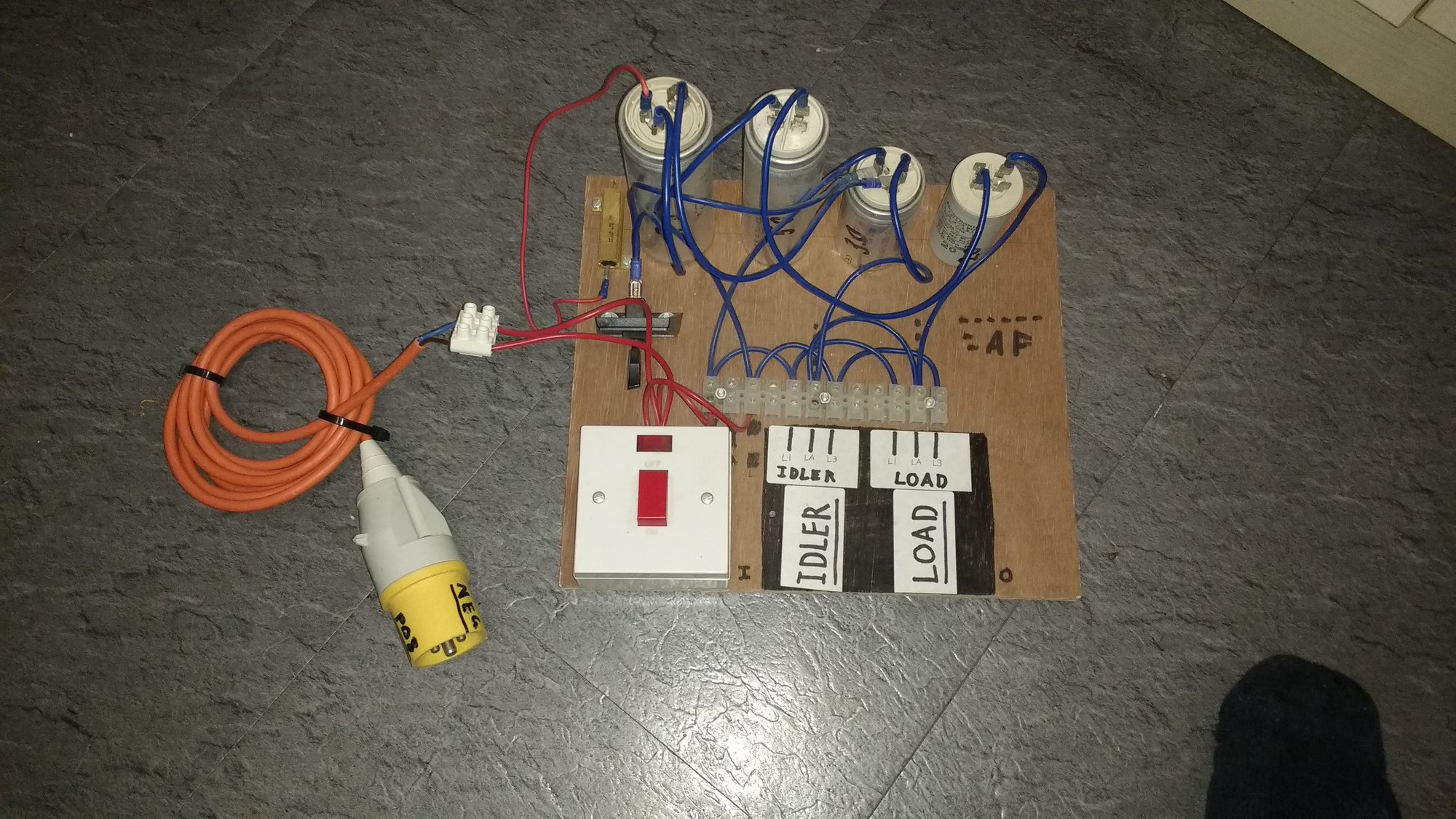

Quick estimate, while in the shedI make it 87% - pretty impressive...
Dave H. (the other one)
I make it 87% - pretty impressive... Not up with VFDs though, they're usually in the high 90s!
They also don't draw most of a kw with no load :/
@Tilly819 - have you fitted power factor correction caps to the 240v input side?
Thanks i'm glad you are enjoying them. If you ever have any criticisms please let me know.Good videos, easy viewing and I don't watch a lot! What do you do as a day job?
Yes I tool like a good video, but often wonder how many takes and how much editing goes into them. I really appreciate all the efforts others go to making them for us to learn from.A very interesting project and a great video. I wish I had the gift of getting information across in videos like you and the Boost.
A non technical observation, should the cabinet have some ventilation. Very nice job thou.

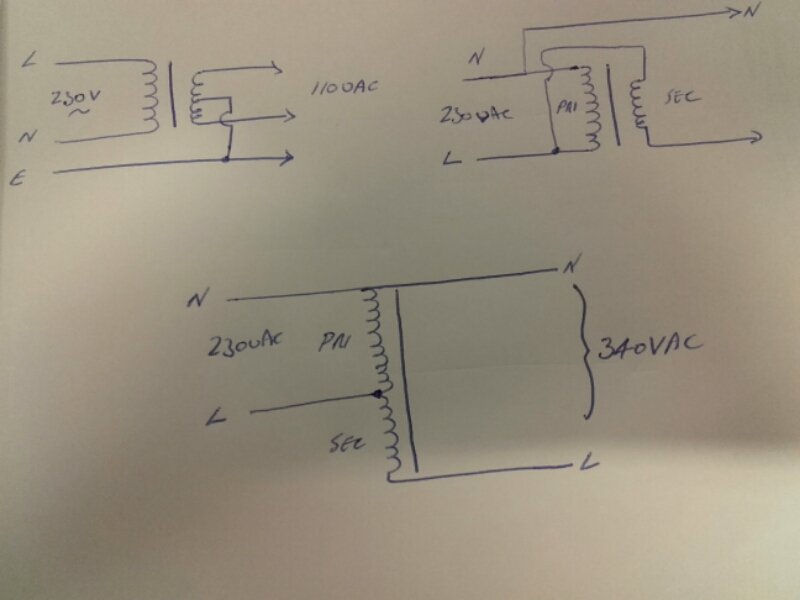

I've got a rotary converter here a clever mate made up. Uses a re-jigged 110V trannie on these lines:
That's reconfigured to be an auto-transformer. I would have expected the output to be around 450v by simple addition.
Of course, it's 110 centre tapped and not 110-0-110
They can make cracking power supplies for "experiments" though, 55-0-55 at a hundred amps goes a long way...
