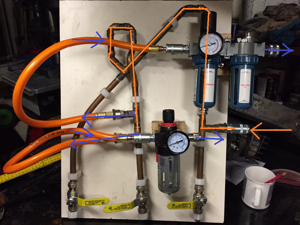

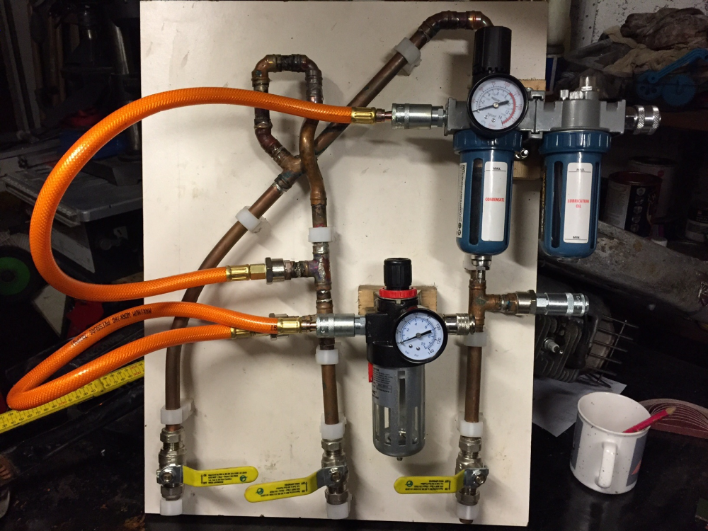

Having followed this thread with interest, I decided to make my own radiator / multi-output airline contraption.
My radiator is far smaller than the one mentioned in the other thread - probably around 50cm across - so I hope it will still be effective. I also wanted it to be portable so that I could take far from the garage to spray the sheds / fences, etc.
The objectives were;
This is what I came up with (mug for scale
It was my first go at brazing/soldering copper pipe and I'm very chuffed to report that I've got no leaks in either the soldered or olive couplings
That's a ball valve tap at the bottom each vertical so I can drain them.
The air in is in the middle / right, and the two regs (one with an oiler and one without) exit to the right, too. I took the advice of someone (apologies - I forget who) in using flexible connections to the regs.
Used it for the first time in anger today and it (thankfully) held up!
Final task is to put some fasteners on the top so I can mount it on the garage wall but still have it detachable.
If I could do it over again I would take more care with laying the pipework out prior to soldering - there are no two parallel runs on the entire board!
