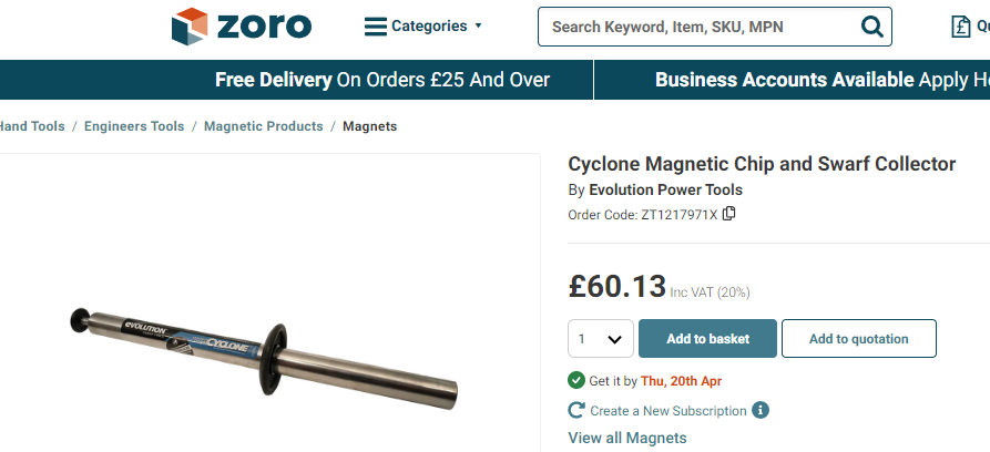

Another vote for evolution one, very handy. Whatever one you get I find it handy to stick a couple of thick o rings on as a buffer to stop it sticking to the big lump of metal your trying to pick up the little bits of metal from. Good for rolling it about the drip tray on the lathe, still going to get stuck to the casting if you get too close though
