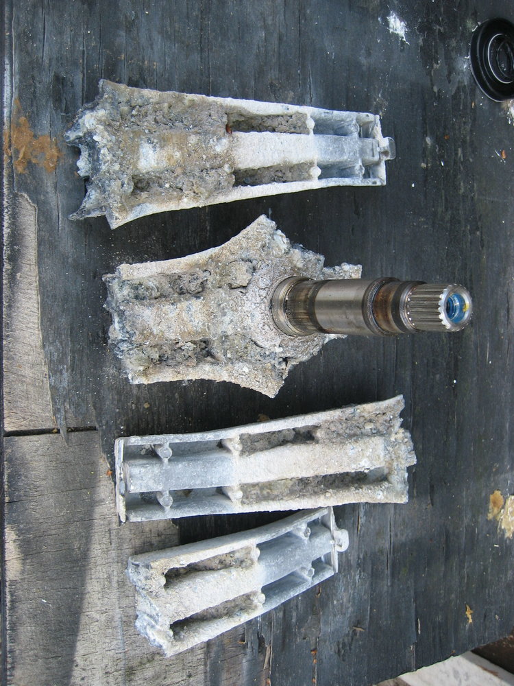

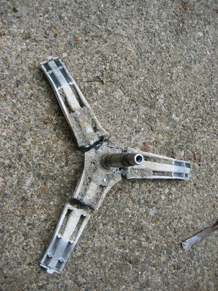

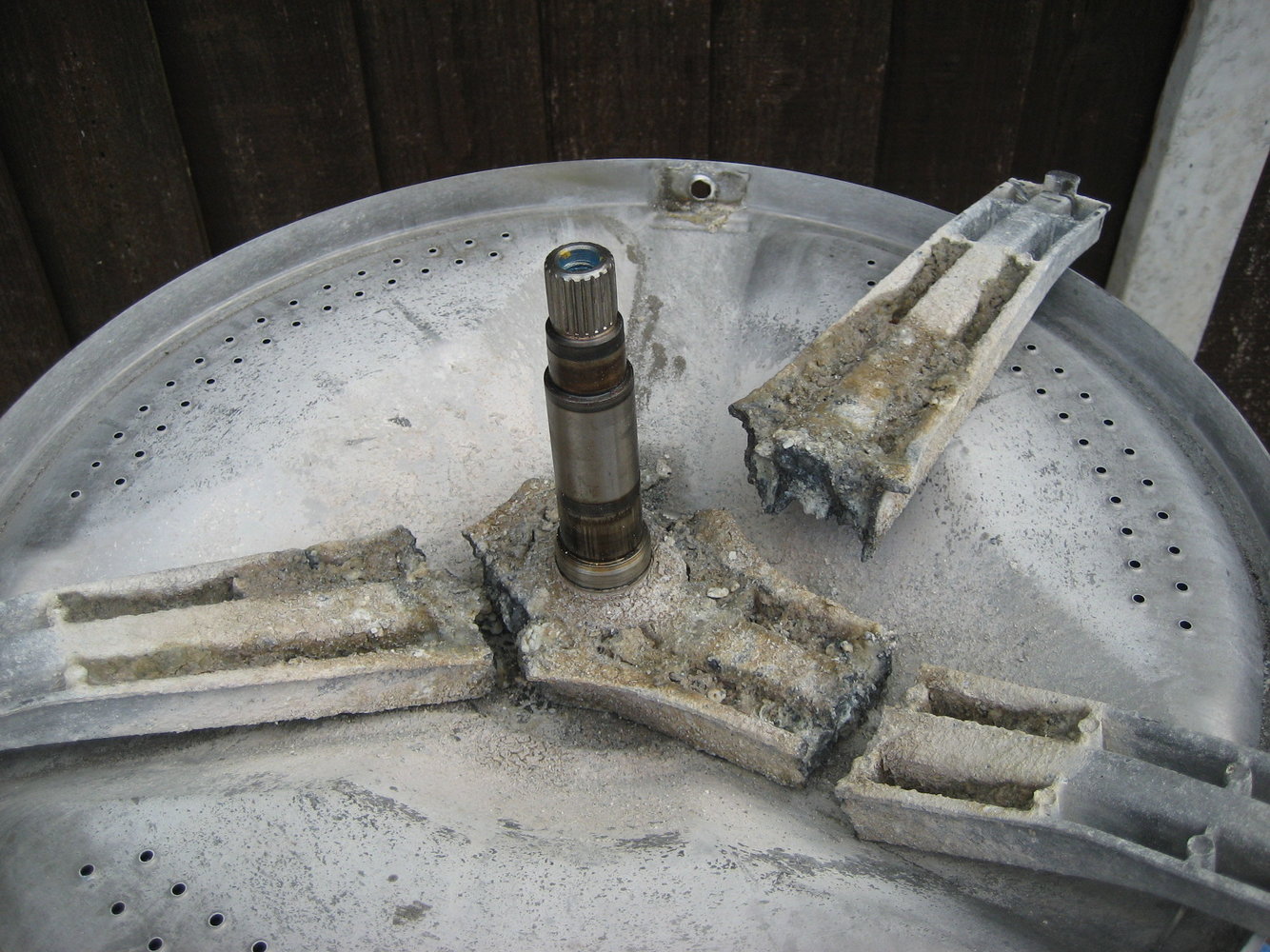

Wife said to me - the washing machine is making a funny noise!!  So it got stripped down ...here's the culprit ...I've fixed a fair few in my time but these 'spiders' are new to me.  The bearings are actually perfect but the spider isn't..
It's a Samsung so I searched for a new part and got prices ranging from £55 up to well over £100 ...ended up ordering one from France via DPD £27.00 delivered!!
Hopefully end of funny noise .....
  ) I'm fixing this for about £30 in parts.  I may paint the new spider as I do think this is a bad design being plain alloy....
