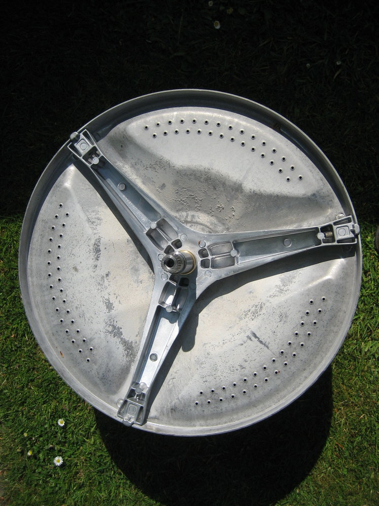

It’s the detergent that causes the corrosion - it’s very alkaline, a bit like weak caustic soda. Not good for aluminium alloys. Best painted with an etch primer first, then maybe some alloy wheel paint from Halfrauds.

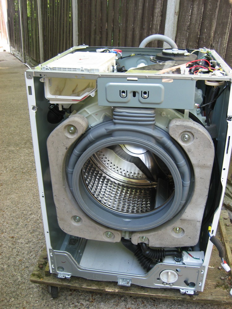

Pretty straightforward re-assembling it but it's a heavy beggar to maneuver back into it's 'hole' in the garage!!
