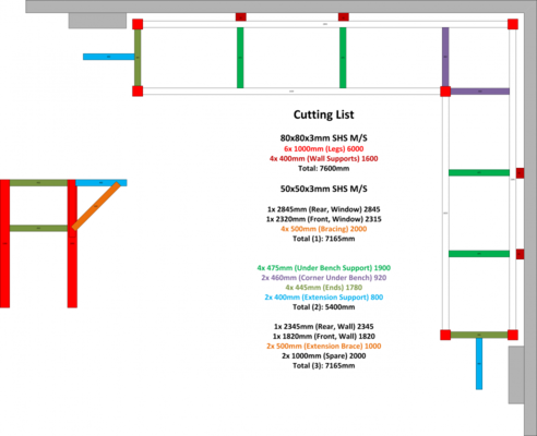

In what way Mike, too heavy and over spec'd or too light?I went for 6 and regret it
Very true but didn't you once say you bent your 30mm bench surface? Would bracing that have helped?The material section size is not always the most important thing. A lot depends on how you frame it up, where you put bracing, leg ties etc. Its all about making efficient use of the material.
Very true but didn't you once say you bent your 30mm bench surface? Would bracing that have helped?![]()
Just make sure you add some stiffeners. 90 degree to the table top. 3mm will be fine for home use then. You will be surprised how stiff.Thanks, i'll stick with the box. It's not going to be heavy work so I think I'll go between 3-6mm. Cheers

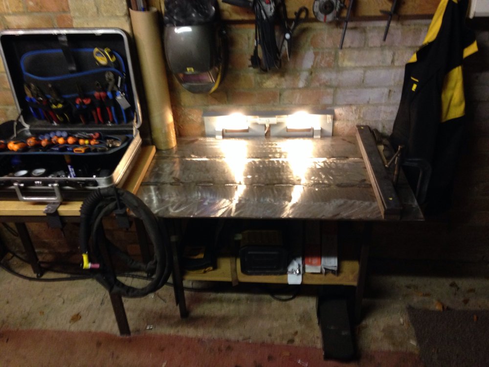

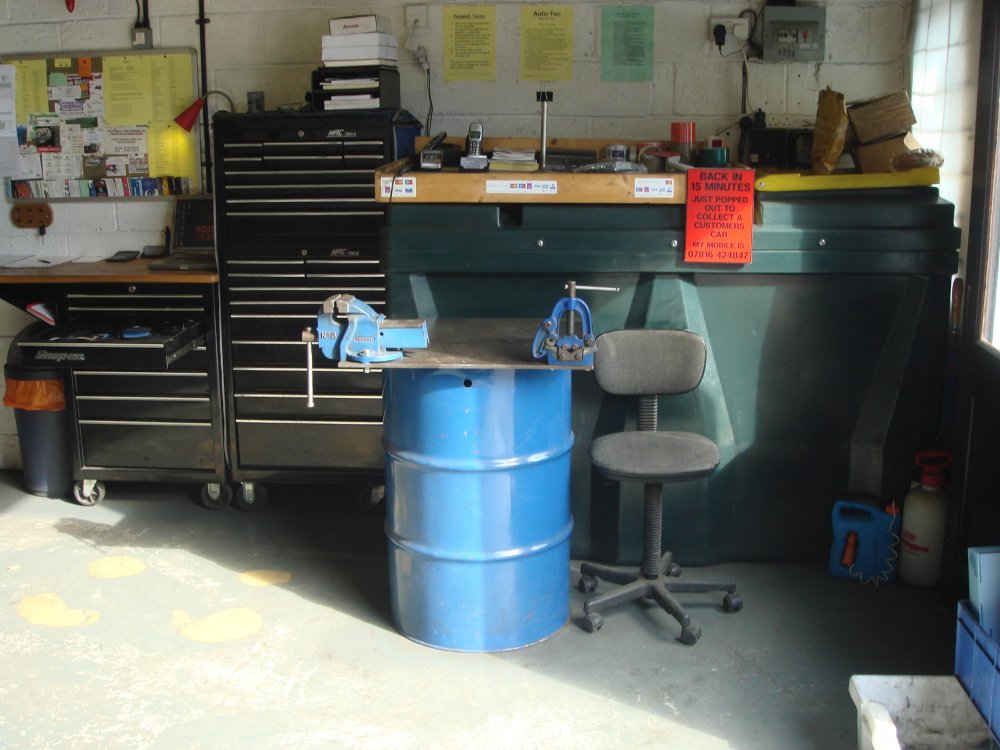

Here is my little one I use at home I used 40x20x3 for the frame work and legs. My top is 10mm thick although 5mm will be fine. I like that idea.Oil drum half filled with sand with 10mm plate welded onto the top!
Very easy to "tip up and roll about"
Plus they are a good height to work at!
I have two... One with vices bolted to it (as pic) another for welding on.
The bonus with this design is, you can G-clamp things to it from every side (for welding positioning)
