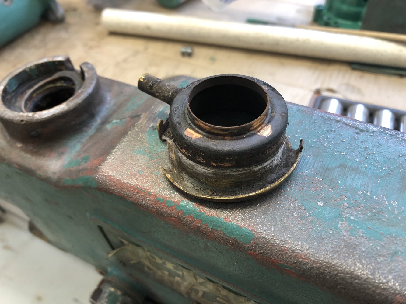

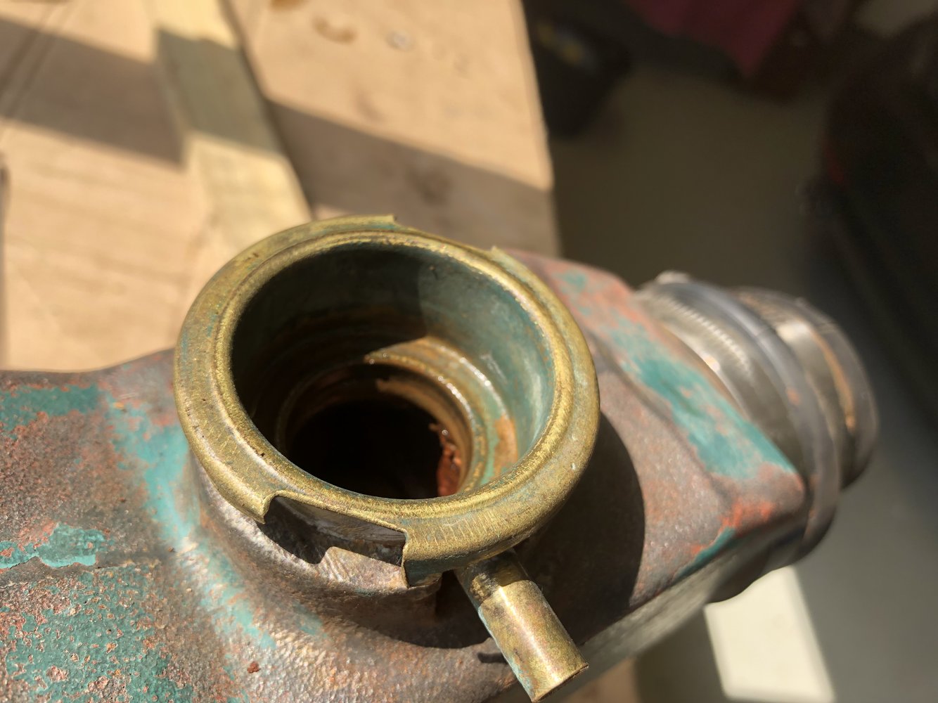

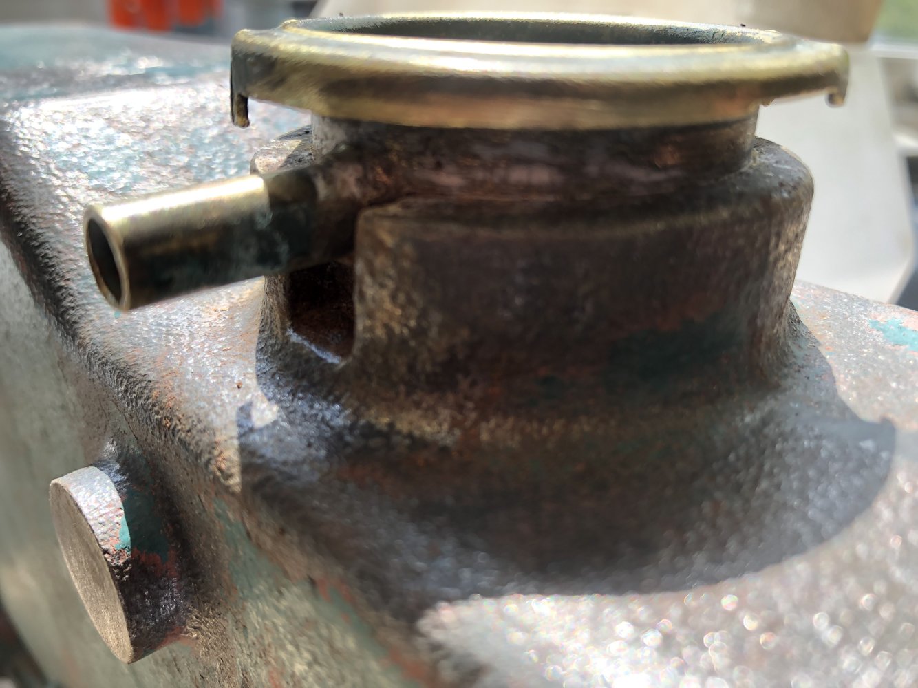

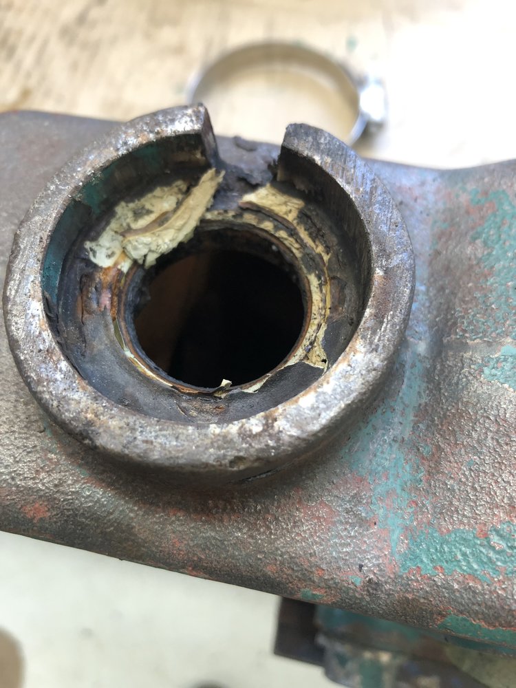

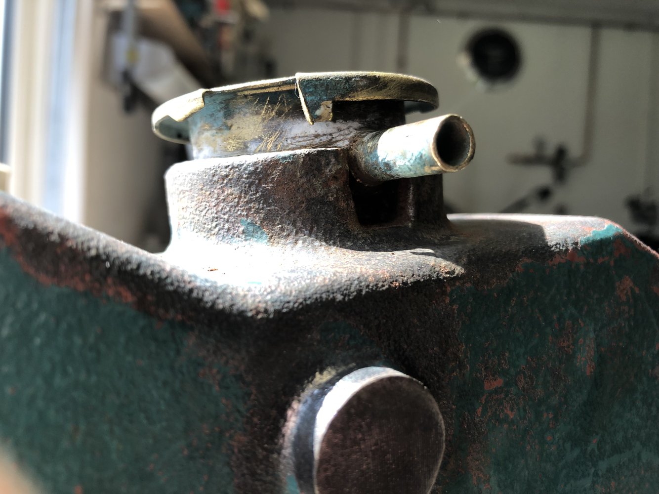

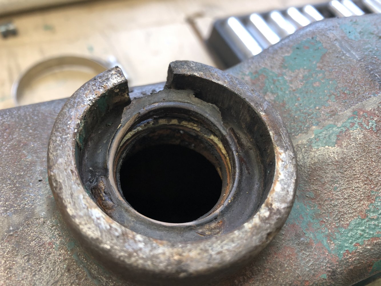

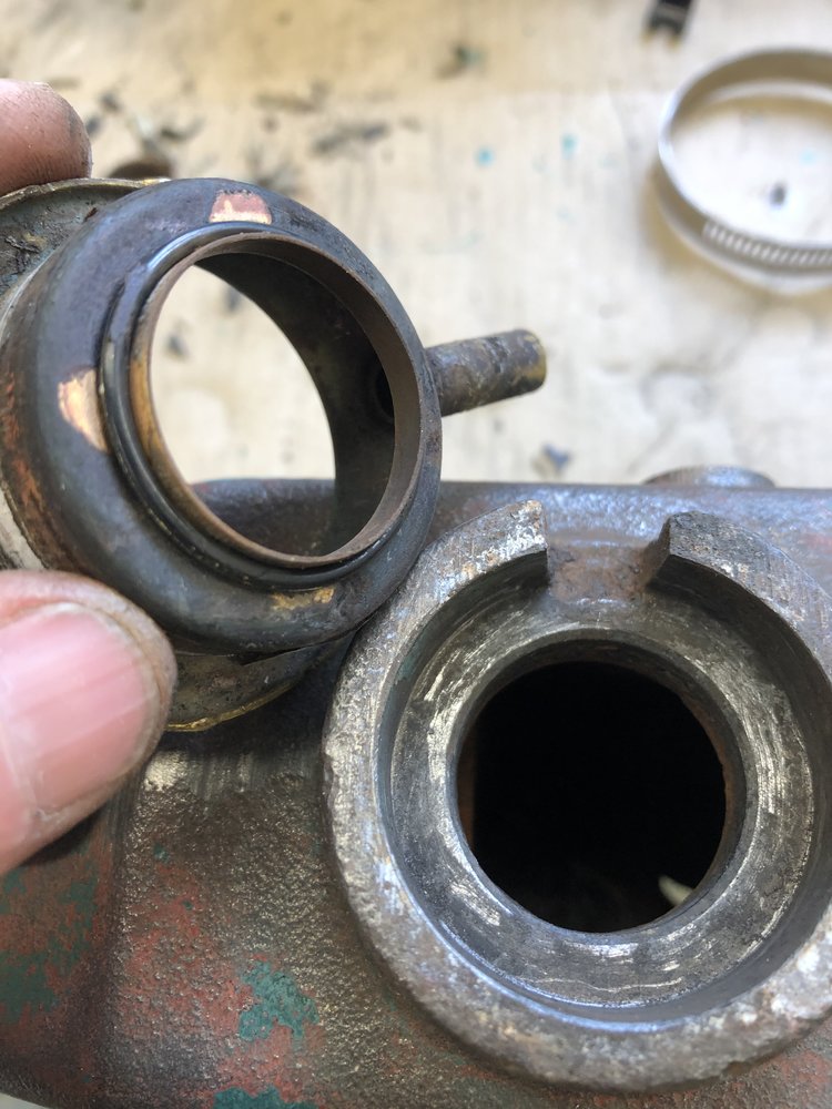

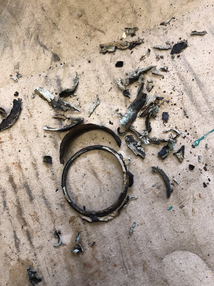

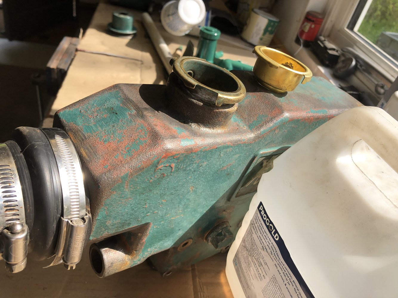

I'm trying to repair a cast iron marine diesel heat exchanger which has a standard brass radiator filler neck. I suspected that it was leaking for some time so removed the complete unit and had it pressure tested locally by a radiator specialist, and sure enough it leaks where the expansion pipe comes out of the neck. The original hasn't been soldered in and they weren't to keen on trying to solder it. The neck has been sealed into the casting with some kind of putty so I was looking for a recommendation of a suitable product to use. I've bought a new standard brass neck as I suspect the old one won’t come out without damage. Dimensions of the replacement are identical. Any help much appreciated.
