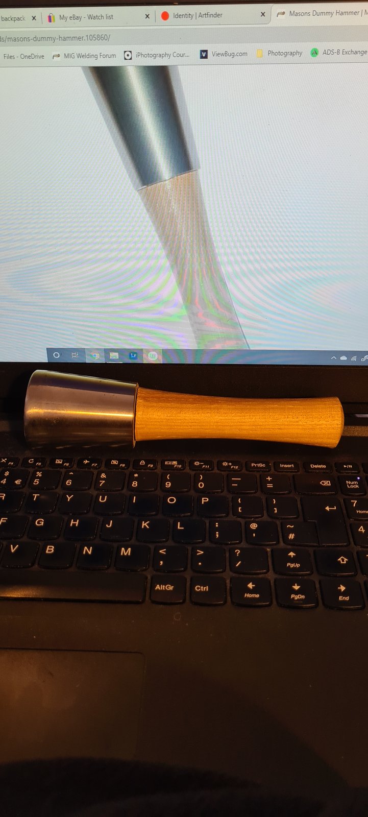

Pestle, mortar would be the challenge.A nice easy project.

If I had to make one it would be heavy tube weld capped and shaped with grinder.

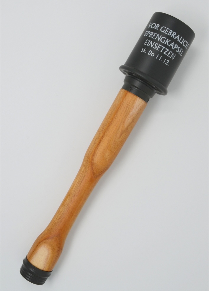

It looks more like a German throwing device used during WWIIlooks more like a mace

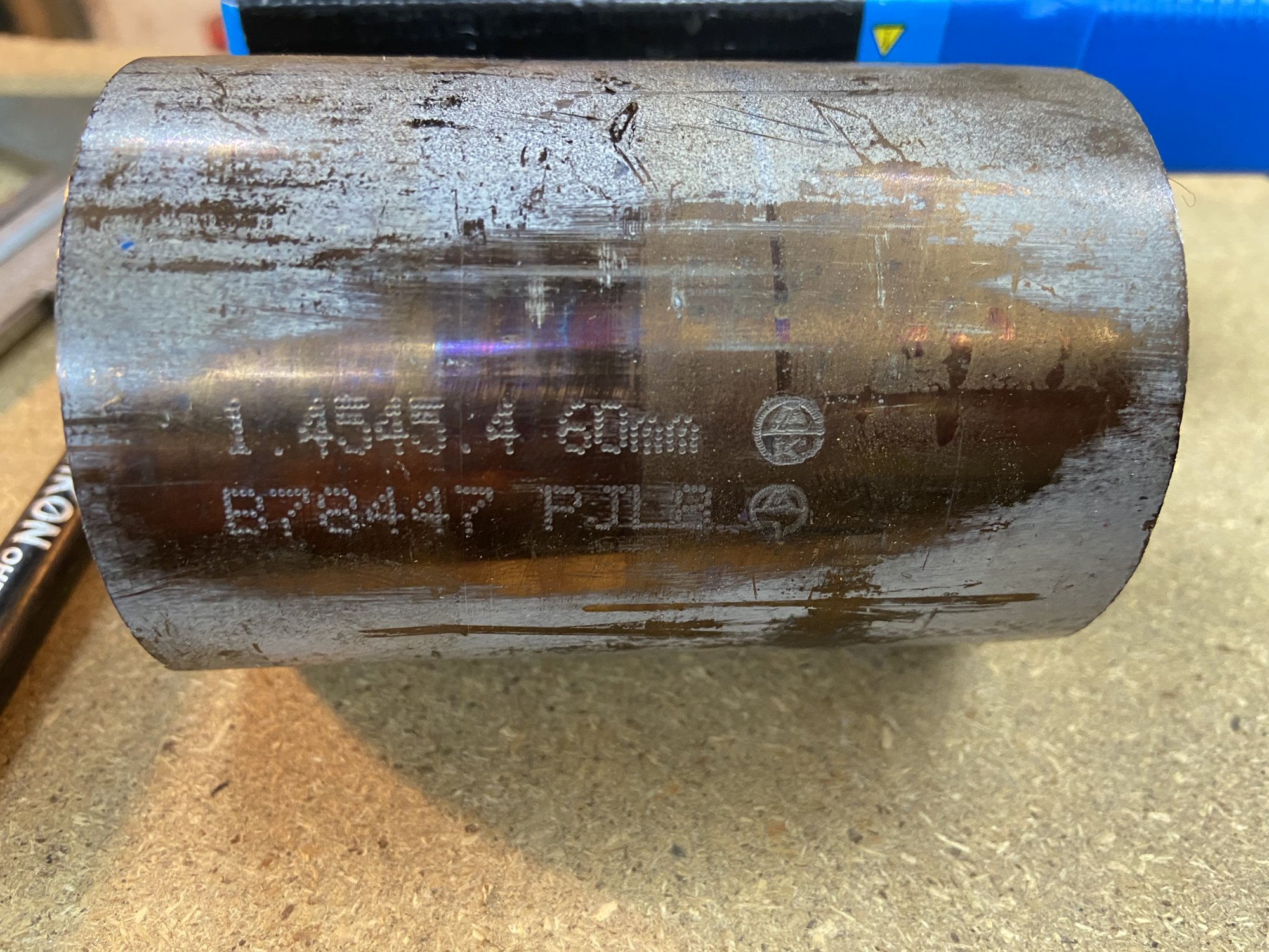

1.4545 is a stainless steel I believe?
Should look great polished up

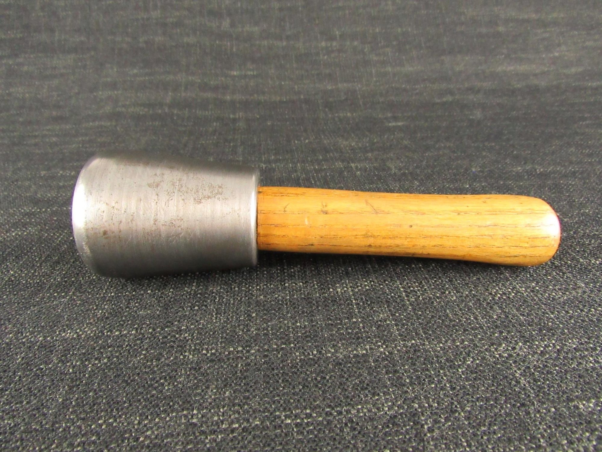

We use en8 or brass, and it takes a few minutes a head you've kicked the arris out of your boring, the handle on mine is 30mm where it meets the head, I would guess the hole is about 16mm, but its opened up to about 20mm at the top for about an inch so when the wooden and steel wedges a put in the handle spreads out and holds the head on.
