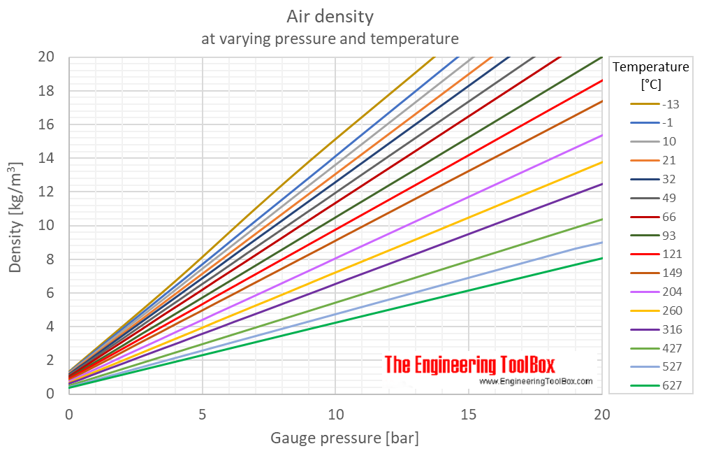

Not a problem with air as it's compressible and also low mass. Certainly not at the flow rates involved anyway.have a little read up on 'water hammer' and consider if the same thing could happen in your set up and the consequences if it does.
could you cover it in pipe insulation would that help ?
Water Hammer is not generally a problem with compressed air systems because air is compressible
Kinetic energy is Ek = 1/2 mv2The reason I suggested he think about it is if he has 8 bar of air at full flow through the line (maybe he is blasting) and then closes the valve, will the pressure spike come uncomfortably close to the 12 bar rating of the pipe?
