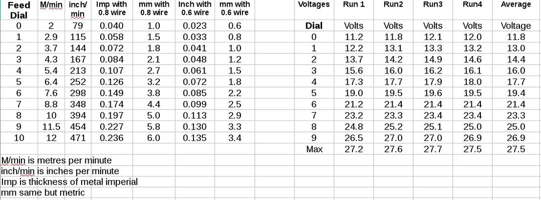

I recently bought a R-tech 180, being new to this welding lark I have no idea what settings to use.
I've got the Miller calculator but I need to find out the voltage of each setting to use it.
What is the best way to find out the voltages at each setting?
