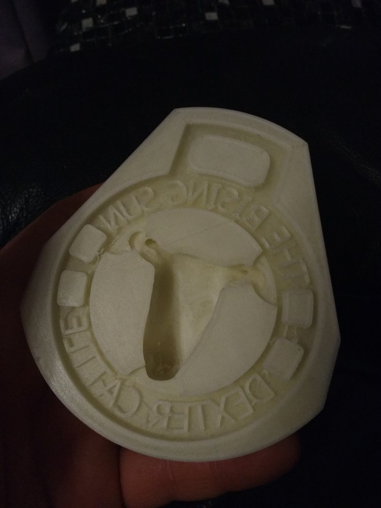

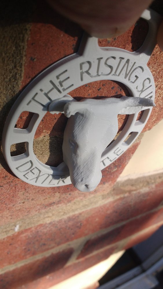

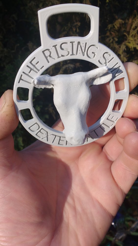

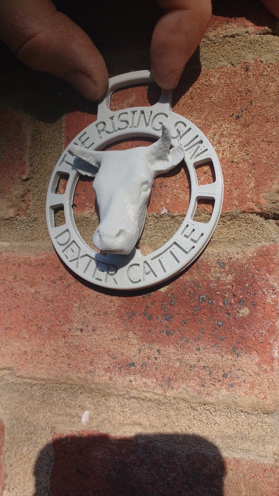

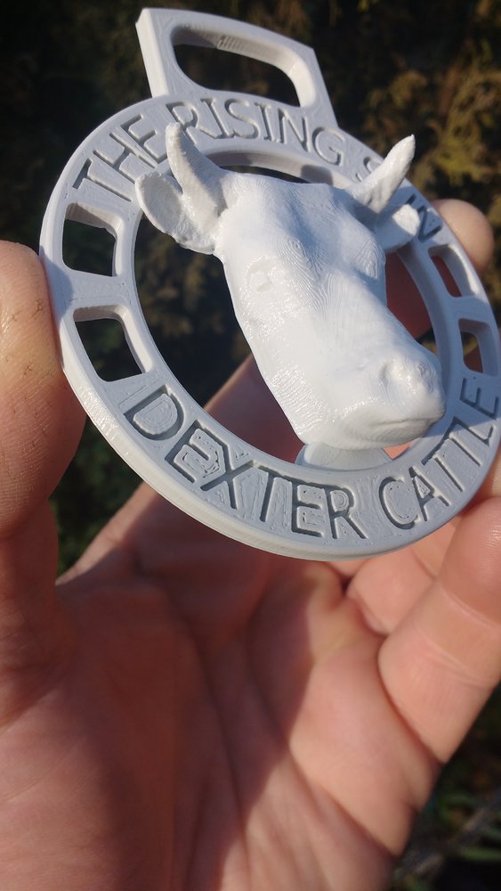

Light grey, RS PRO PLA printed at 0.1mm layers. I would say markedly better, quality wise, than the fibre silk brass effect PLA. Certainly around the ears / overhangs. I'm not even sure tbh if he used supports it's that clean (I was in bed when it was printing).
I was tempted to give it a dusting over with a primer / filler spray to fill in the odd pinhole. Thinking not, they might come out looking like age marks in the brass.

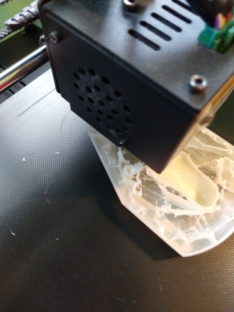

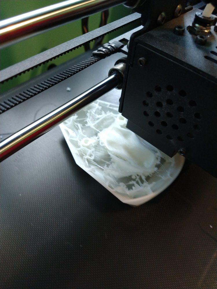

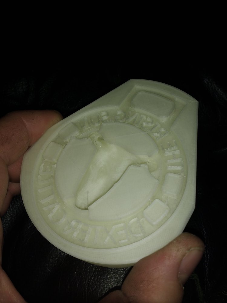

A single ice cream cone printing now. Then the triple cone job, then the PVA female which I'm oddly excited about trying...

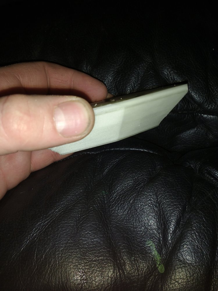

unless you're happy to try what we've done? Too light and they become very flexible.

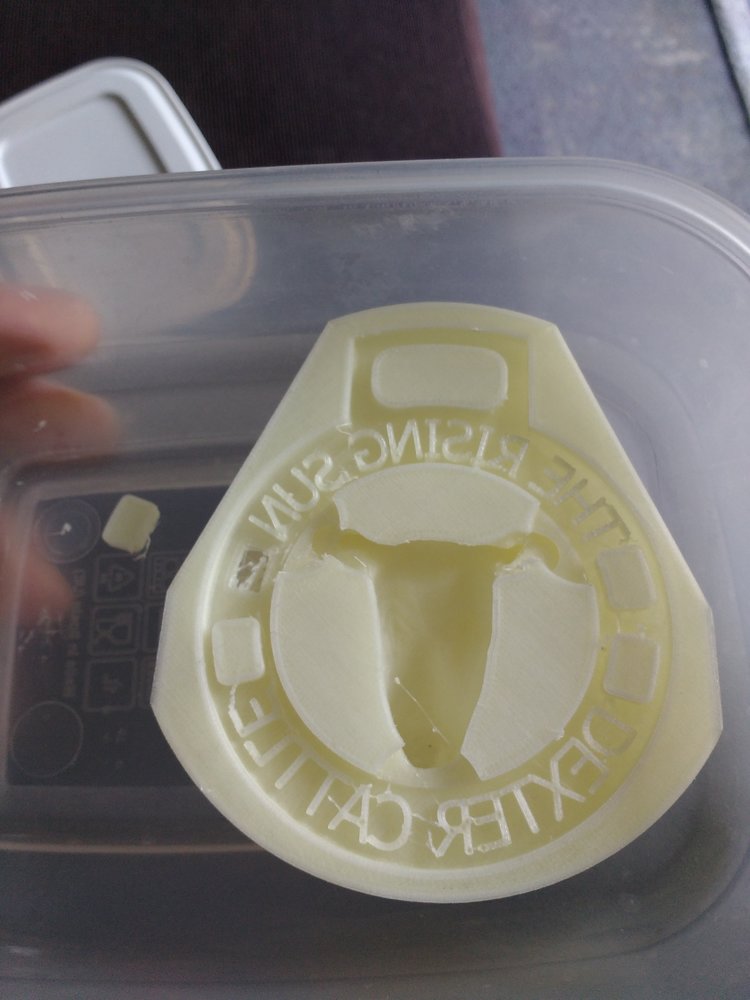

The pva mould looks great!
