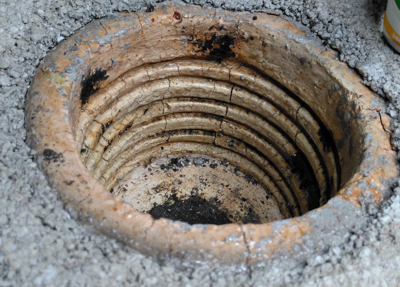

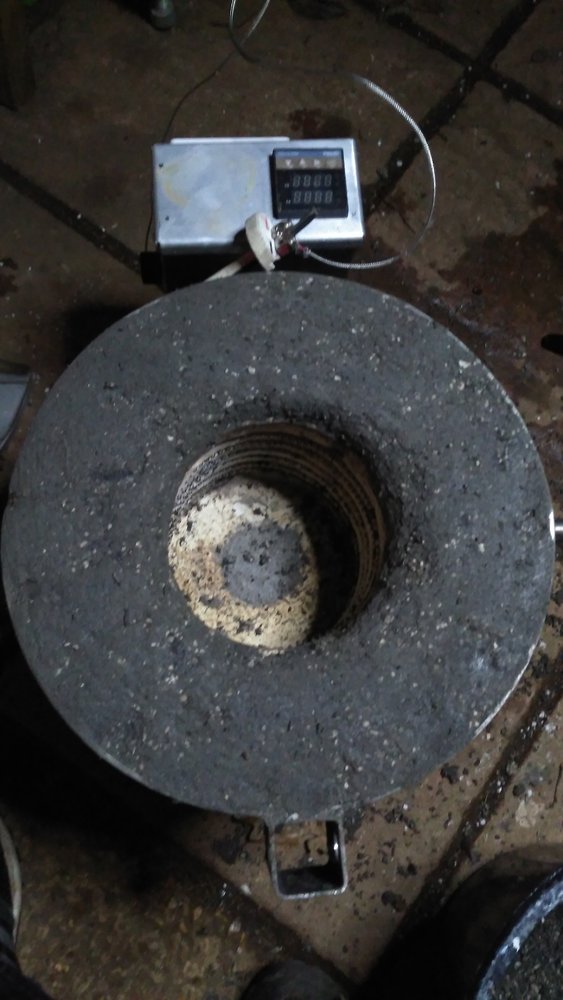

Can you not pin the element into the groove - needs to be done on an unfired Kanthal element as they go very brittle once fired a few times.The element needs to be retained better!

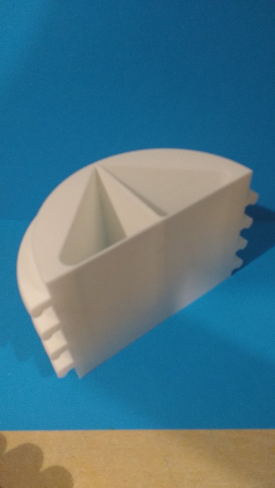

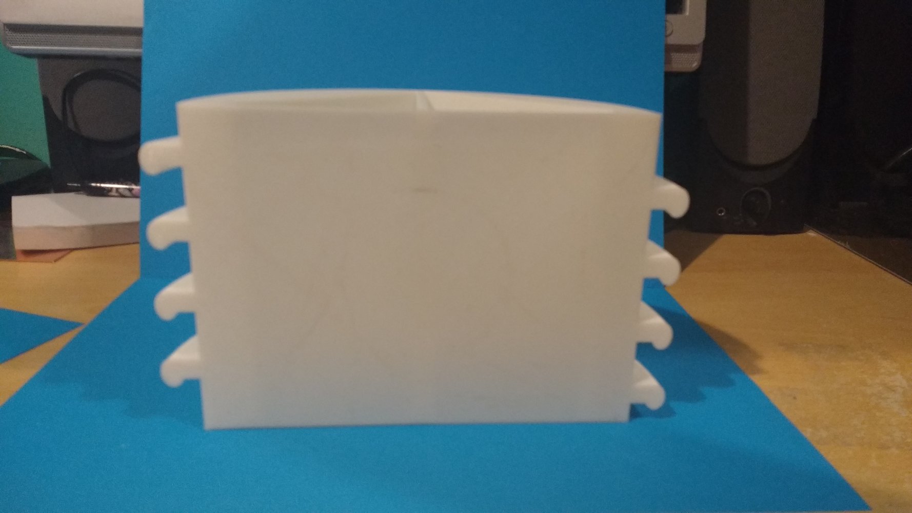

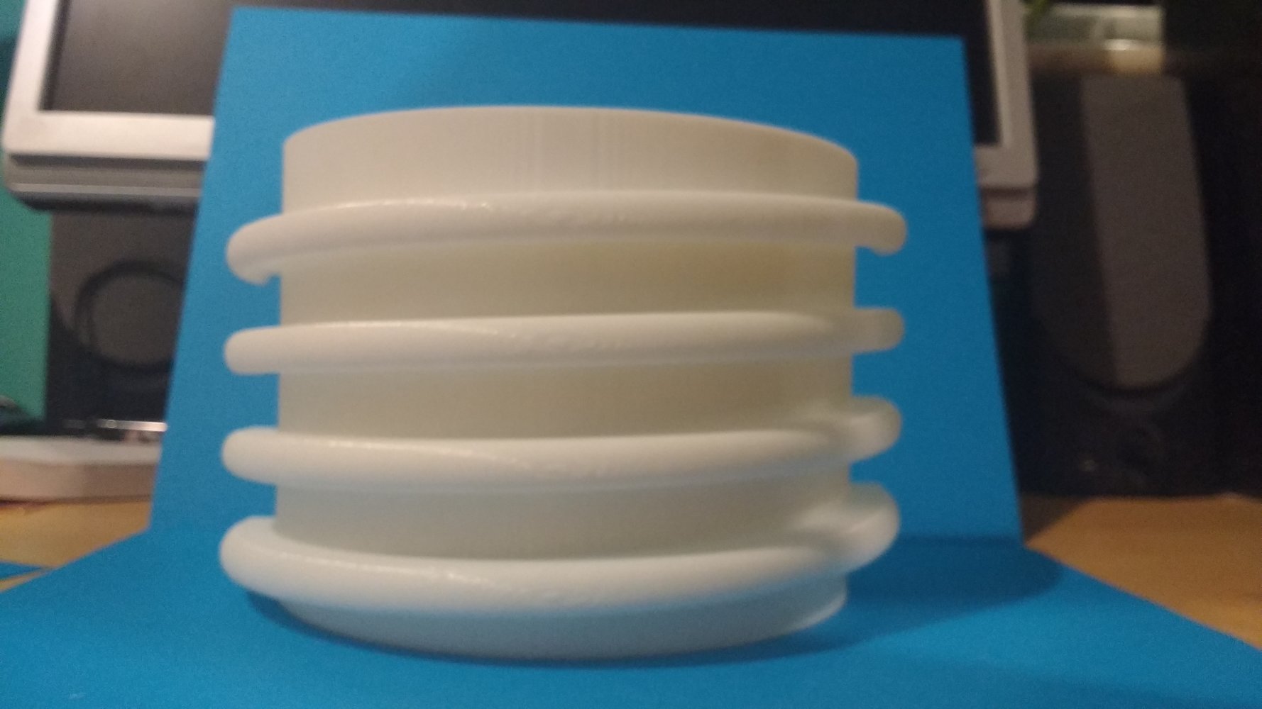

Plaster has a few issues. Hard to get all the water out without it going crumbly. Aluminium is ok bit brass is on the hot side. My first attempts (years ago) were baked for ages and still had a mini steam explosion. If you use plaster I would give it a thin coat, possibly using sodoum sillicate instead of water, but make up the bulk of the mould with casting sand. I havent tried it, might not work.Right then, someone recommend me a plaster of Paris type...plaster of Paris that I can pour over my 3D print here to make a mould for brass casting.

They do and I knew that, yet still stretched it a bit after a few fires to get a better fit.Can you not pin the element into the groove - needs to be done on an unfired Kanthal element as they go very brittle once fired a few times.

You should use investment plasterRight then, someone recommend me a plaster of Paris type...plaster of Paris that I can pour over my 3D print here to make a mould for brass casting.

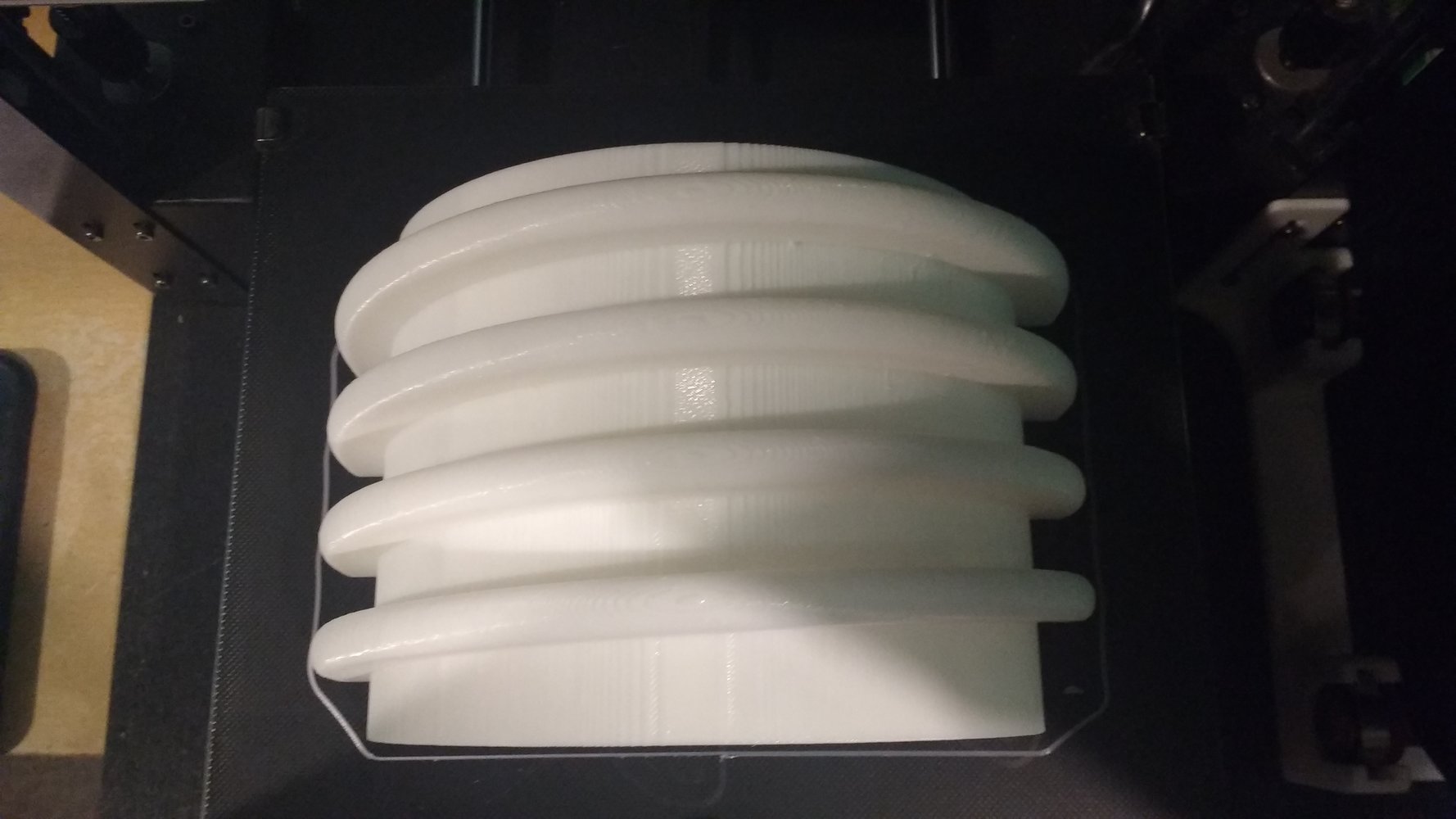

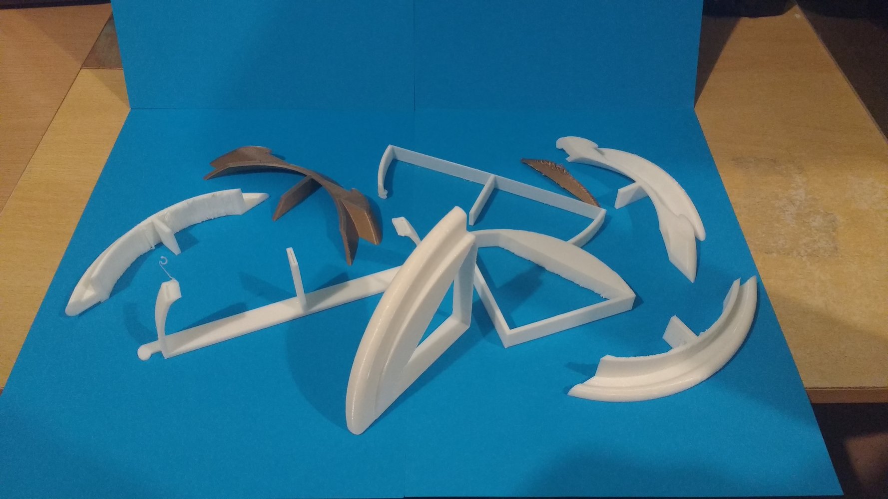

Lost PLA casting works pretty much the same as lost wax.
There's lucky![]()
As someone said above. The Veg Oil Guy is the UK expert on YouTube..I see it as an investment.
Seriously, never knew the stuff existed. Off to Google the lost PLA method now.
He has a playlist on lost PLA. You'll see why my next welding project is making a burn out oven![]()
You just need a hole in the top and bottom of the oven to let fumes out or your elements get destroyed.Ive read that you need an oxygenated /open oven, to convert carbon soot into CO², such that it can burn out. He has a comparison and PLA is poor bit other videos he had good results. Id think better to print a negative mould and make a lost wax positive. Moat of the wax can be collected and reused.
Are there no FDM printers that can extrude hot wax?
Got the element out, the new one prepared, gave pot a coat of SS and now looking like this ready to install. This time Im going to use element wire offcuts to retain it.

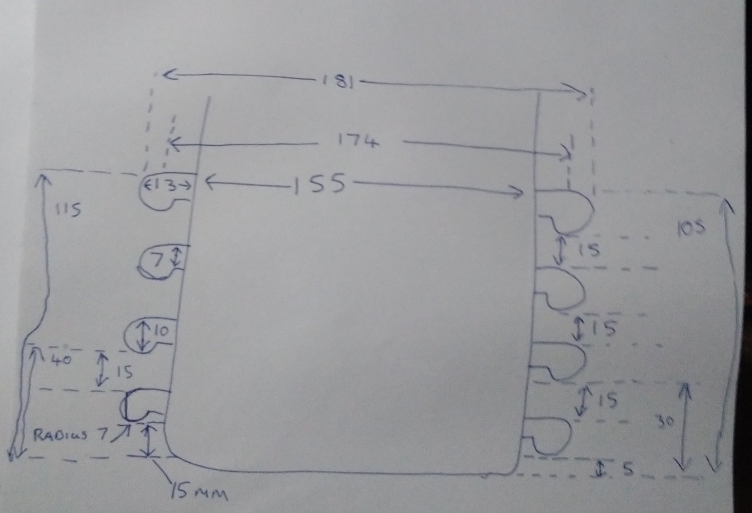

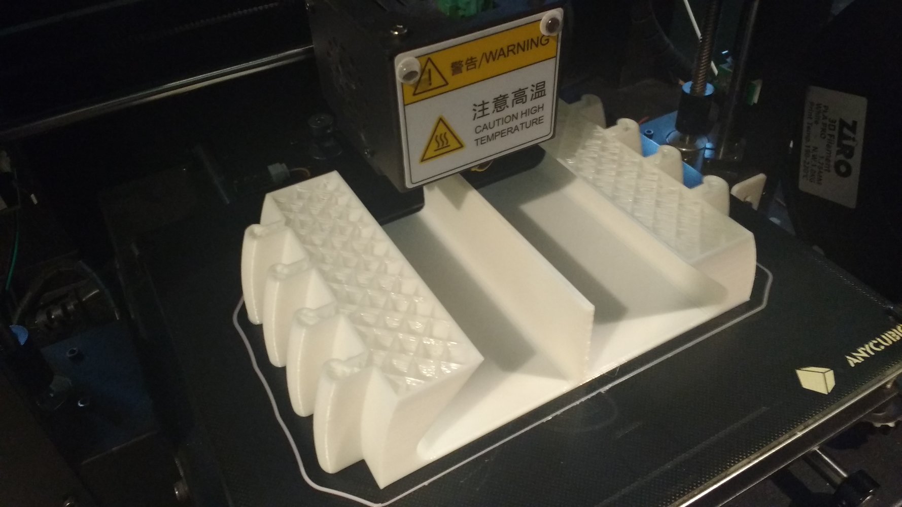

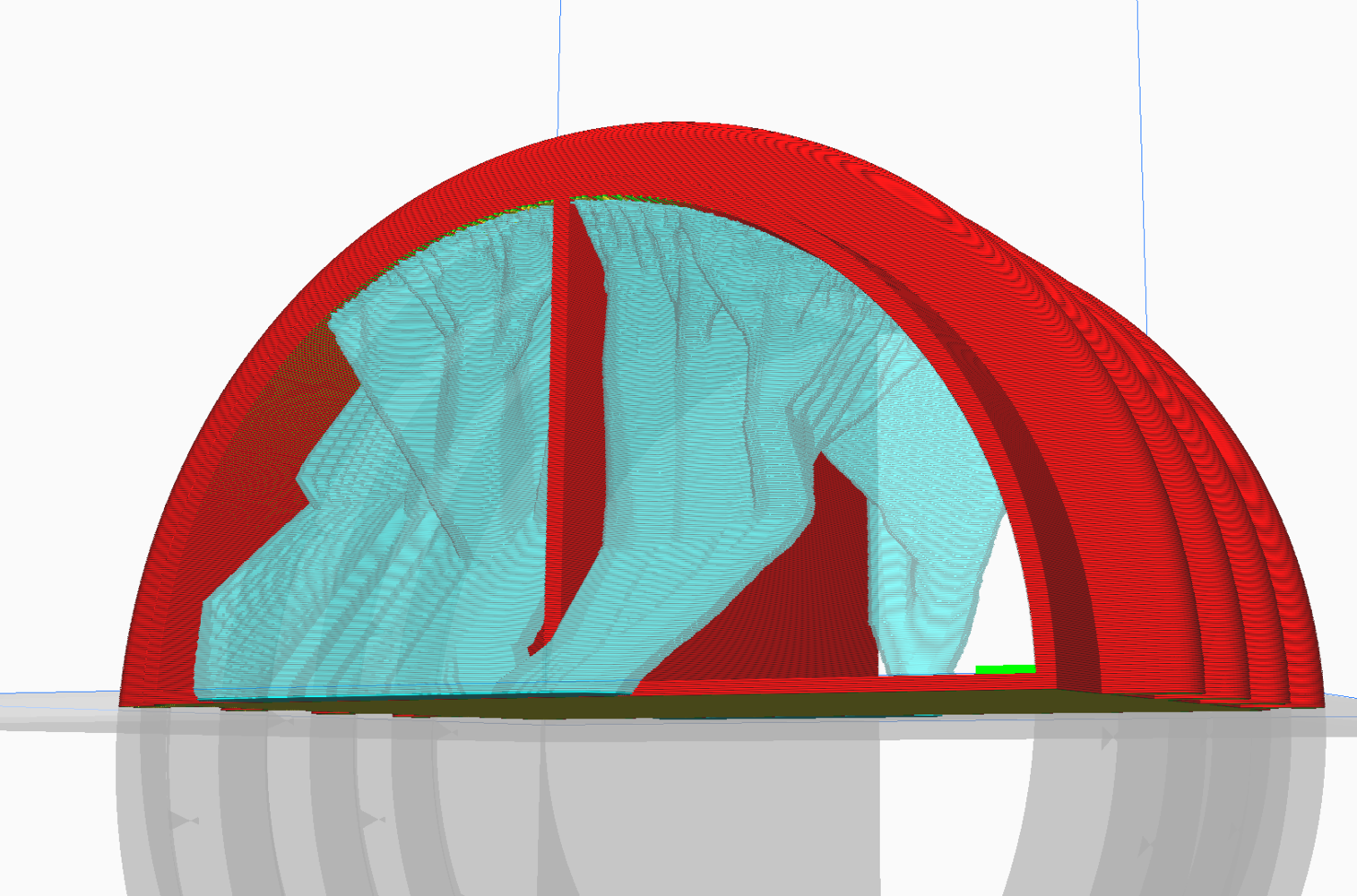

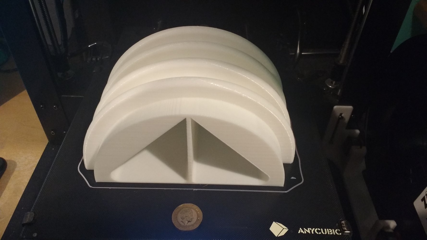

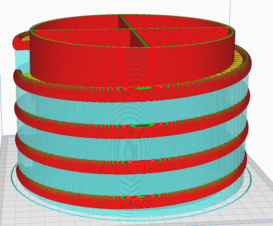

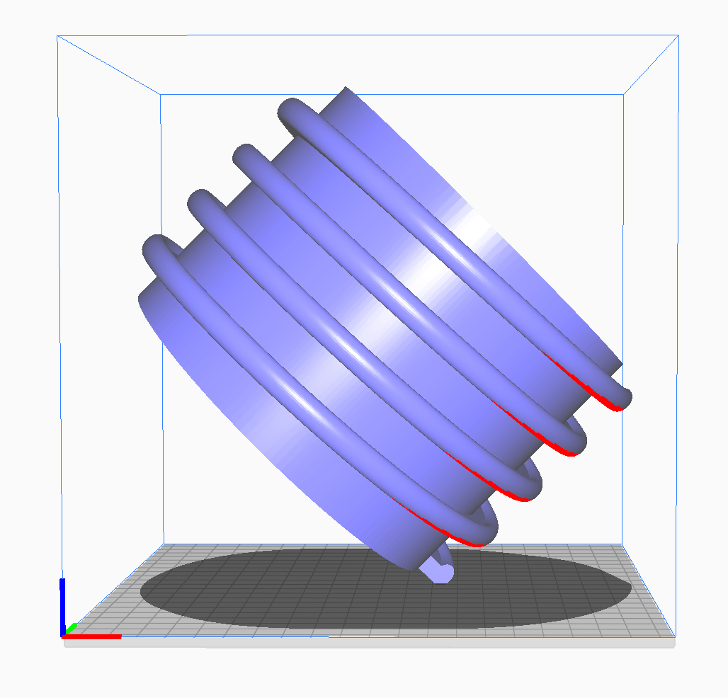

Here is a sketch of the paper variety, if thats ok? It will not be removable so, needs to be the minimum fill just to resist crushing while forming the clay, and will be burnt out as part of the drying.That was my idea post #1!
Give me a sketch and we'll get straight on it here.
I have enough clay for a couple if you wanted one made up. The element for this needs to be stretched to 220mm which is about right for most on ebay/amazon. *They need to be annealed before stretching*, light stretch then run off an SCR to get it red/orange hot for 30 seconds.
