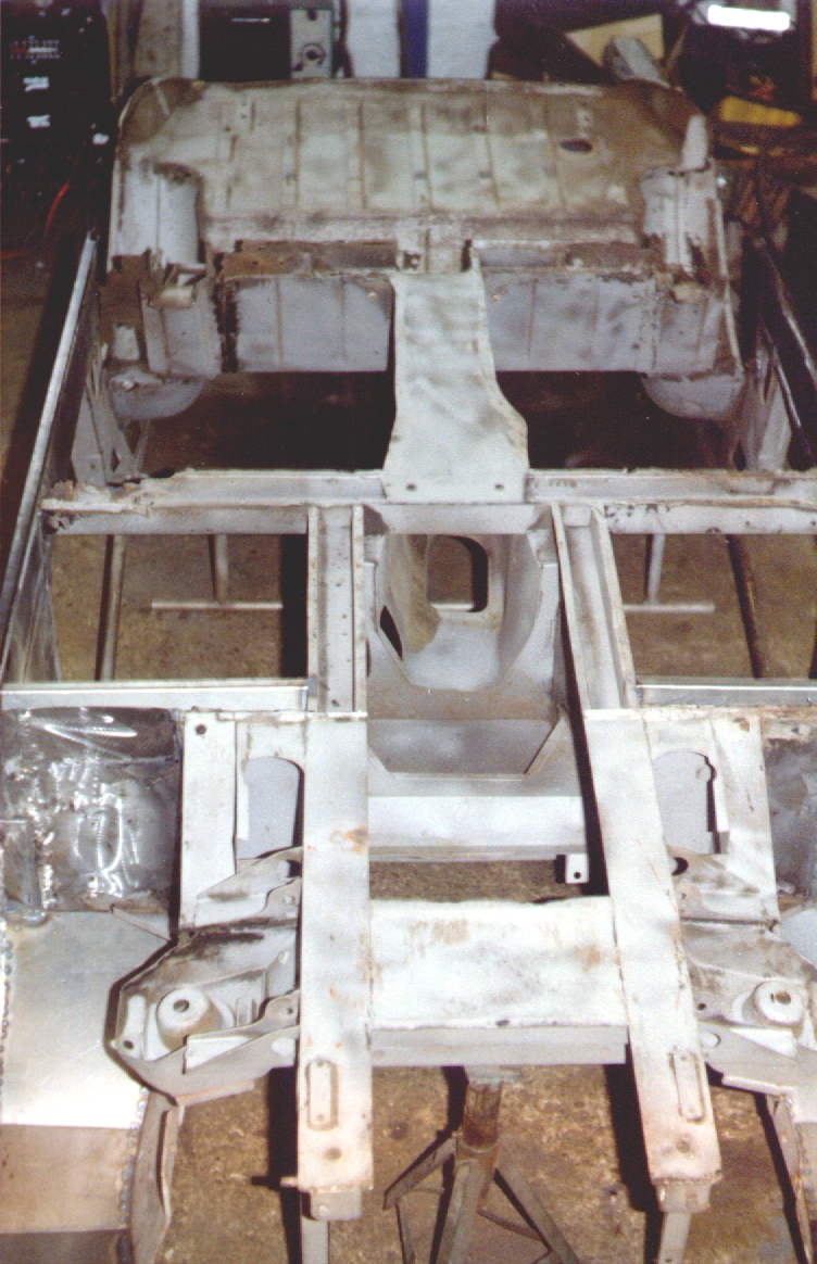

false floor?
You sir are a very brave man.... I often wondered at the mentality of people who bodge things together really badly and tart it up with isospon(other brands are available) and sell them on to people without a second thought of how unsafe some of their
practices are. Big round of applause for you
for putting this together the right way

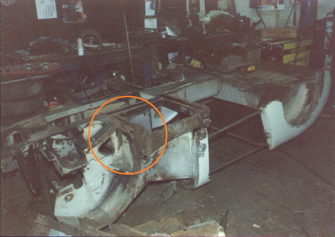

There is an angled plate, behind the wheelarch, you can make it out on this photo, it makes a triangular cavity between the floor and the wheelarch / bulkhead, you can make out the flange on the bottom
Can see what's left of it here too
