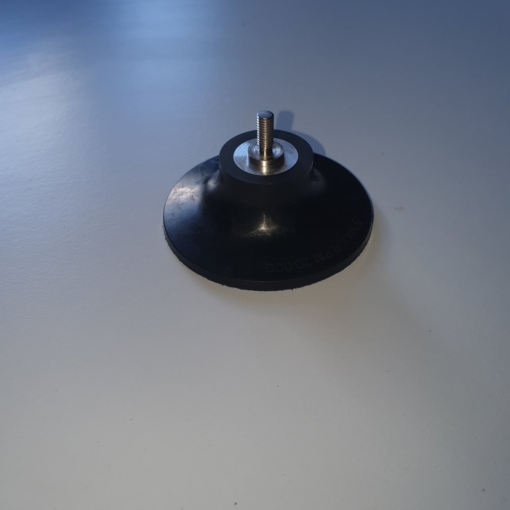

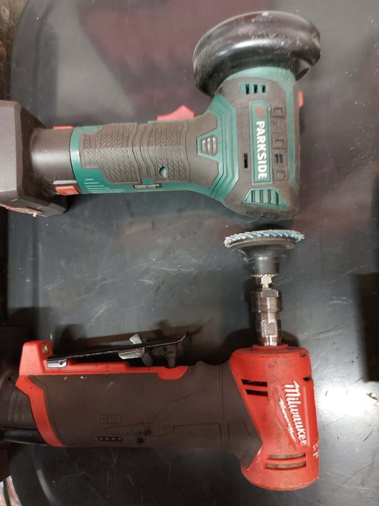

Does the roloc holder literally just screw into the cut off tool head, any link you got would be ideal.It's what I use, the lidl 12v cutoff tool, with a roloc holder from ebay.
The brushles ones are better, but lidl don't do one yet.
They are with a 75mm disc. 50mm have a lot more torque. Plus remember you are not trying to cut through a panelI have a lidl cut off tool which I use as intended cut off only. Its a little weak if I'm honest.

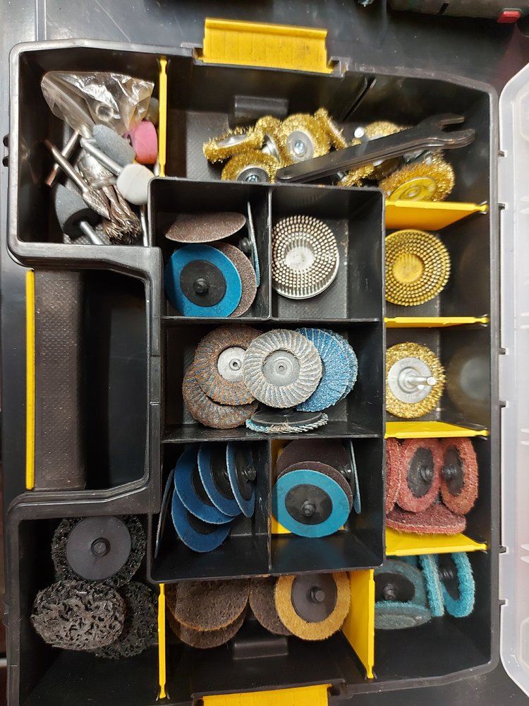

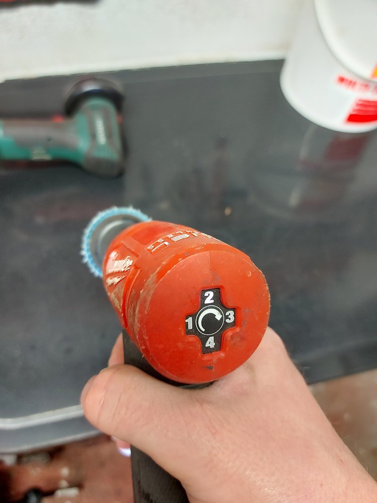

The M12 Milwaukee one I have is fantastic. Lots of power. I keep a storage try with all the attachments. It is invaluable for me restoring cars.
Any recommendations on what bit and cutting discs for the m12 die grinder?I have a lidl cut off tool which I use as intended cut off only. Its a little weak if I'm honest.
