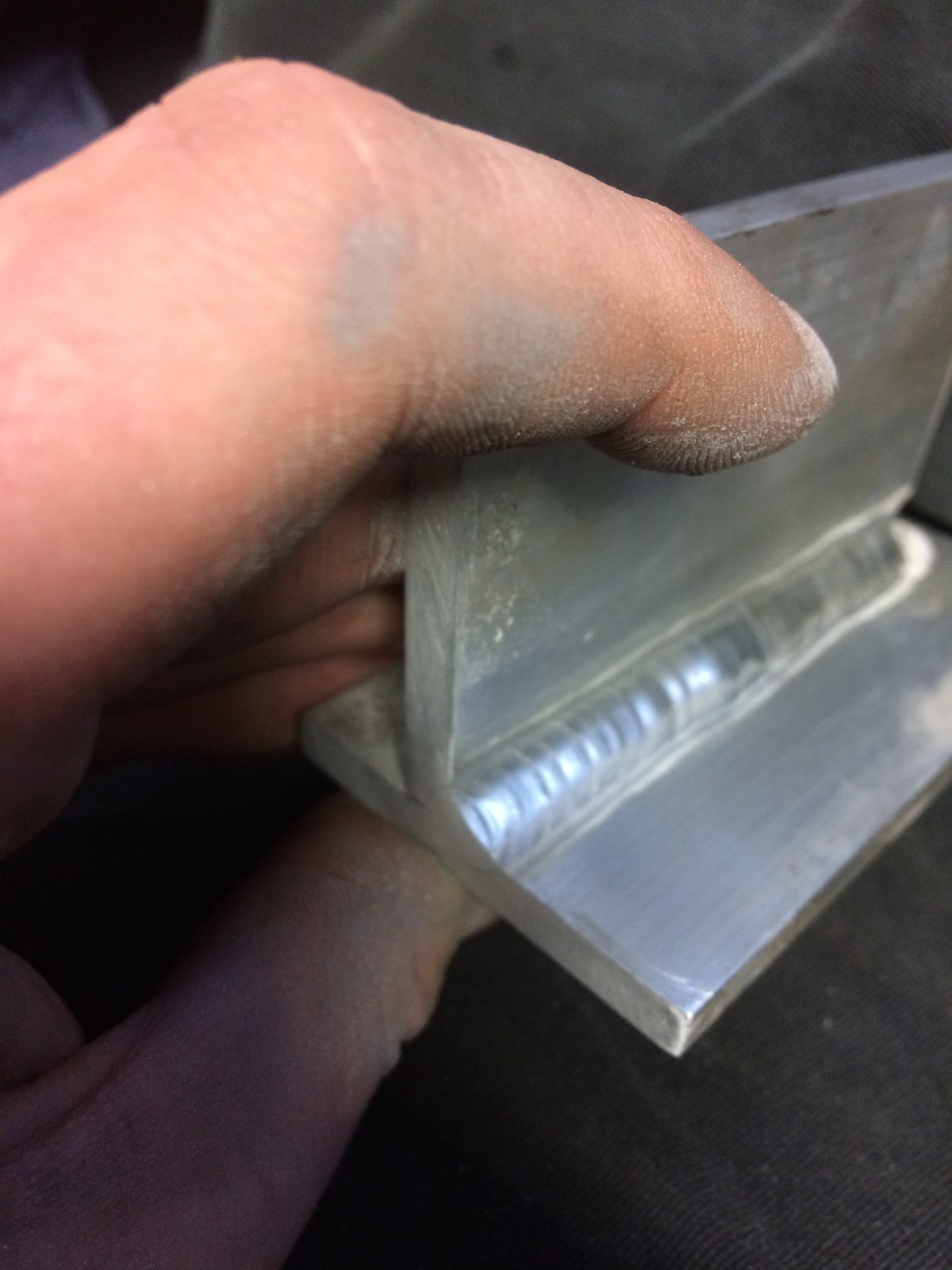

Yes, I think probably single pulse would be the same but on such a small part the speed is killing me as I am not getting comfortable. The Superpulse just slows things down a bit so I can get into the swing quicker.Double pulse has got great pen right in the corner.

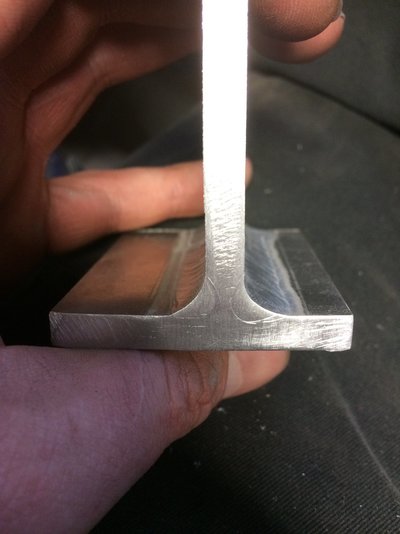

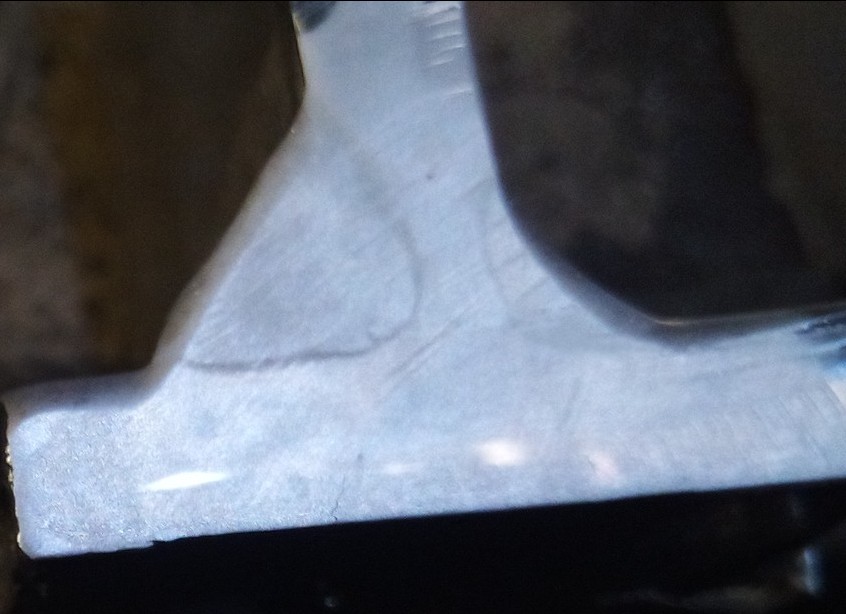

Nice even pen and unlike me you have it spot on in the cornerDouble tig 190 each side allowed to cool between runs.

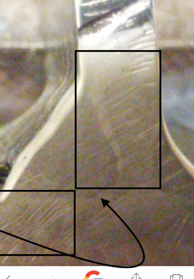

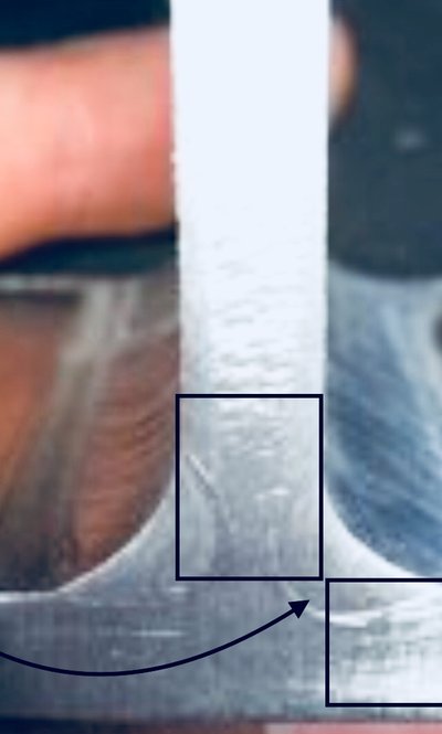

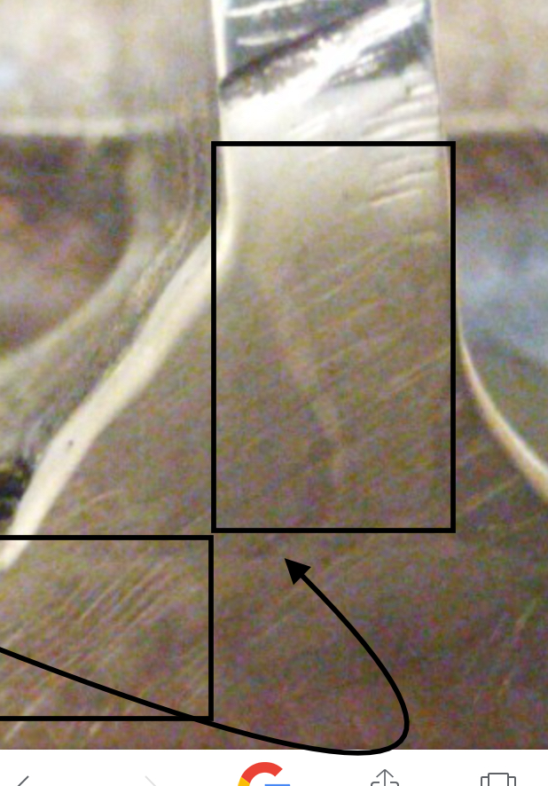

85%/15% balance and 100hz to get the focus into the corner and keep balling to a minimum was the trick there.Nice even pen and unlike me you have it spot on in the corner
Your tig has hardly touched that one. No reinforcement either.Ok last from me.

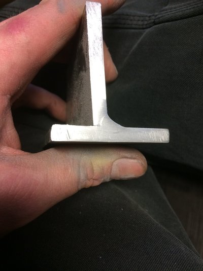

Mig set to 5.5mm/152Amps but +1 on voltage and +1 on focus, in other words where I would normally be set.
Tig set to 190Amps, 20% and 70Hz.

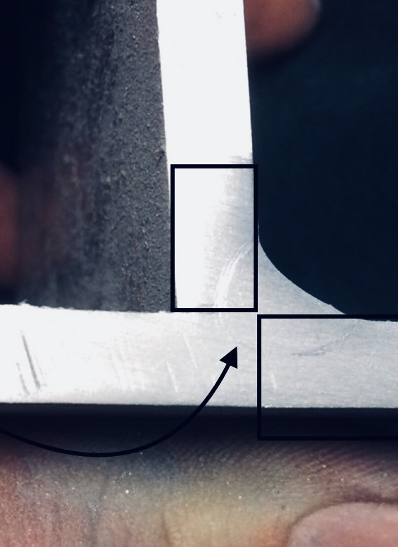

Using the polishing mop rounds the edges so maybe I should try just with a finer grit wheel on the angle instead so that the edges of weld and plate are square.

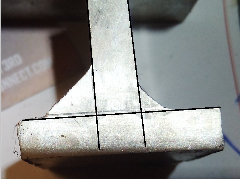

Too high a current for my liking to be honest.Your tig has hardly touched that one. No reinforcement either.
