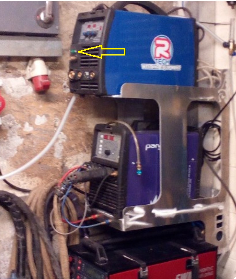

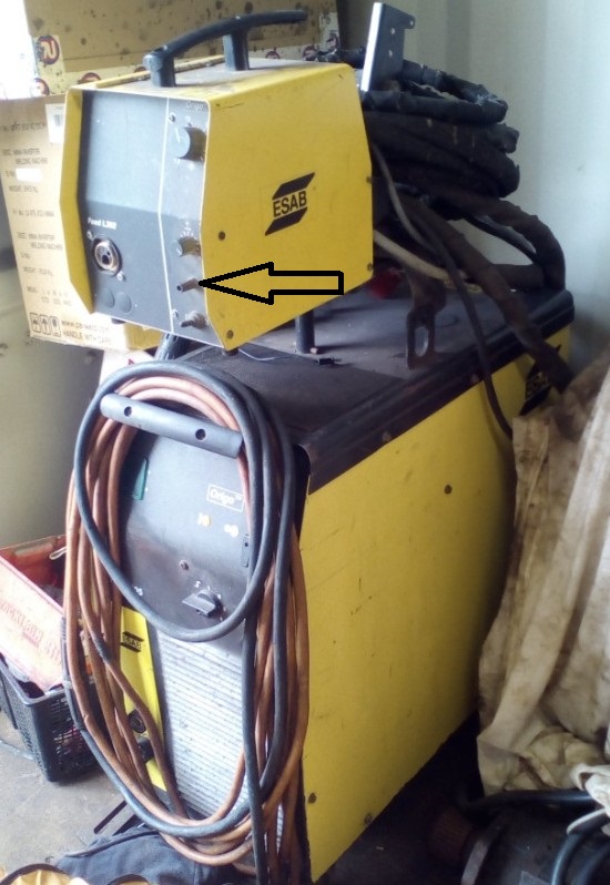

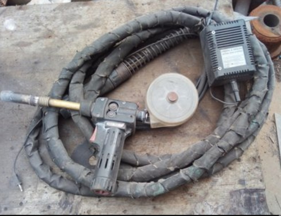

Yes, also a connection from the inline box to the return leadThe inline spool gun... just needs a standard euro connector or ?

Next move was a spool gun, back in those days they came with a PCB that had to be fitted inside the welder or wire feed unit but what a difference. I continued with that setup for a good while but eventually the gun wore out so the next one I bought was a TecArc one with the inline control module, much easier than having to fit a PCB inside the welder and also meant you could use on any Mig (within reason) that had a euro connector for the torch.

be a bit quicker especially if you fit the same sort of socket as hood has done.
You can get spool guns with gas solonides as well so if the spool gun socket also disabled the migs internal solonide (use a headphone plug?) It would even save you swapping gas over.
A spoolgun would be better than a pushpull for your circumstances. Well under a minute to swap between steel torch and spool gun and quicker than swapping dedicated torches as no wire to pull out spool gun and no rollers to swap.Depends what you are doing I suppose, it's not a quick job to swap, even if you have a second torch with a teflon liner and tips fitted.
Swap the wire, swap the rollers, swap the gas, change the settings and feed wire through...
A spool gun would certainly speed up a change over but if you swap everything, weld aluminium all day every day for 3 days, then swap back to steel its probably not even an issue.
My problem is I don't know who is going to walk through the door and what they will be wanting sticking so I have dedicated one for alloy. I would put the time in to set up the spool gun if I had a big job for it though
