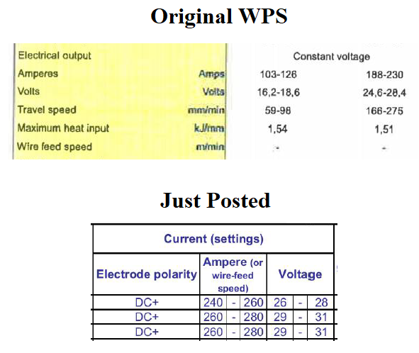

It wasn't meant to be a brain teaser.@Jack Ryan I don't really understand your question. because you say that only the current is given.
it is a semi-automatic welding machine.
you may weld GMAW and FCAW.
ampere is indicated.
voltage is indicated
heat input is indicated.
etc etc etc.
can you explain what exactly you mean?
Current is specified but you can't directly set current, only WFS. I realise the current is what is important but you would have to set a WFS, strike an arc, and read the current displayed on the machine. Obviously, a current readout with a hold facility is required plus some trial and error. It would be more straight forward to specify a WFS (along with the other settable parameters).
Things would be different if current were a settable parameter. OK, the WFS control may not be totally accurate, but neither is the current readout.
A (closed loop) synergic program is also out of the picture because adaptive control would conflict with the specified program.
That is why I asked what the machine was. I was curious if the current could be set as a parameter or if trial and error was required.
