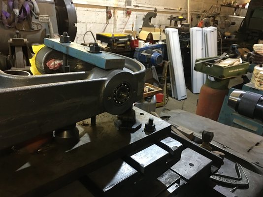

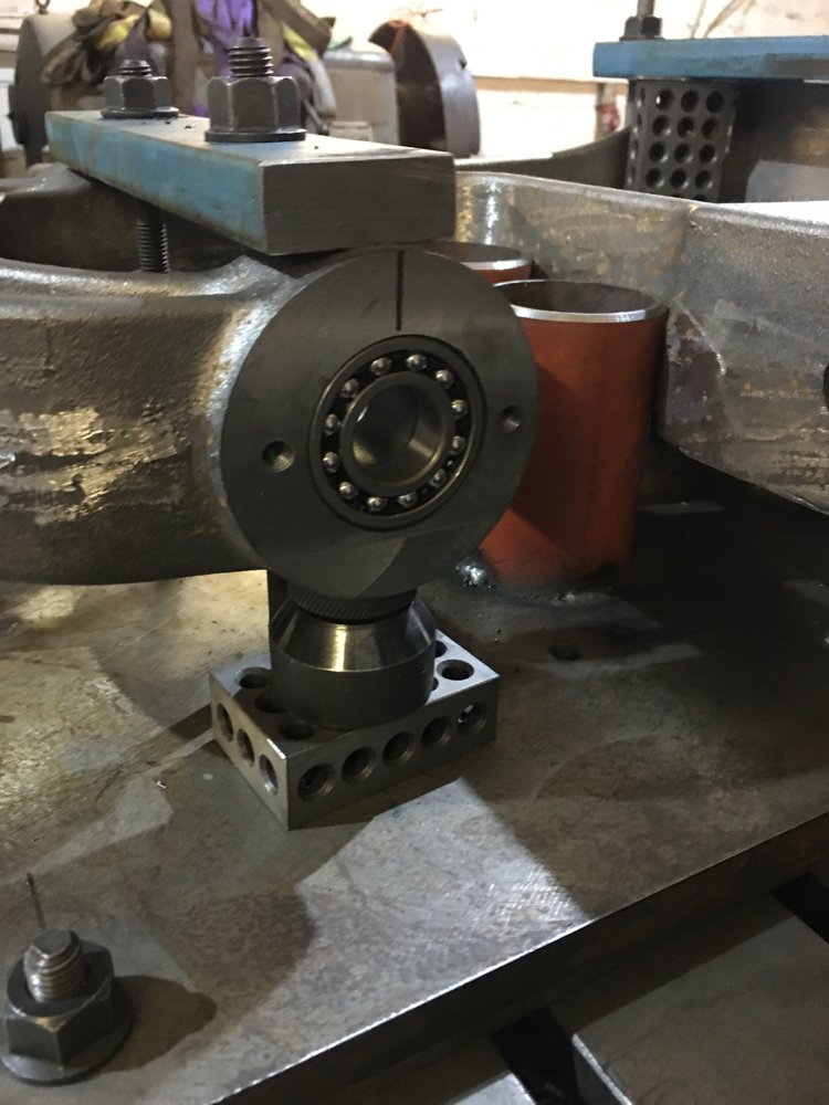

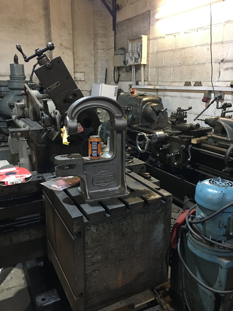

Theres no going back ,, quality is always quality , once one '' that will do '' creeps in , it starts to spread and if compromise isnt in your nature doing so would only make you unhappy ... quality all the way.Bearings turned up today

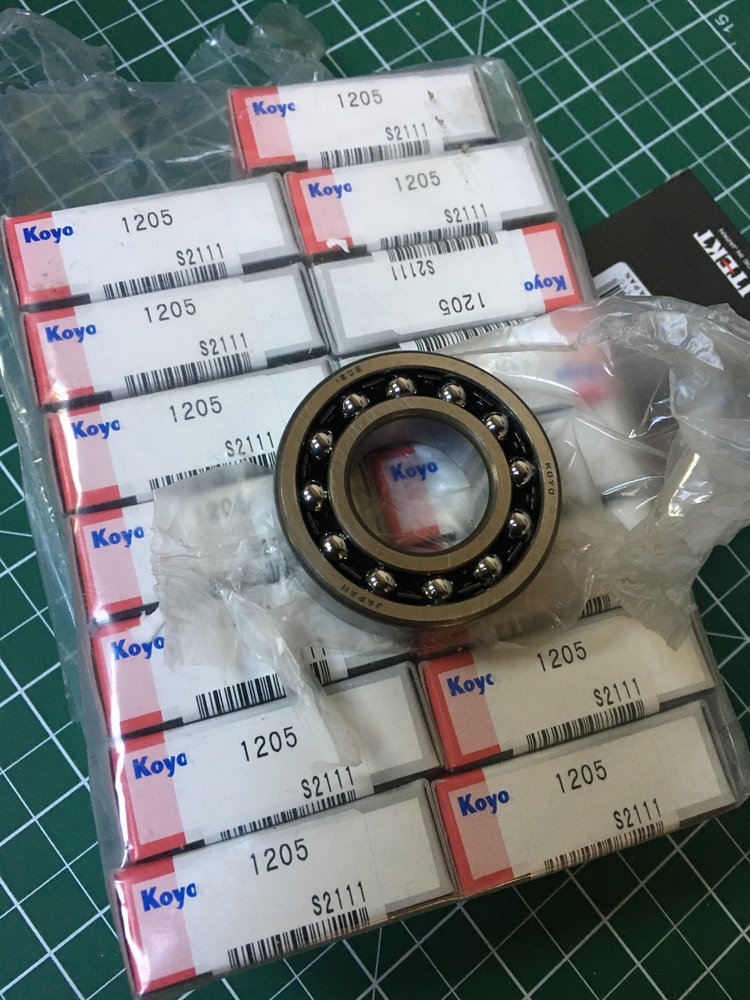

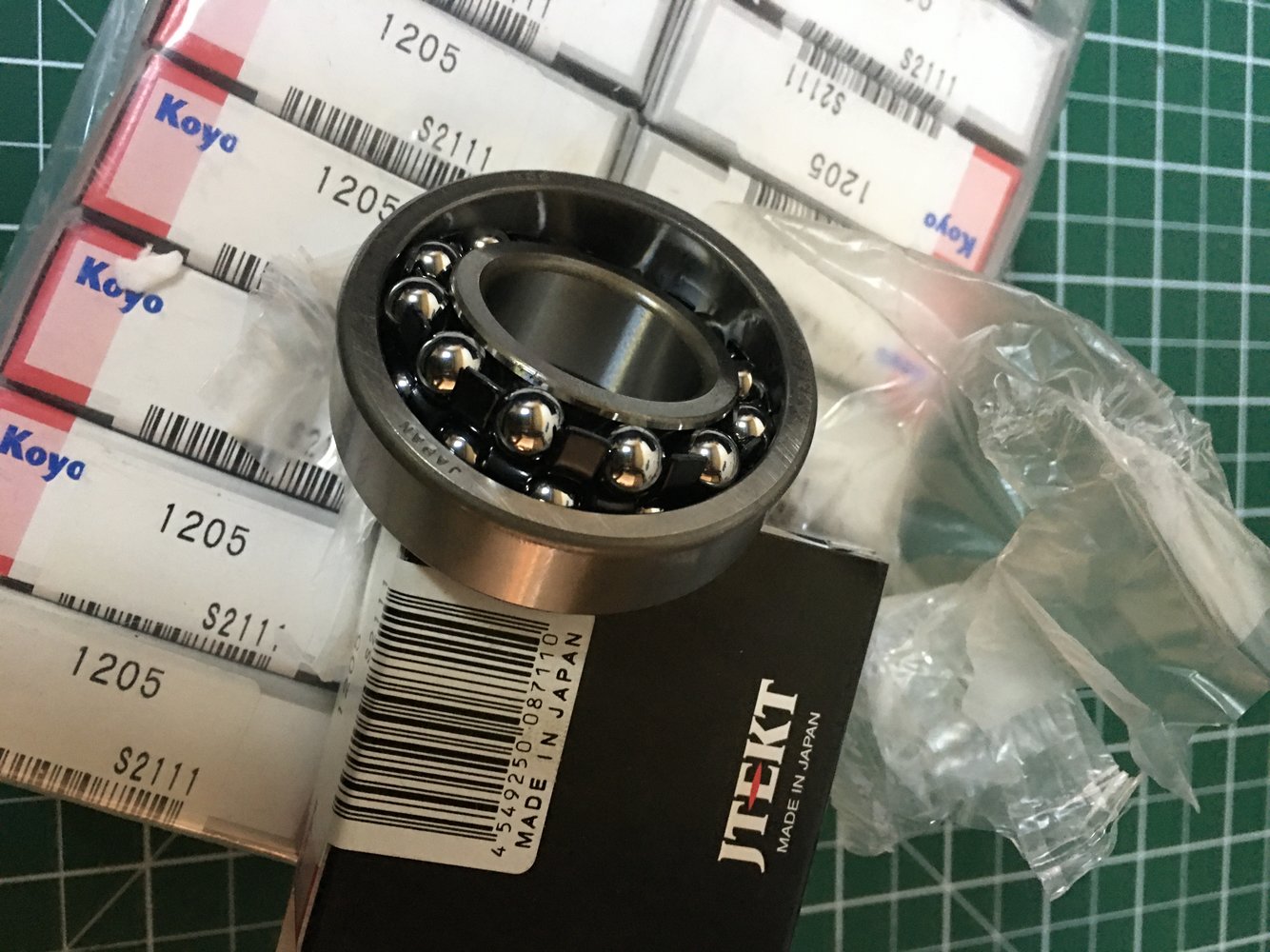

I should have used no name single row as rpmand load are low but I couldn’t do it so I’m using double row self aligning bearings incase the frame stress releases which is very very unlikely and if it did only a few thou
View attachment 367145 View attachment 367146
we could share a pallet for delivery.I feel the need to have one even though I don't have the foggiest idea how to use one, things of beauty

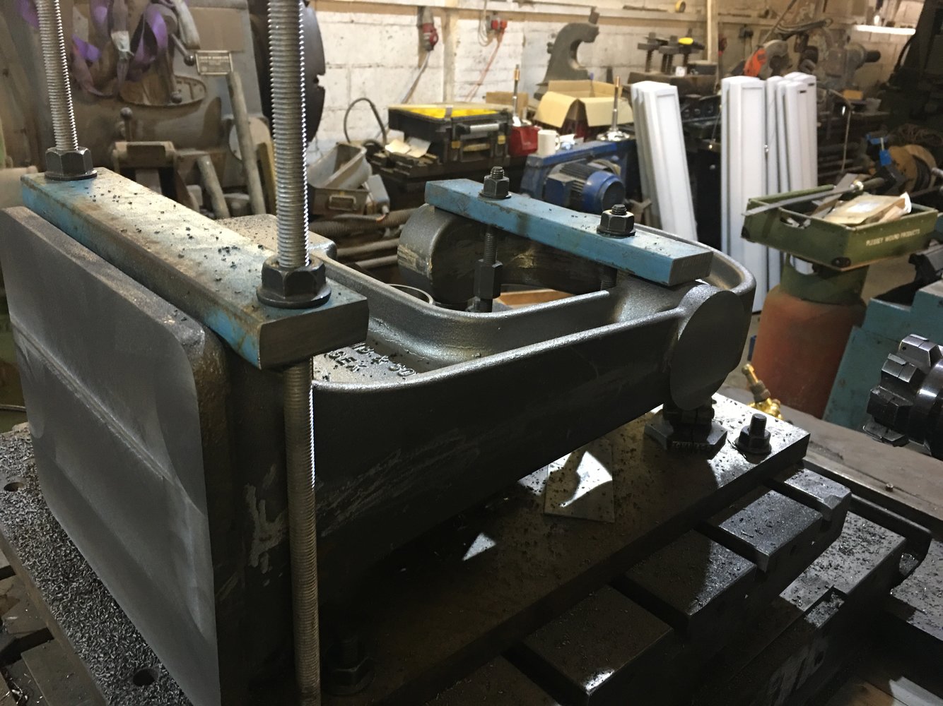

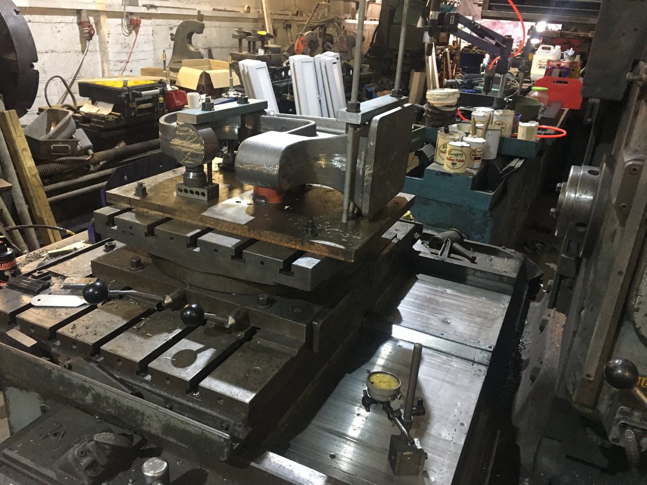

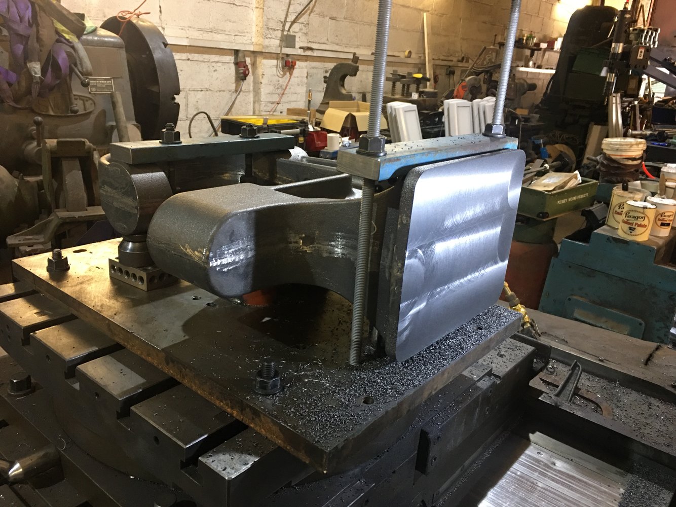

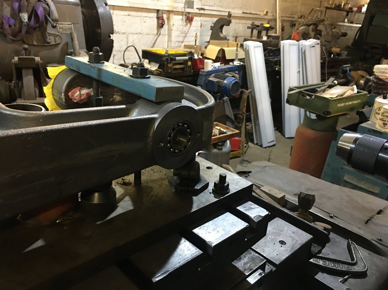

Look at it as machining in quality ,,,There’s more machining operations in a mini wheel than a full size !

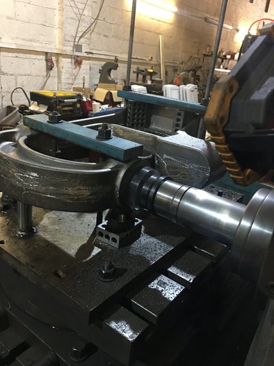

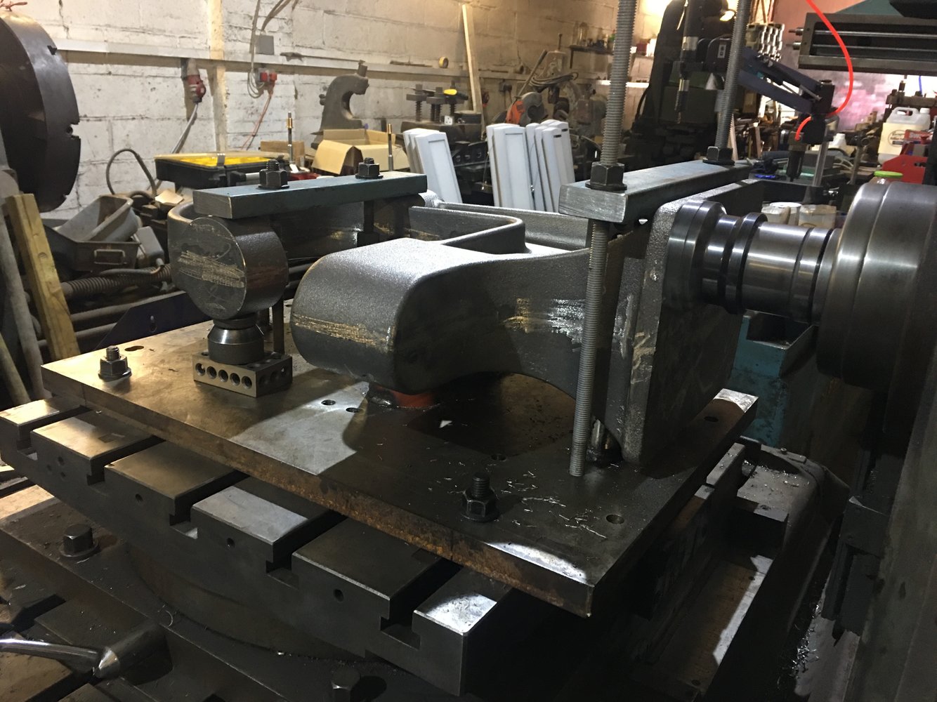

View attachment 367719 View attachment 367720 View attachment 367721 View attachment 367722 View attachment 367723 View attachment 367724 View attachment 367725

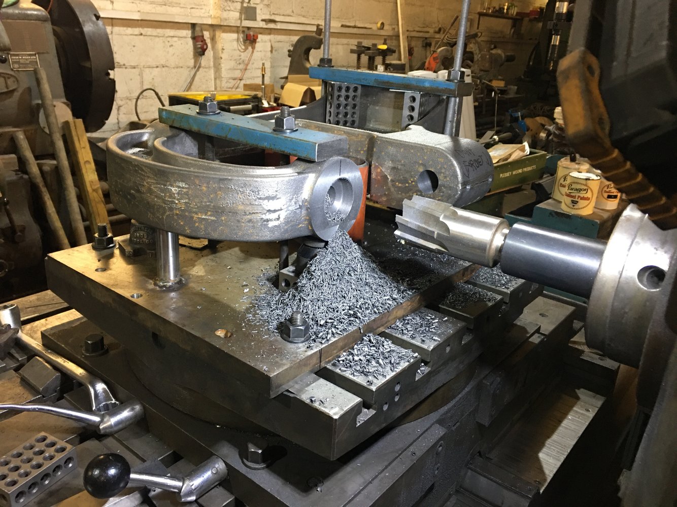

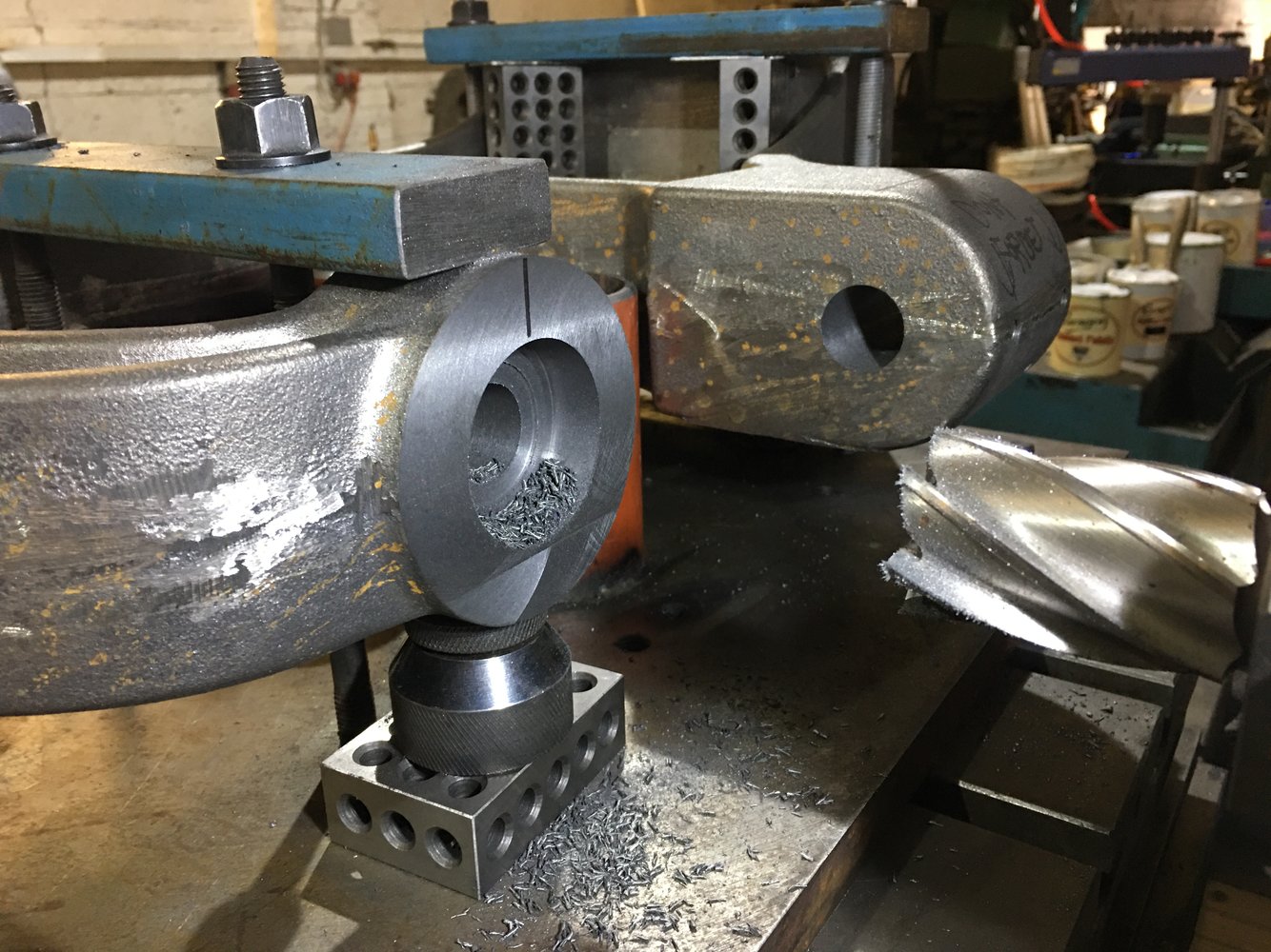

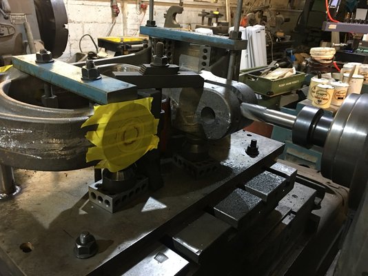

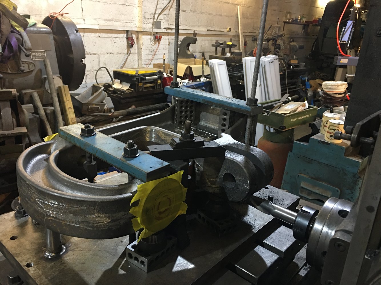

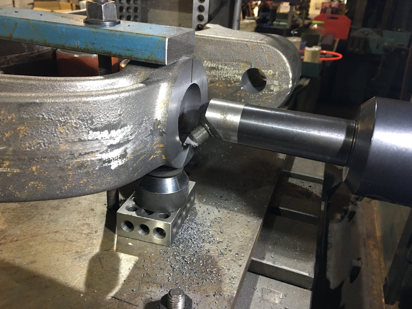

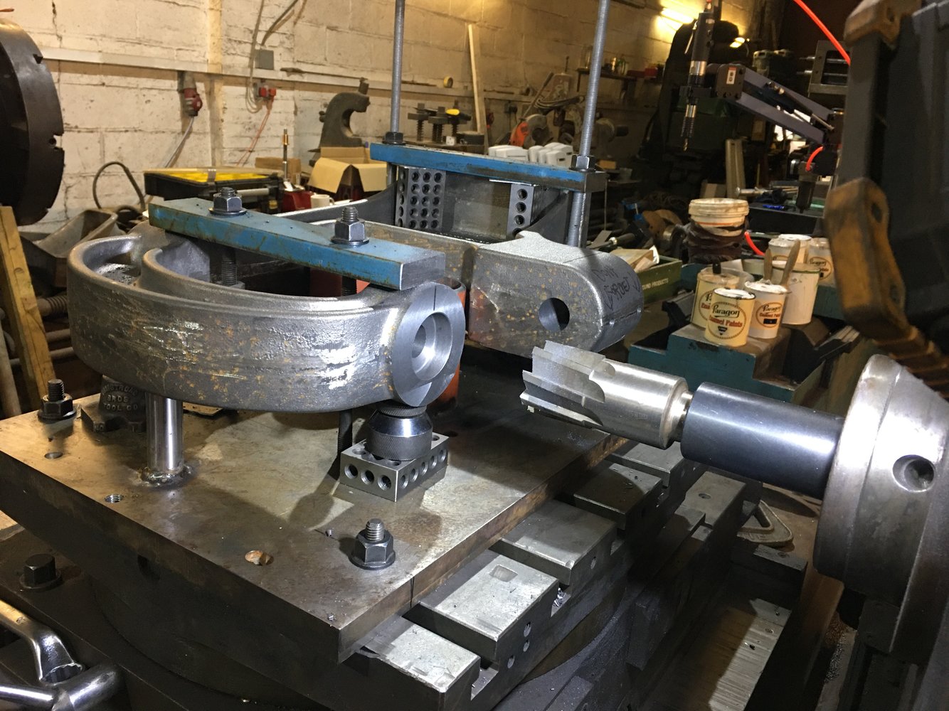

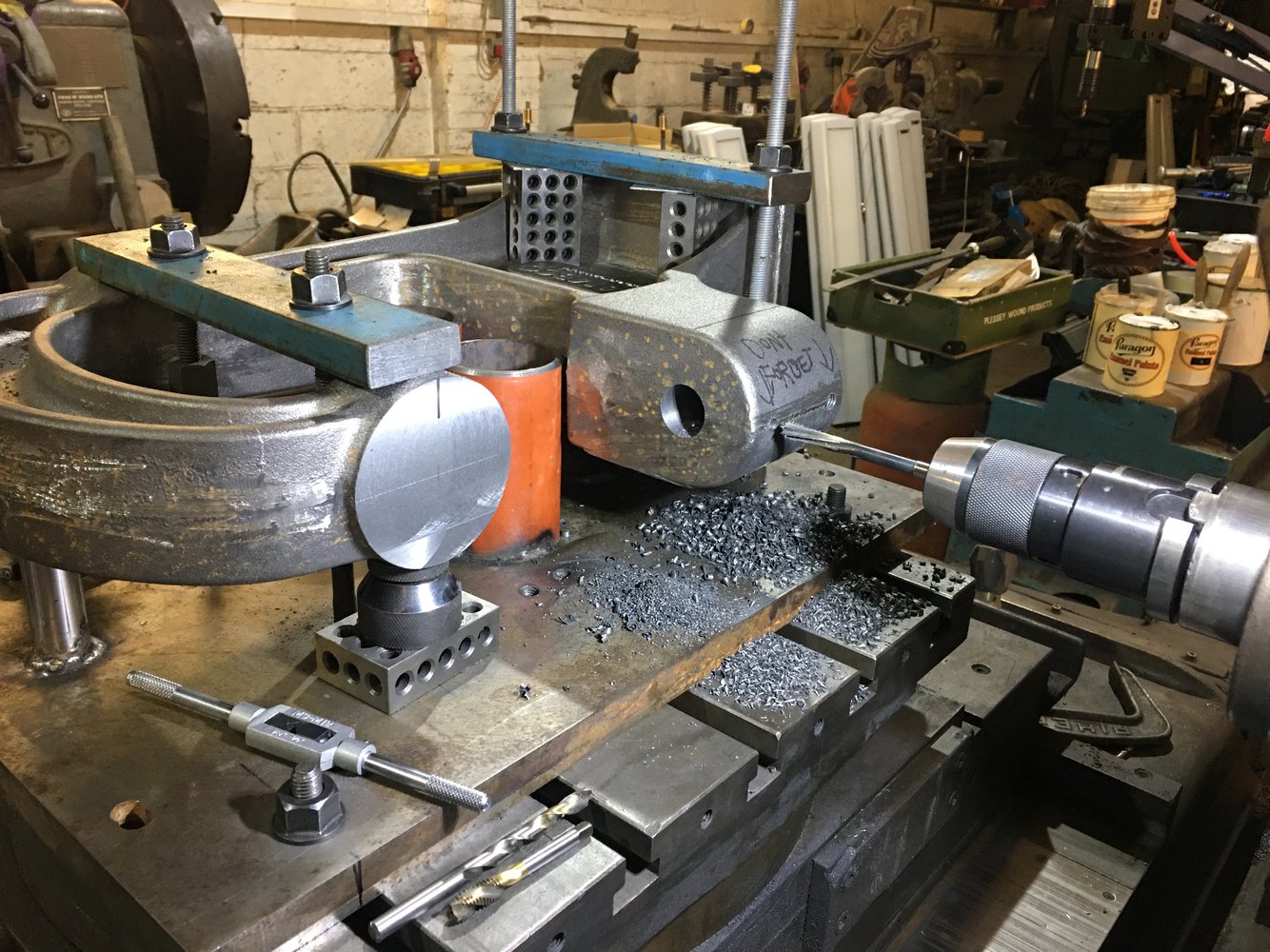

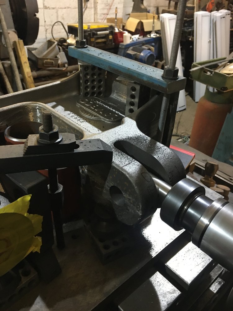

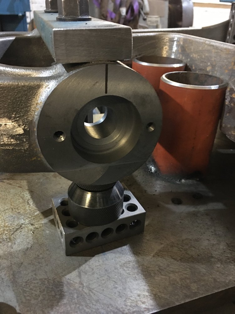

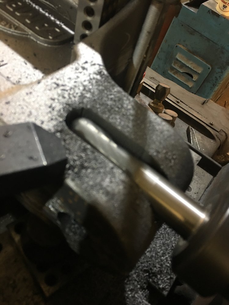

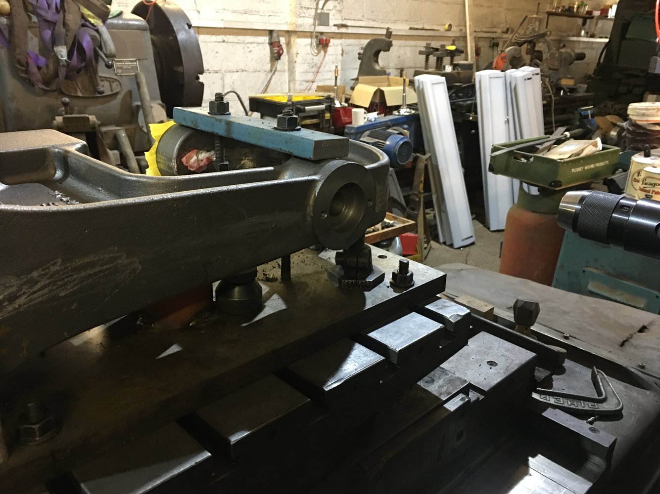

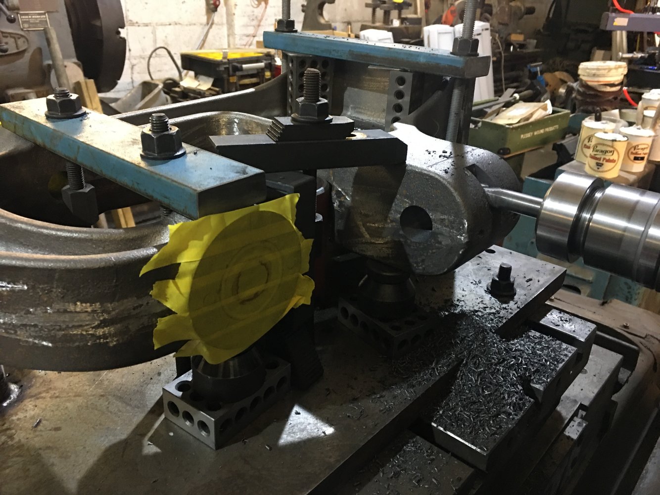

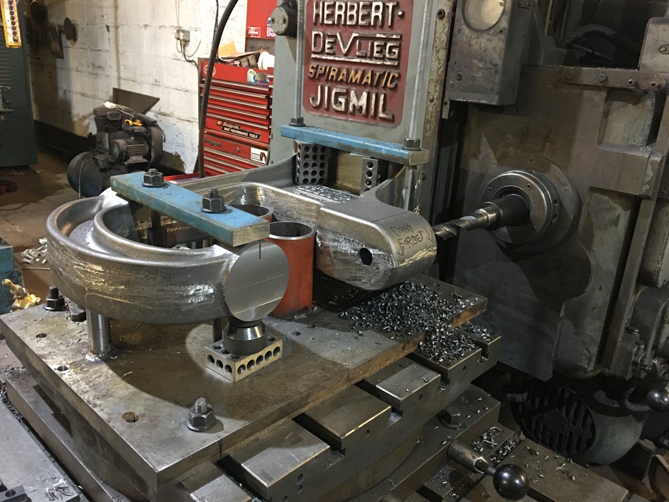

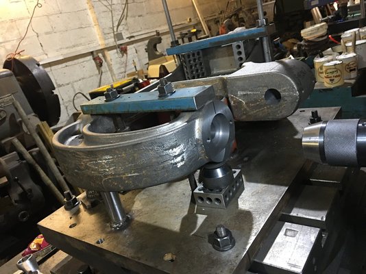

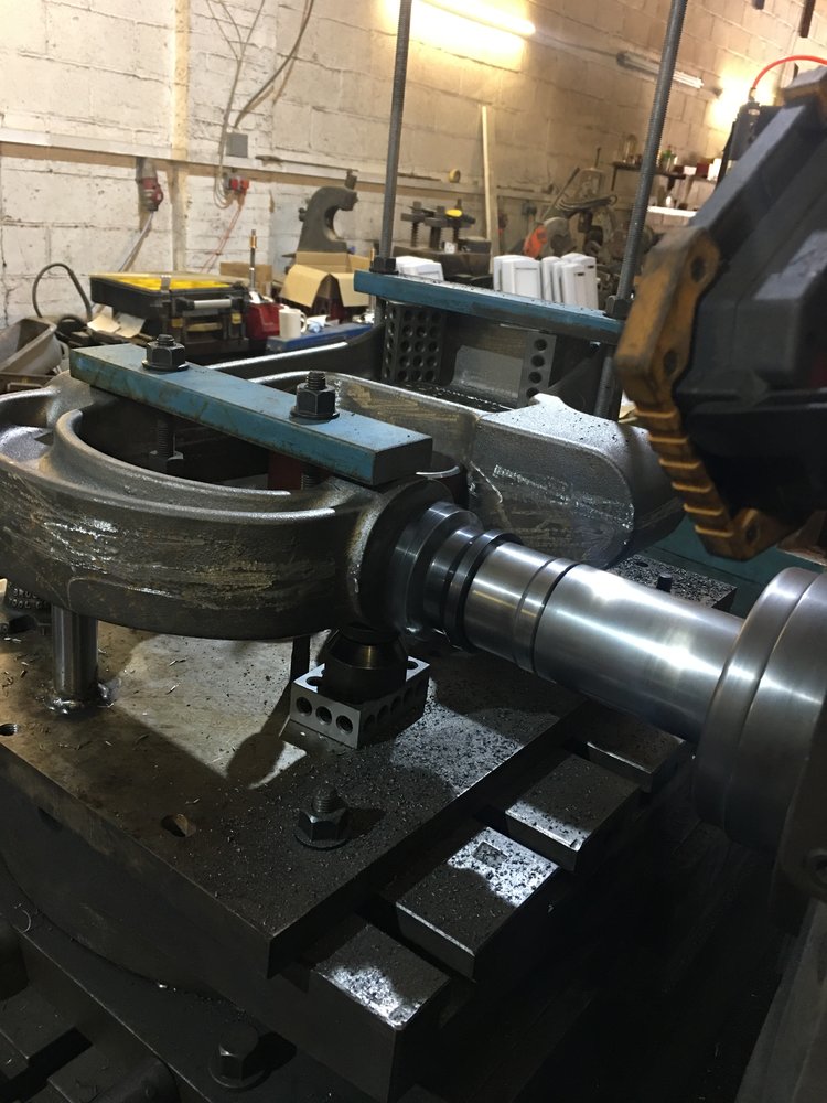

Thats spectacular.Using a brand new newall reamer to core bearing pocket
View attachment 367825 View attachment 367826 View attachment 367827
And brave, the slightest ding in the taper and you’d have an oversize there - did you do a test hole first?Thats spectacular.
It’s a Devlieg sonAnd brave, the slightest ding in the taper and you’d have an oversize there - did you do a test hole first?
Lol, Clive called me “son”. And then agreed with me, sort of.It’s a Devlieg son
Anyway it was just a hog out before final cut with micro bore
