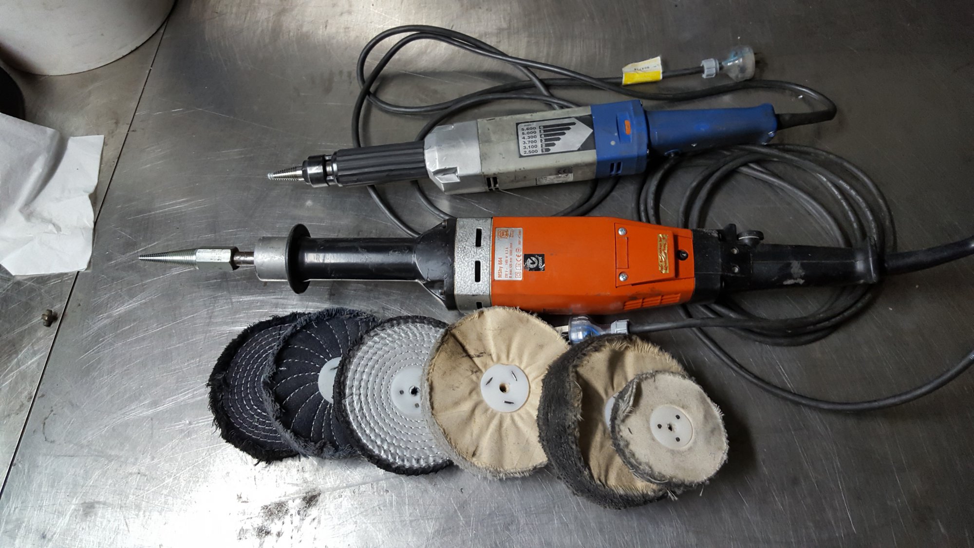

View attachment 92385 Good morning The Z'eer.
Here is a pic of my toys.
The top one is from Pferd and is specifically made for polishing, is variable speed lighter and used primarily with soaps for cut and polish.
The orange one is Fien and is basically a straight grinder and not variable speed. I use it for bigger roughing jobs as it is much heavier and got much more grunt.The only problem is that you cannot hang onto to if for long. The other use is on sisal mops 'the cream floppy ones' to polish off the residue from the polishing process ' the compound'
Neither of these a cheap items, then there is the consumables and accessories, the list goes on![]()
