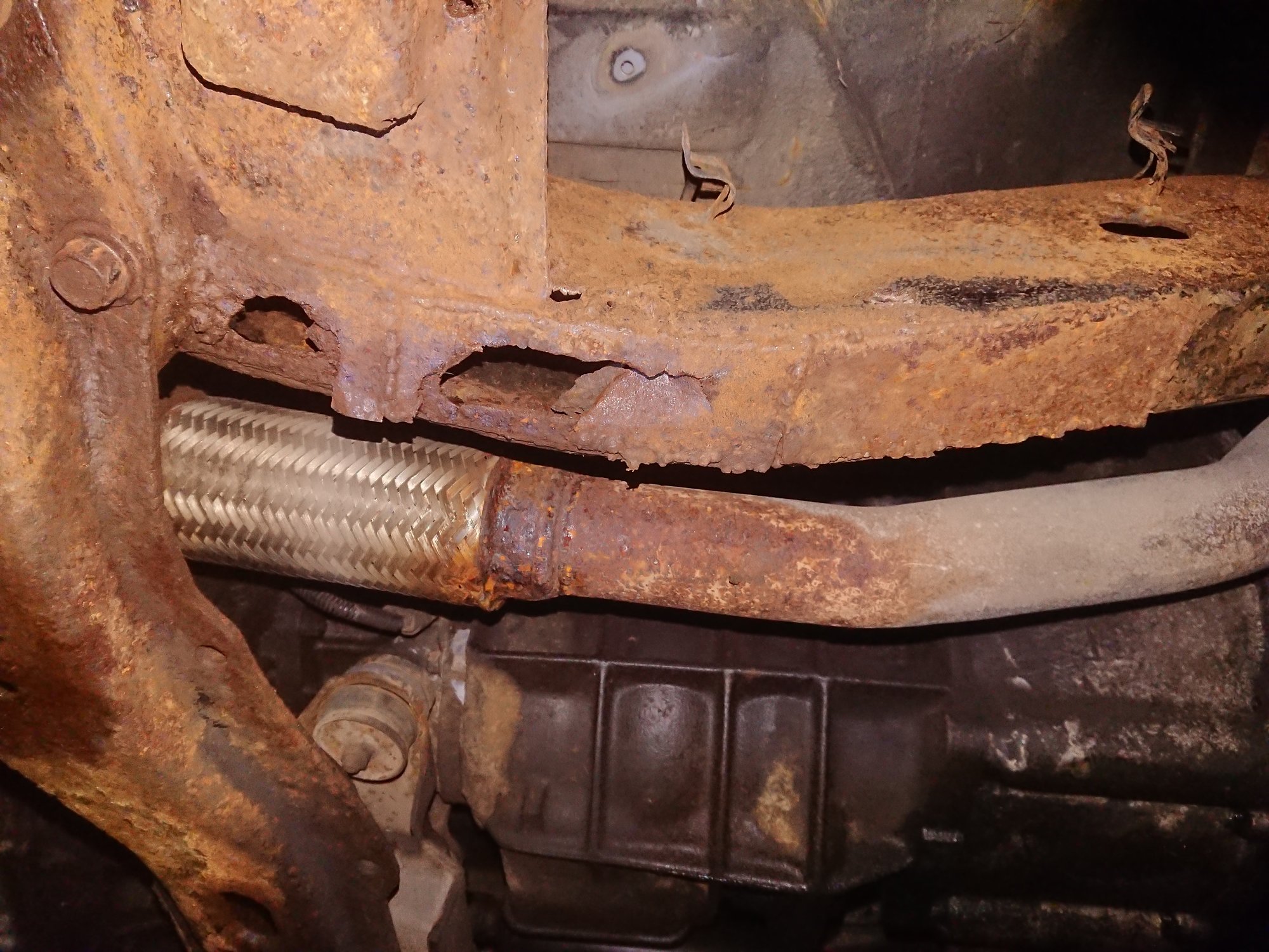

Might be worth a chat with your local MOT man so you know exactly what he wants so it will pass.Thanks. Yes I would have seam welded it anyway. It's one of those jobs where the aim is to make it last another 3 years as he got a loan to buy it.
I would be using 3mm if it was a land rover chassis
It's Mitsi anyway, where did Waxoyl come into it ?where did Waxoyl come into it

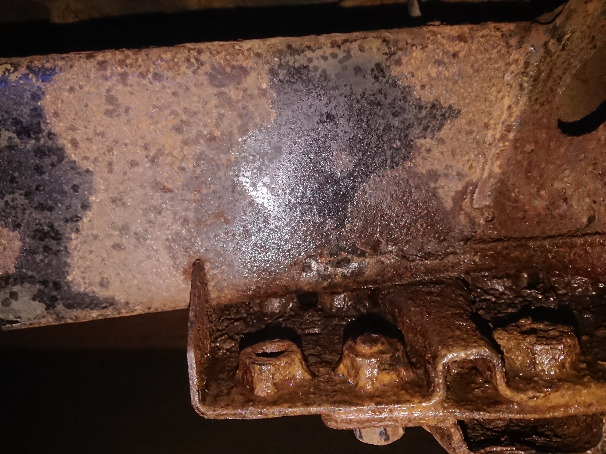

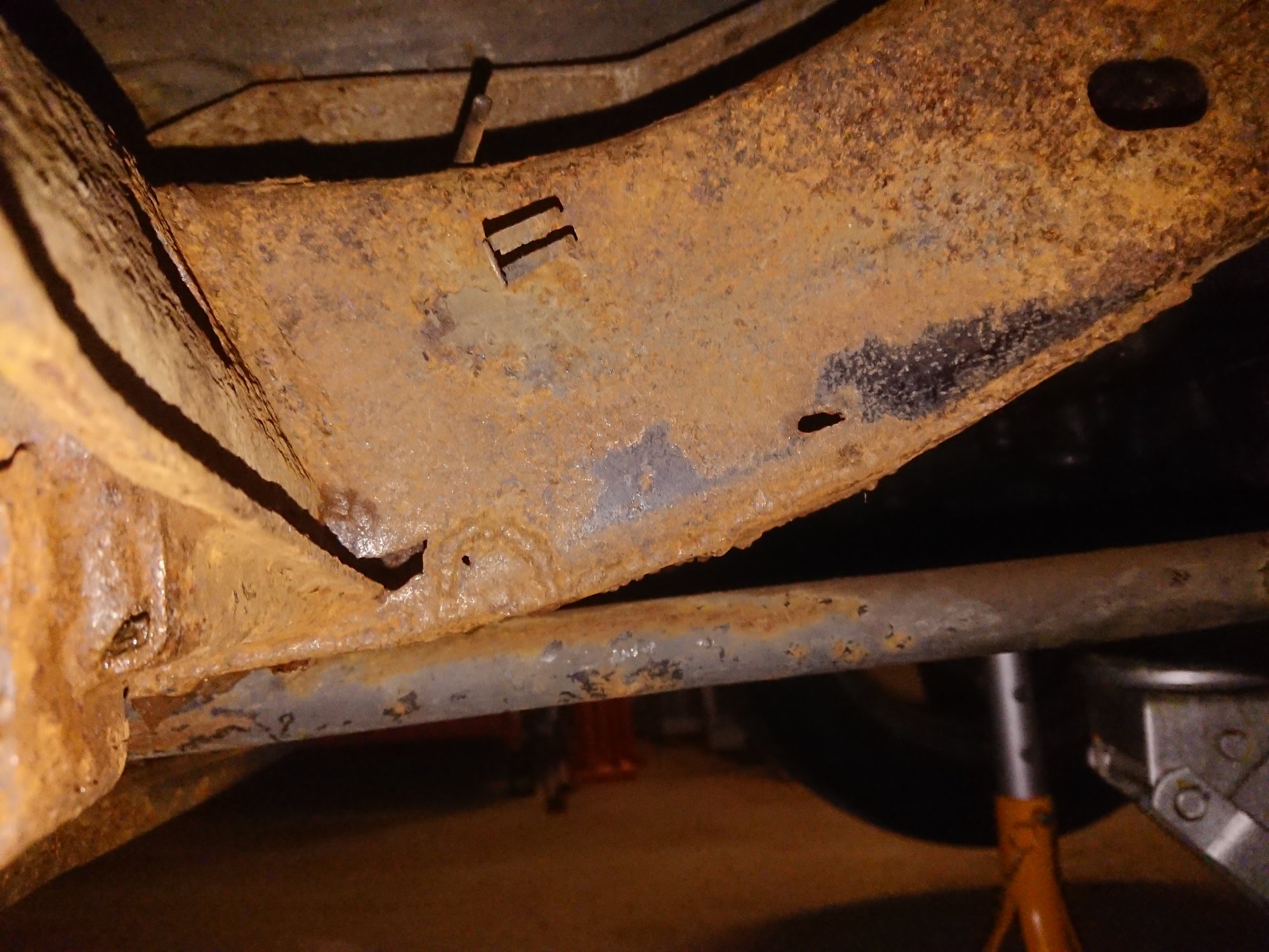

You'll still need to find good steel to weld to,needleing the front wont tell you whats behindThose patches are basically tin so I'm not surprised they rotted out again. I've needle gunned that whole area so I think I have found all the holes.
Thats been patched before,if its gone again then its double the trouble
