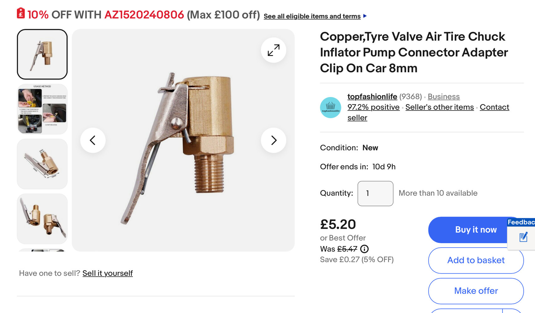

An ordinary tyre pump adaptor has to be held on and sometimes manipulated on the tyre nipple is there an adaptor which can be left on and is short?

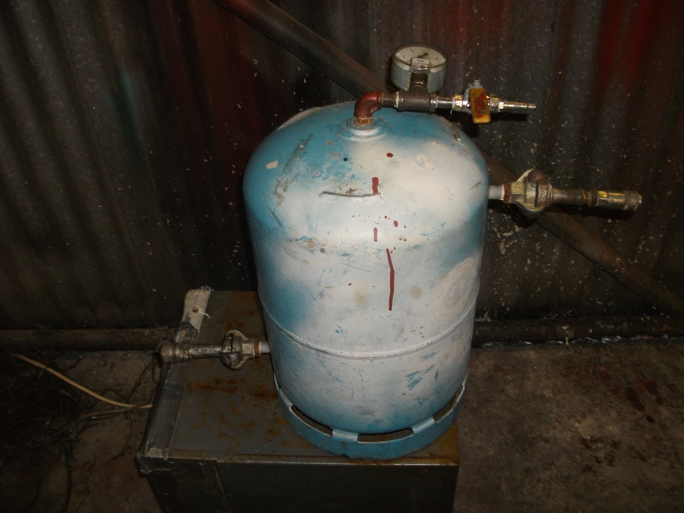

I use an old 35kg gas cylinder as a portable tyre inflator, pumped up to 120psi there is enough wind in them to put 30psi into a telehandler tyre, takes seconds vs the 12v air pumps which take a few minutes.
