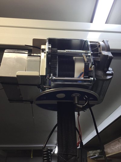

Fitted a 200kg mobility hoist in the workshop at the weekend, this will allow me to pickup 200kg and put it anywhere in the workshop within 300mm of the walls. That includes picking up chucks, etc for the lathe a mills

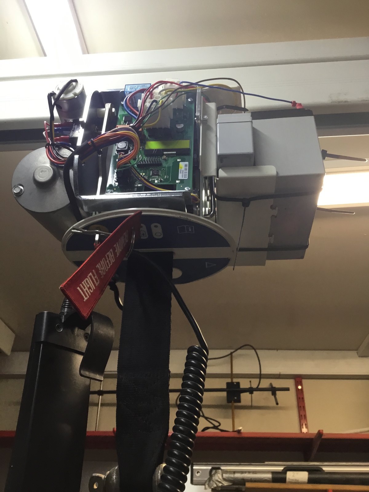

Runs off two 12v batteries working a 24v paravlux motor to a seatbelt type wheelchair hoist. With a small motor to give power on the cross axis. Once docked it charges and gies to sleep. Batteries where shot on this, but are only 22quid for the pair and should last a few yrs. gerry rigged two batteries to get it working.
Its got a pendant, for up/dwn. <>. and e-stop. LCD Screen states 2hrs 34mins run time.
It will never see max load. I have a B&T for that. Should make moving stuff about easier.

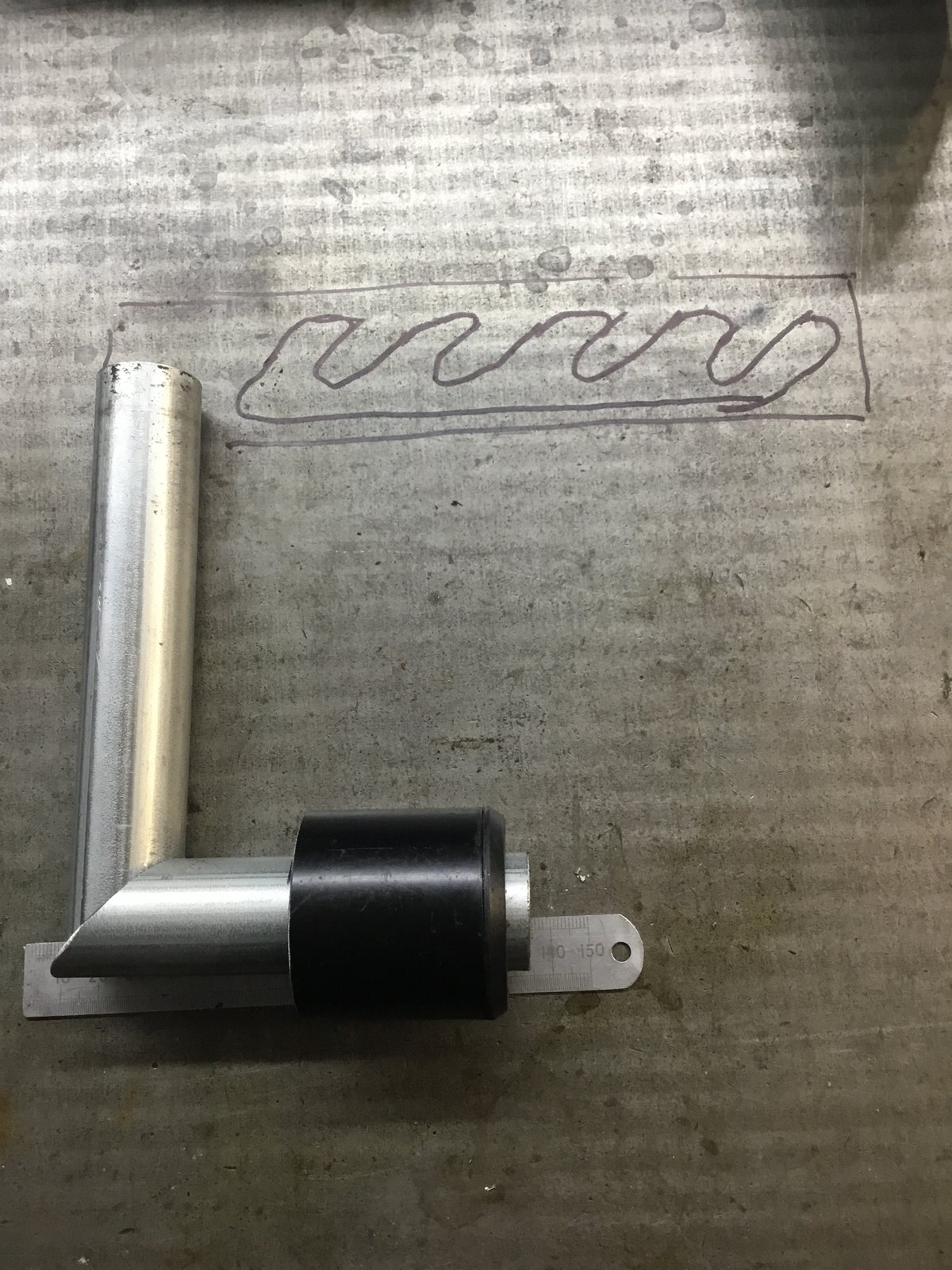

I need to make some hooks etc to pick chucks up.
