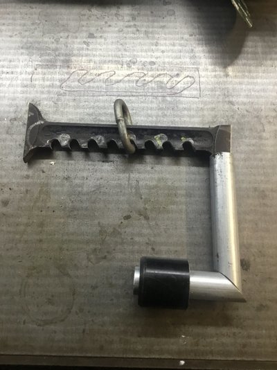

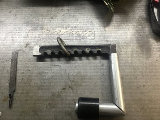

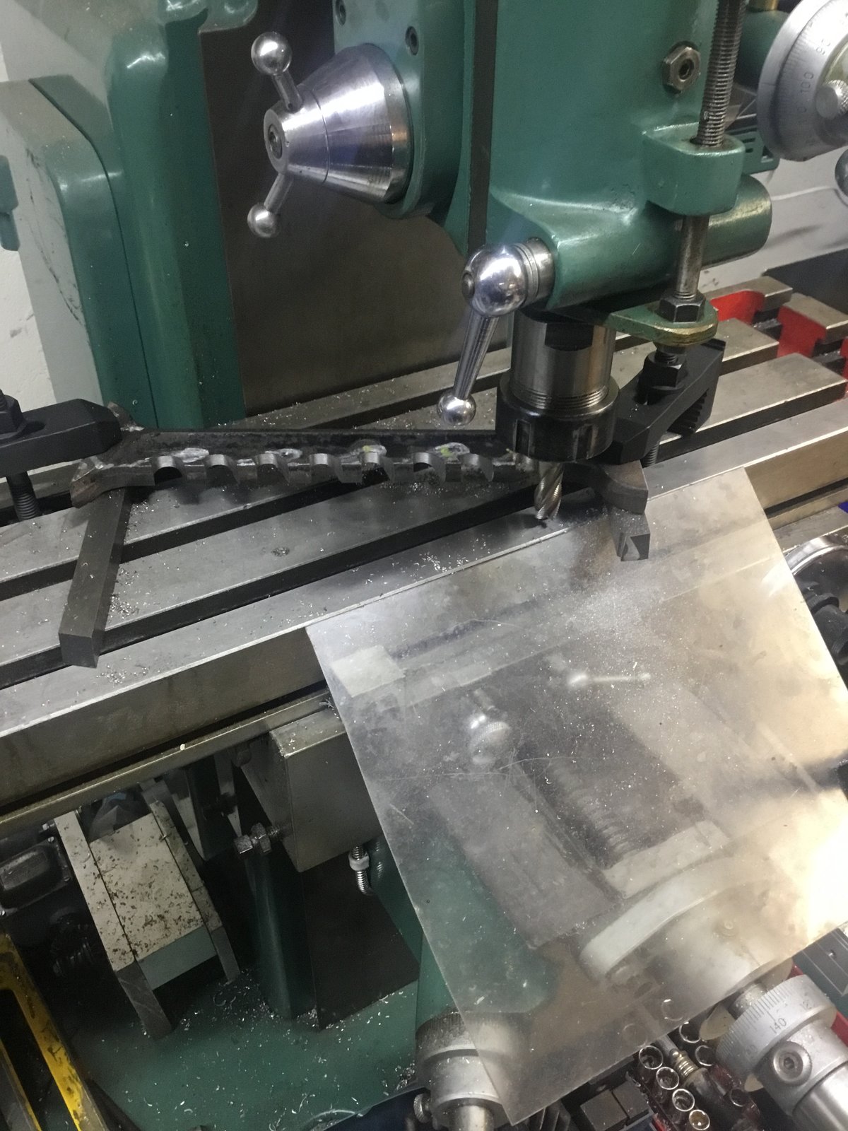

So my son cleaned this up as I cant hold a grinder
Looks like 50amp DC with 968. (Who knows I wasn't there.)

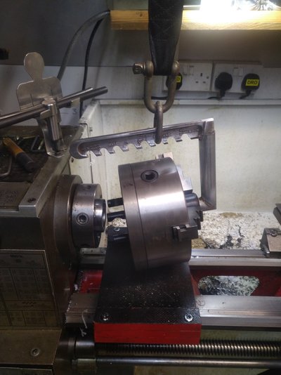

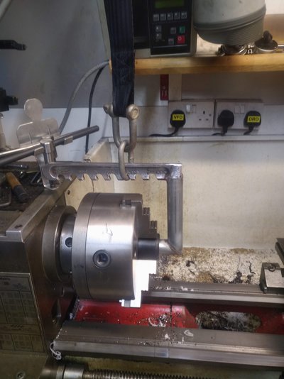

The upright Galv tube has been welded either side and at the rear, just enough to hold a chuck but not enough to try and pick the lathe up if the wrong button was pressed.
Held in the jaws, with the slack taken up.

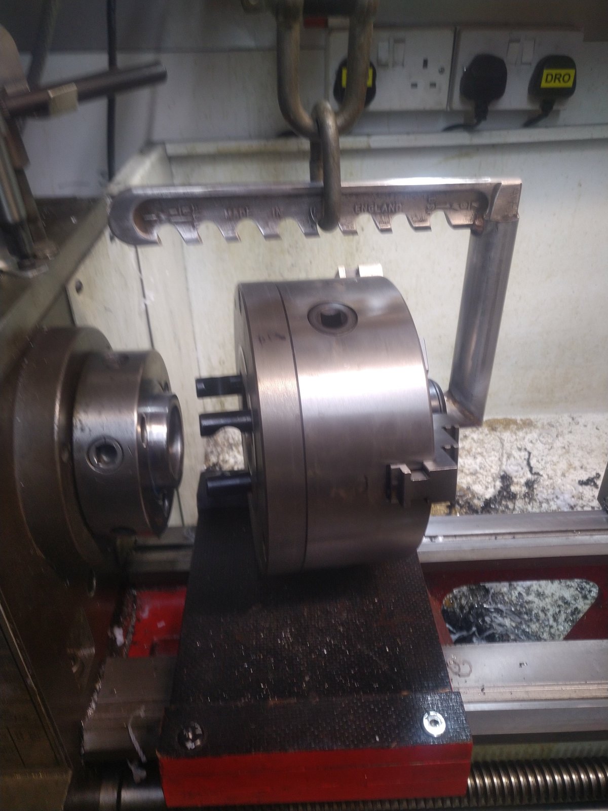

once loose, you could see it was out of balance.
Moved to the centre and bingo. Bang on

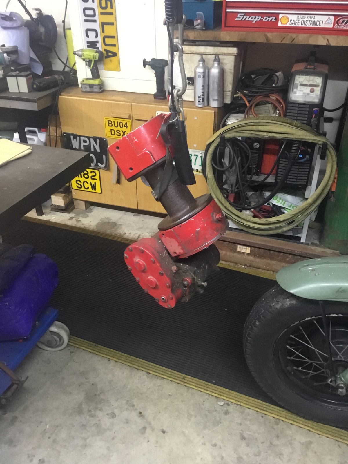

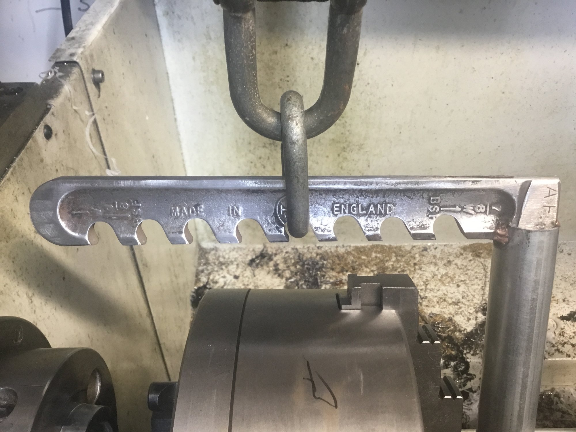

clean up and it been left as is.
I really like the ‘Made in England’ stamp
